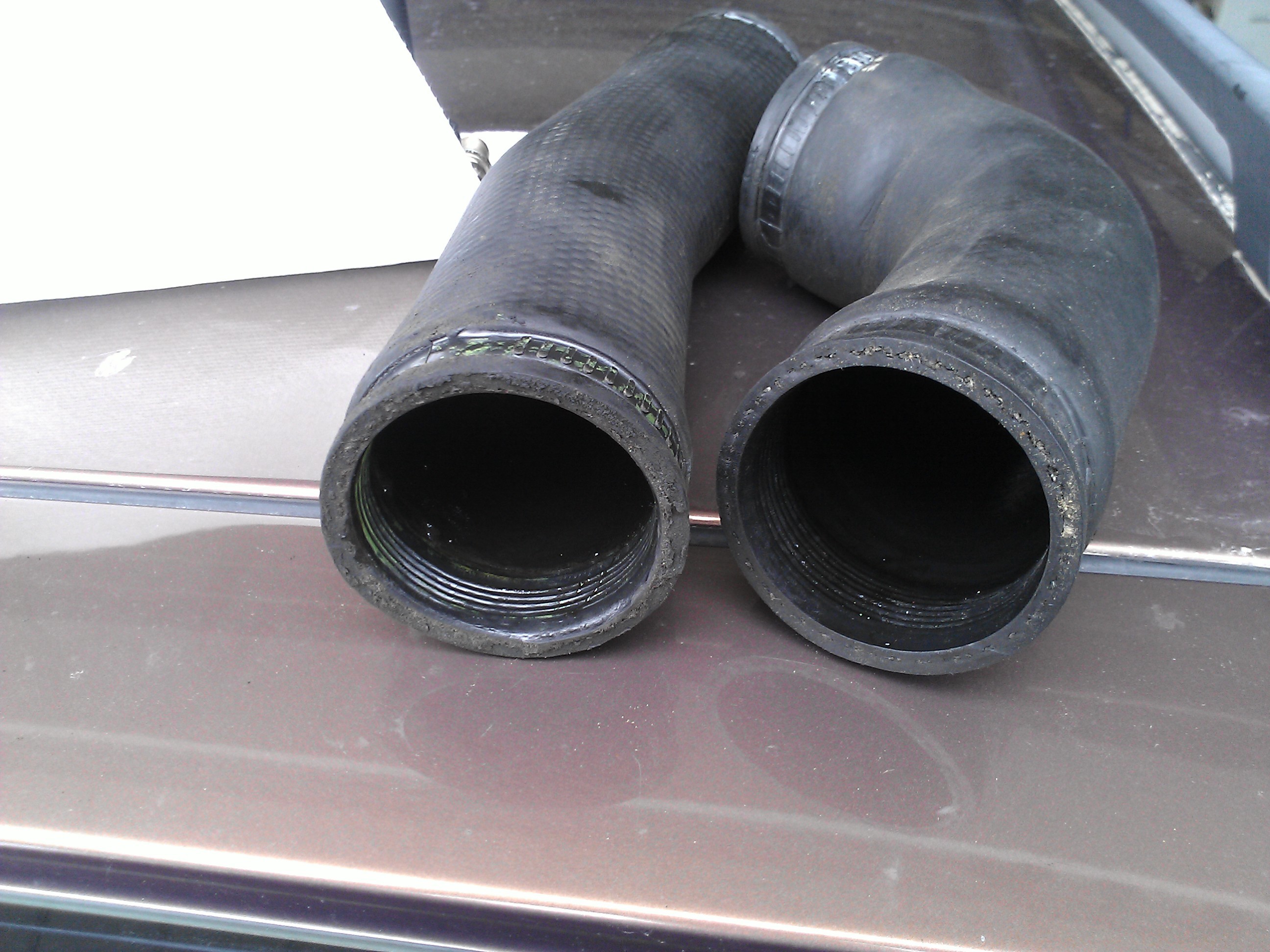

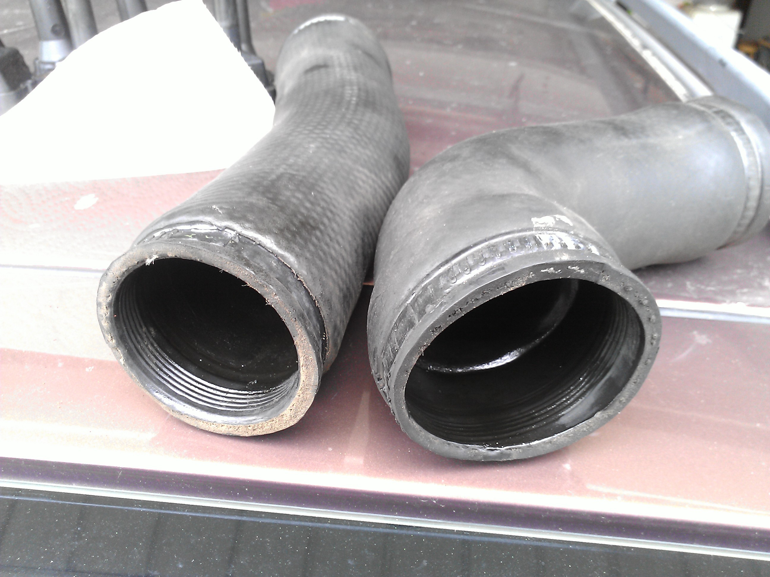

Ok, now that it's the weekend it's time pull things apart and look for problems. Since someone suggested I pull the Throttle Body and take a look at it, that's what I'm doing, plus pulling plugs and coils. I also pulled all Turbo hoses.
The Turbo hoses are flexible, but not too soft.

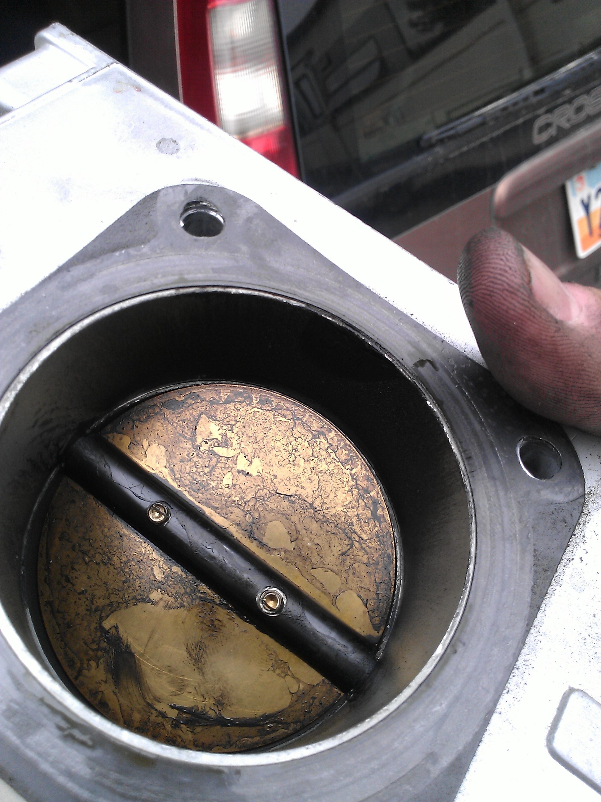

Here's the throttle body... it's a little dirty, but honestly I wouldn't think this would cause idle issues. the throat plate was easy to open and close. Went ahead and gave it a good cleaning since it's off the intake manifold.

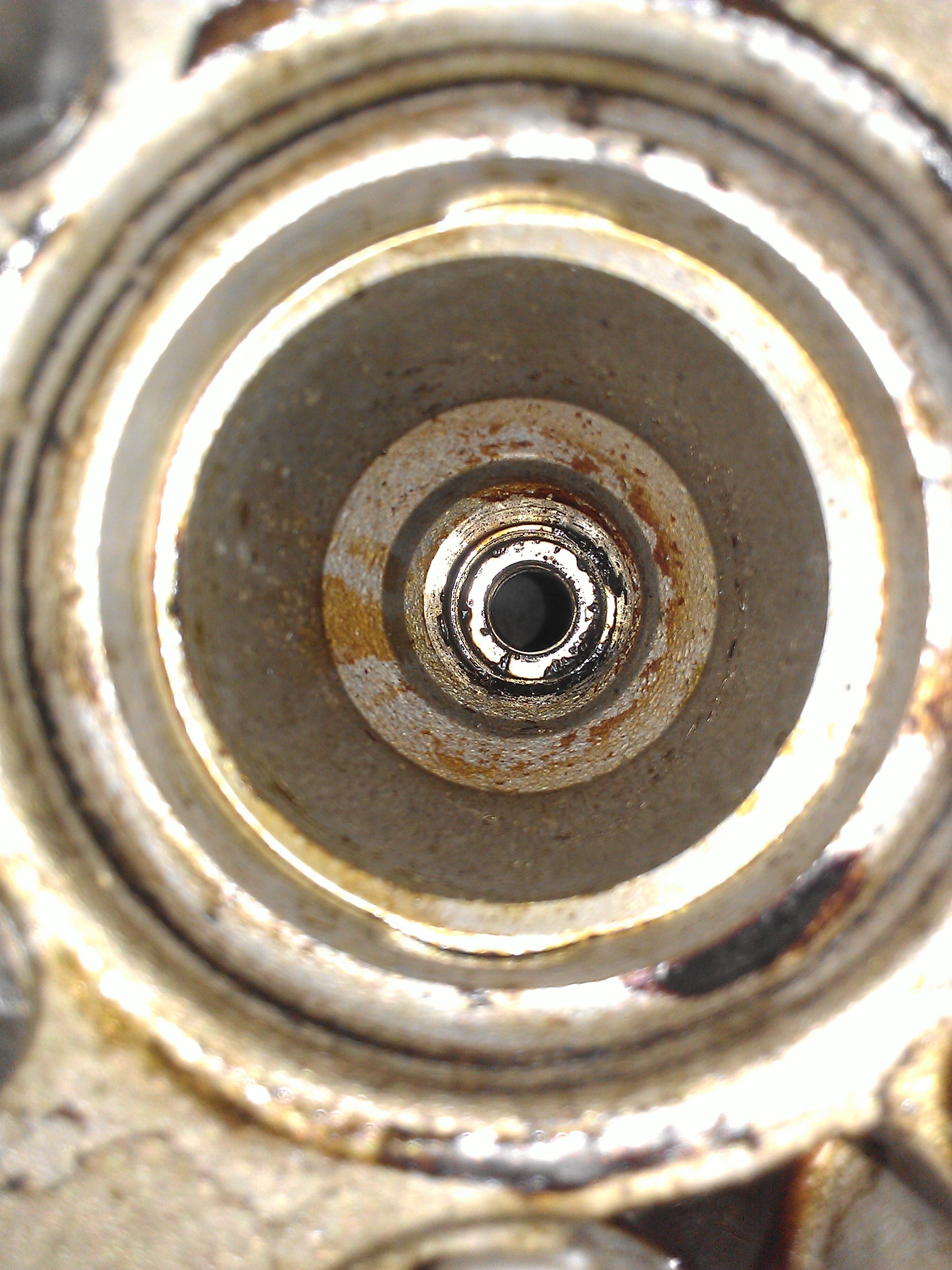

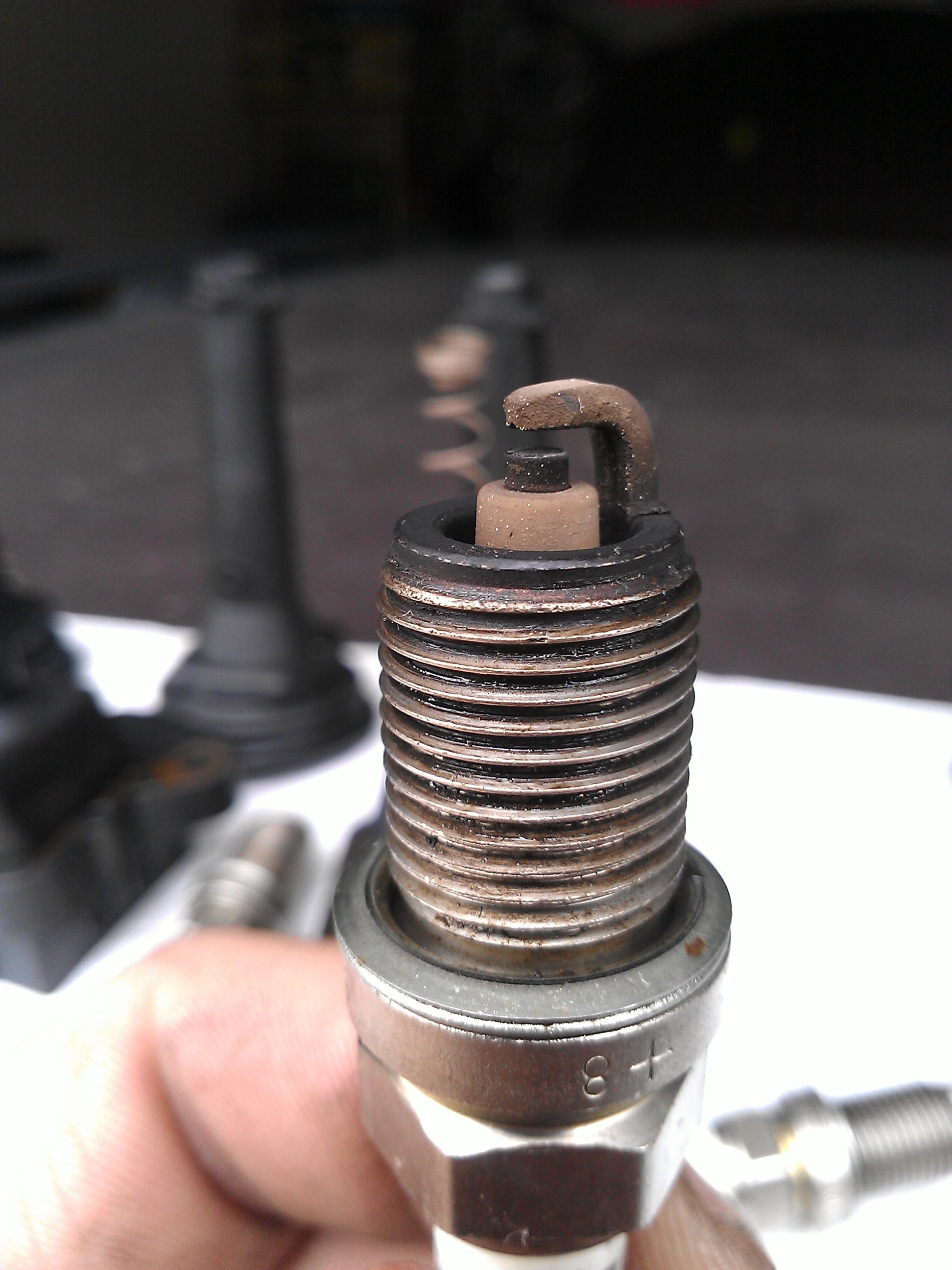

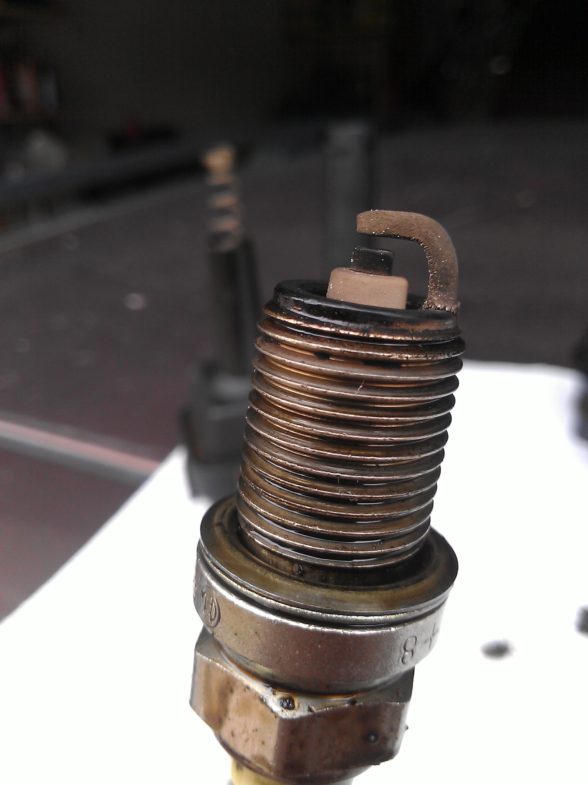

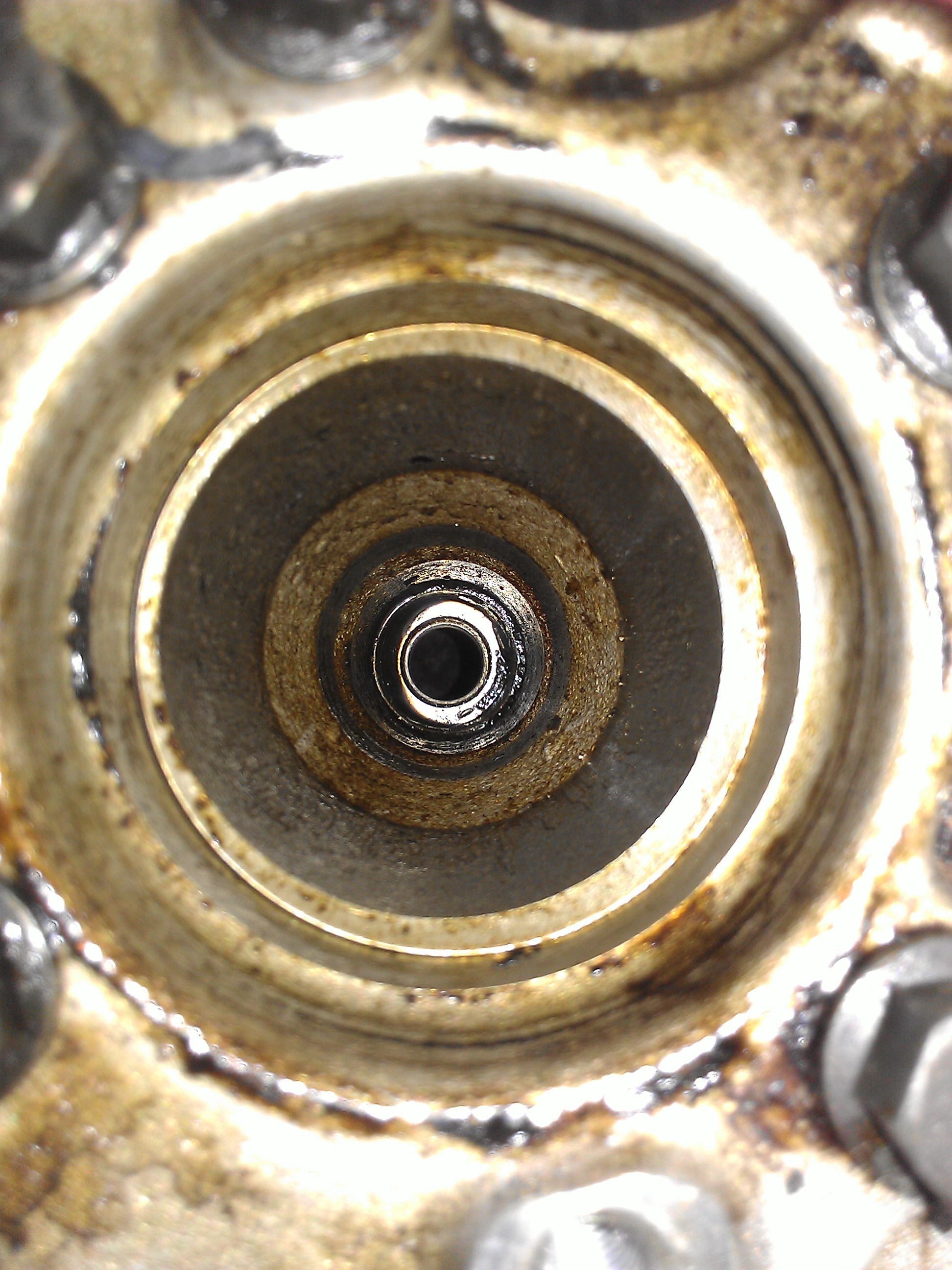

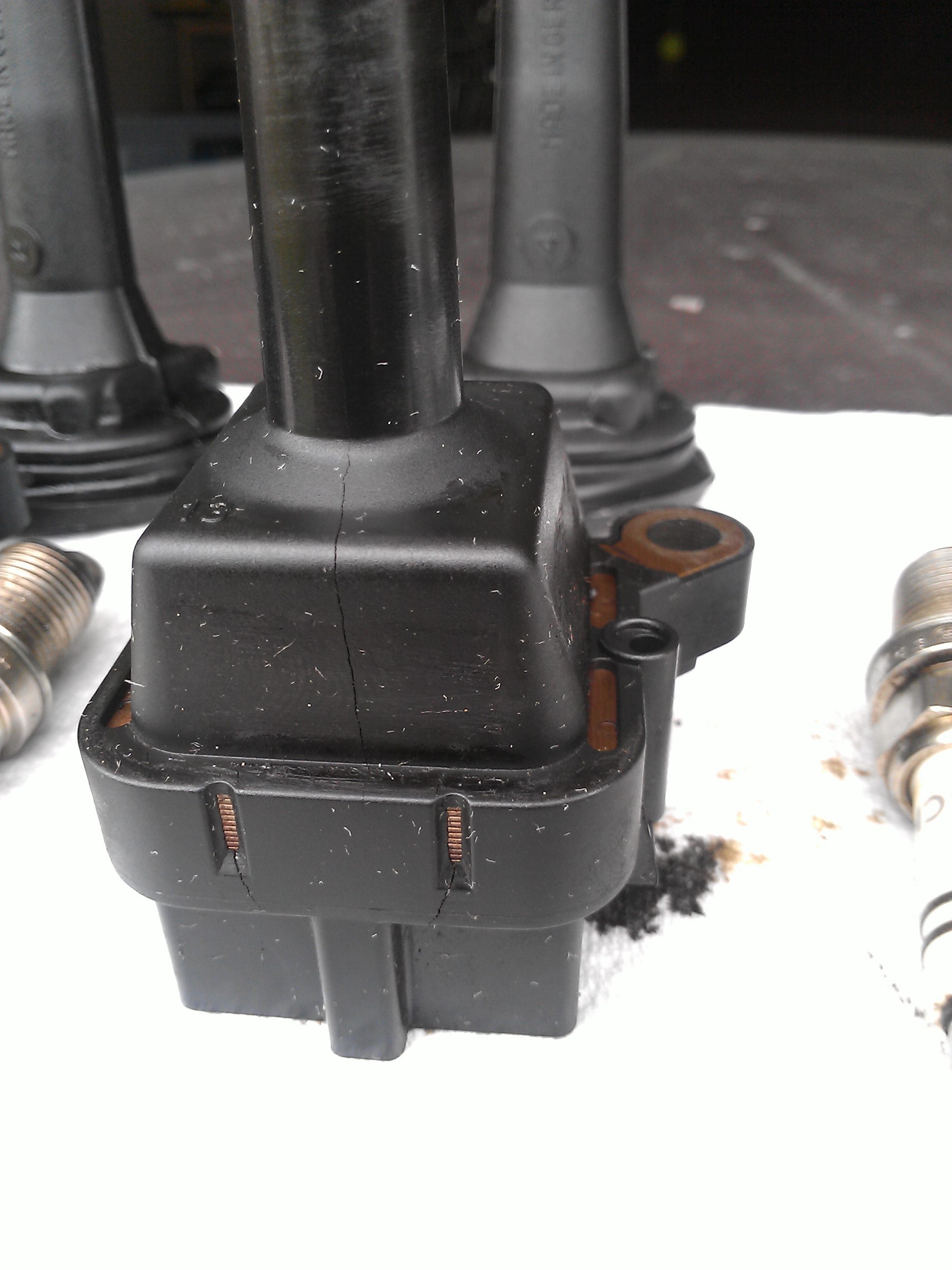

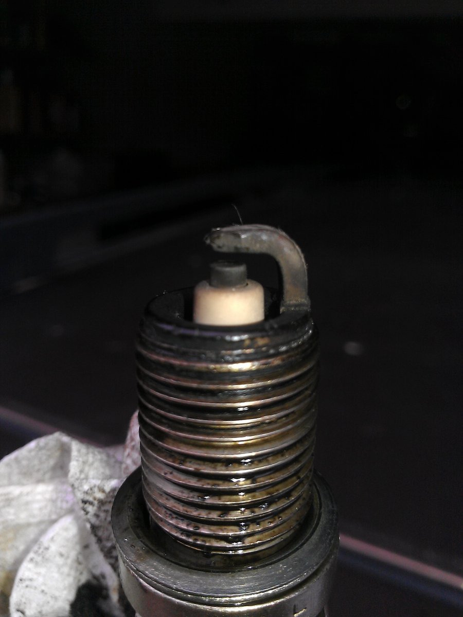

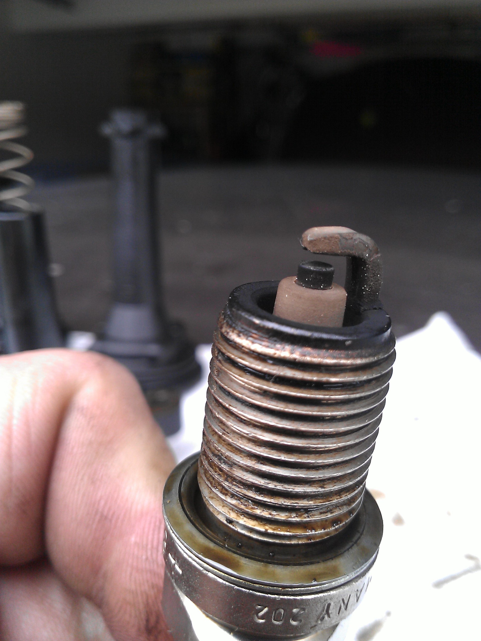

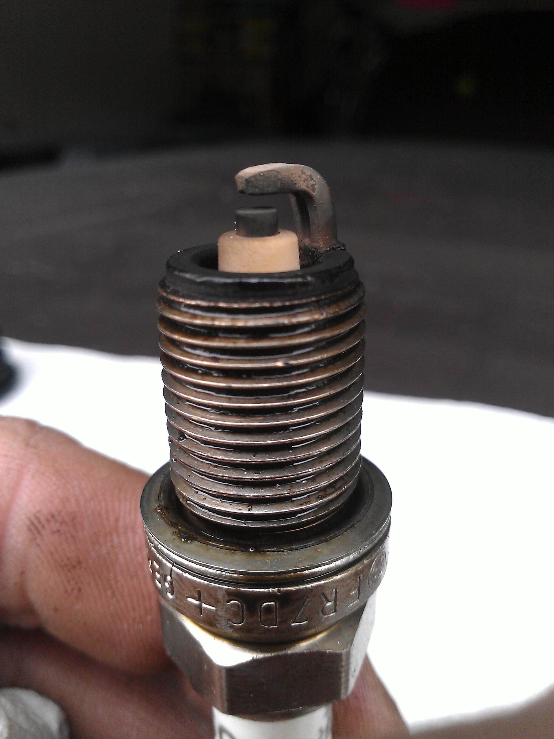

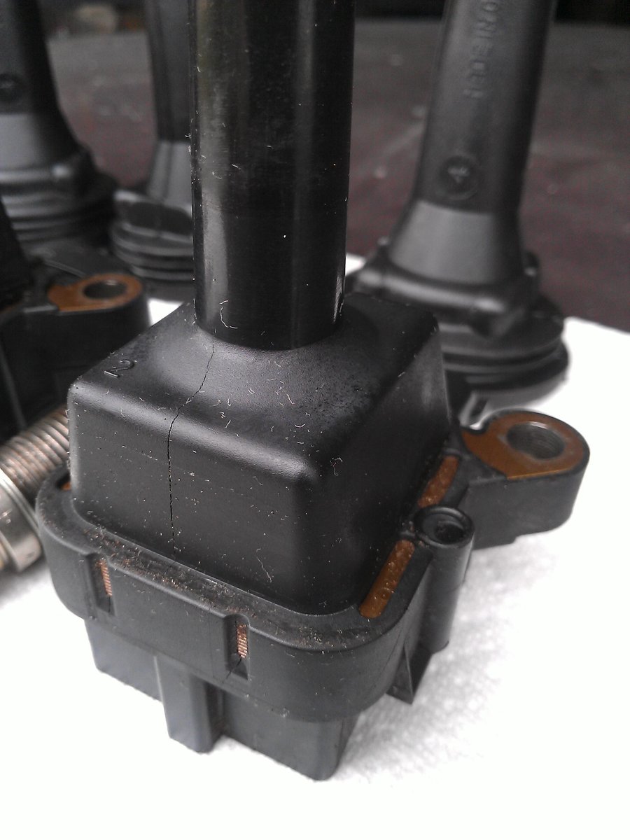

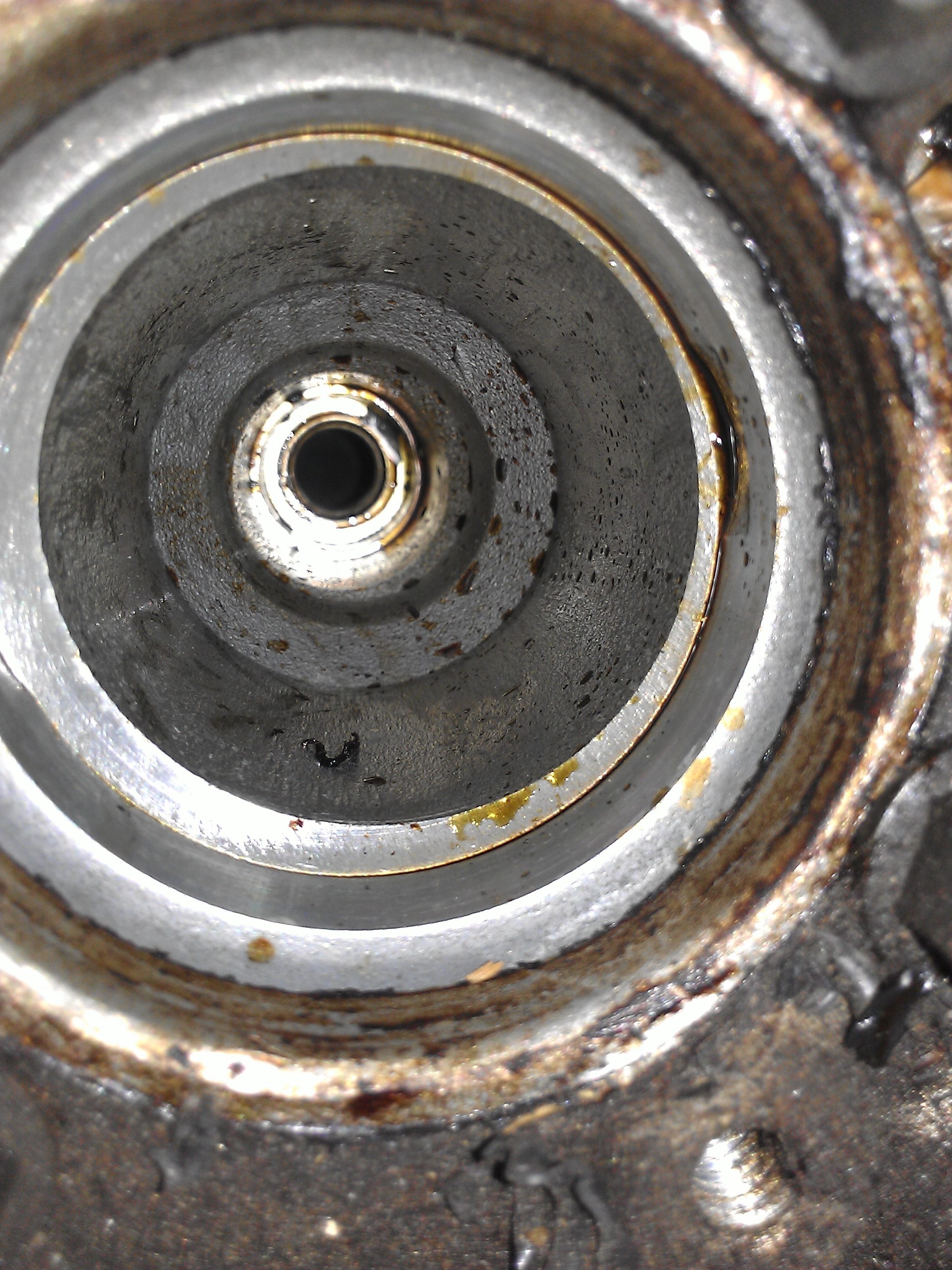

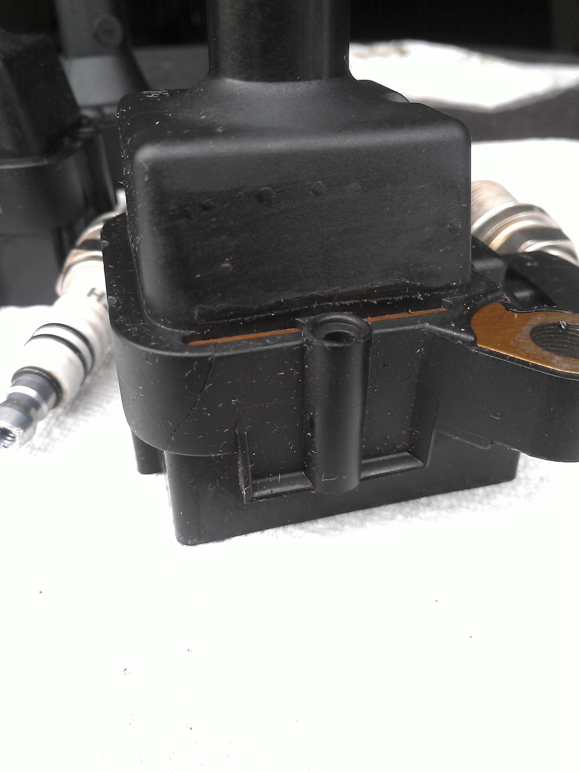

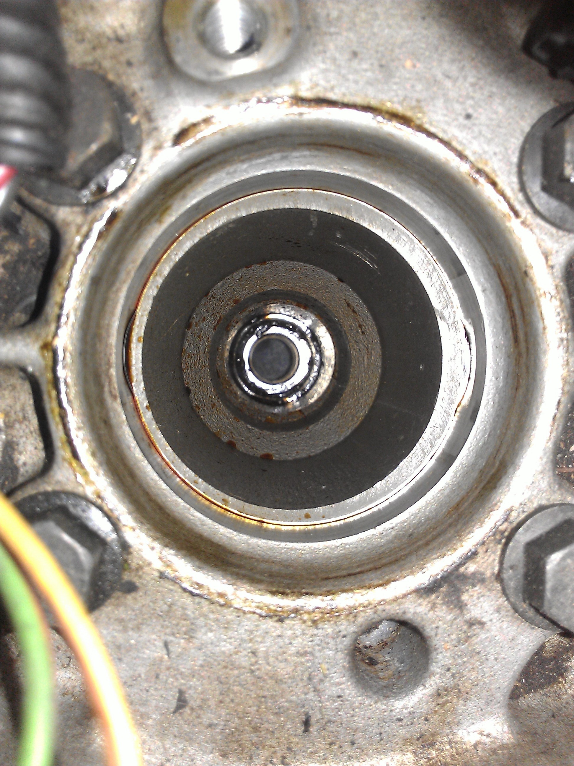

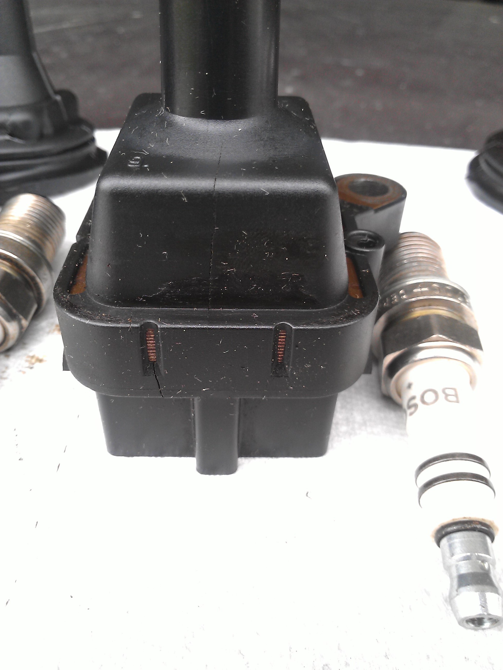

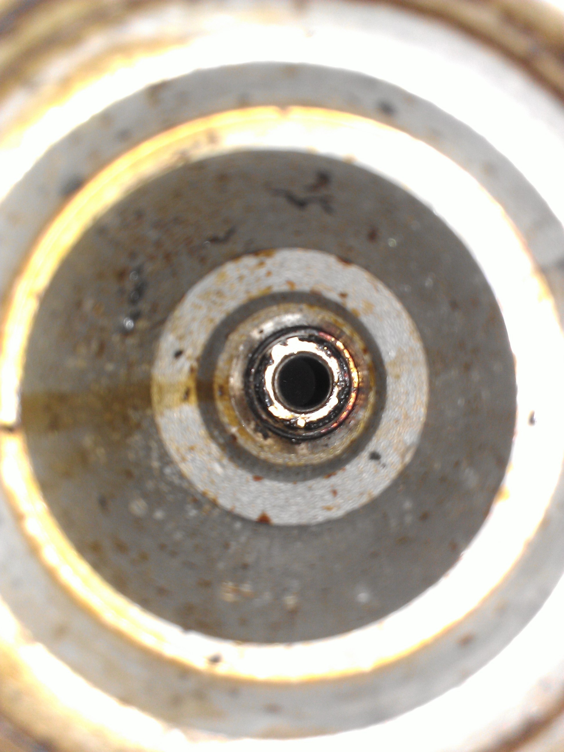

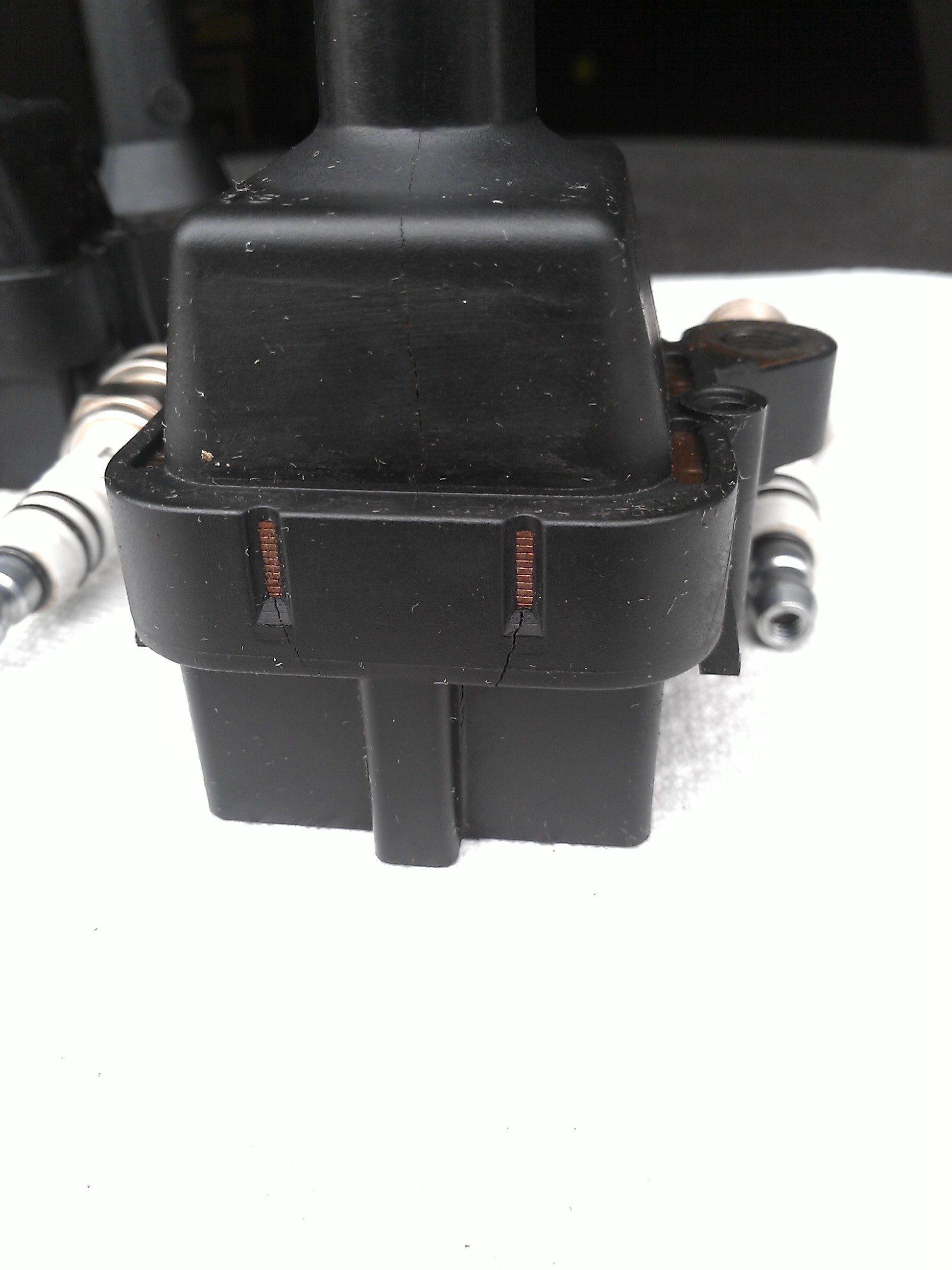

Next I pulled the 5 coil packs and plugs, starting from passenger side going to driver's side. I also took pictures down each cylinder. As you can see in the pictures the coil packs have hairline cracks in their bodies... some are more than others. The boot on coil pack 1 has a tear near the collar.
Would those cracks be enough to be causing erratic idle much like a failing ETM? How about Cylinder1 and 5 how they are much cleaner than 2-4?

So, any thoughts about those cracks on my coil packs? Could they be giving me symptoms of a failing ETM... no codes for misfires thus far.

SpeedyPete
Posts: 133
Joined: 2 October 2010
Year and Model: S70-T5, 1998
Location: California, USA
Post by SpeedyPete »
Hello: Junki as an electrician of 40 plus years any time I see cracks or tracking on insulators I replace them. So that being said I would start with cleaning the coils and all surrounding areas and associated parts. Double check your insulating boots and replace your plugs. You might get lucky for awhile but eventually you probably will have to replace the coil packs and or the insulating boots. You are dealing with the possibility of high voltage double tracking. In other words the path of electrical current is not fully going to ground thru your plugs (Spark) but also simultaneously slightly bleeding off on another path ( dirt,oil to block). I had this on my Mercedes awhile back. Good luck with this I think you are looking at having to spend some $$$ here. Clean everything first, check results, then proceed to spend on new parts as necessary. Regards, SpeedyPete 8)
