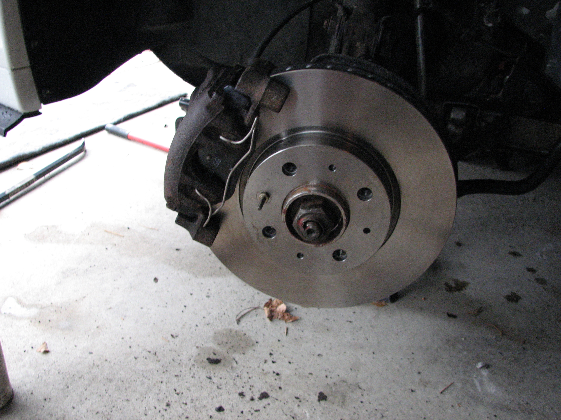

For my Sedan, I was fortunate to find old stock four-lug Brembo rotors for a great deal all around.
Akebono ceramics, Centric braided front lines and Raybestos front calipers refurbished.
For lug Brembo for '93
clearcoat experiment.
all said and done.
all said and done.
That all seems an oddball combination, but it is stopping well.

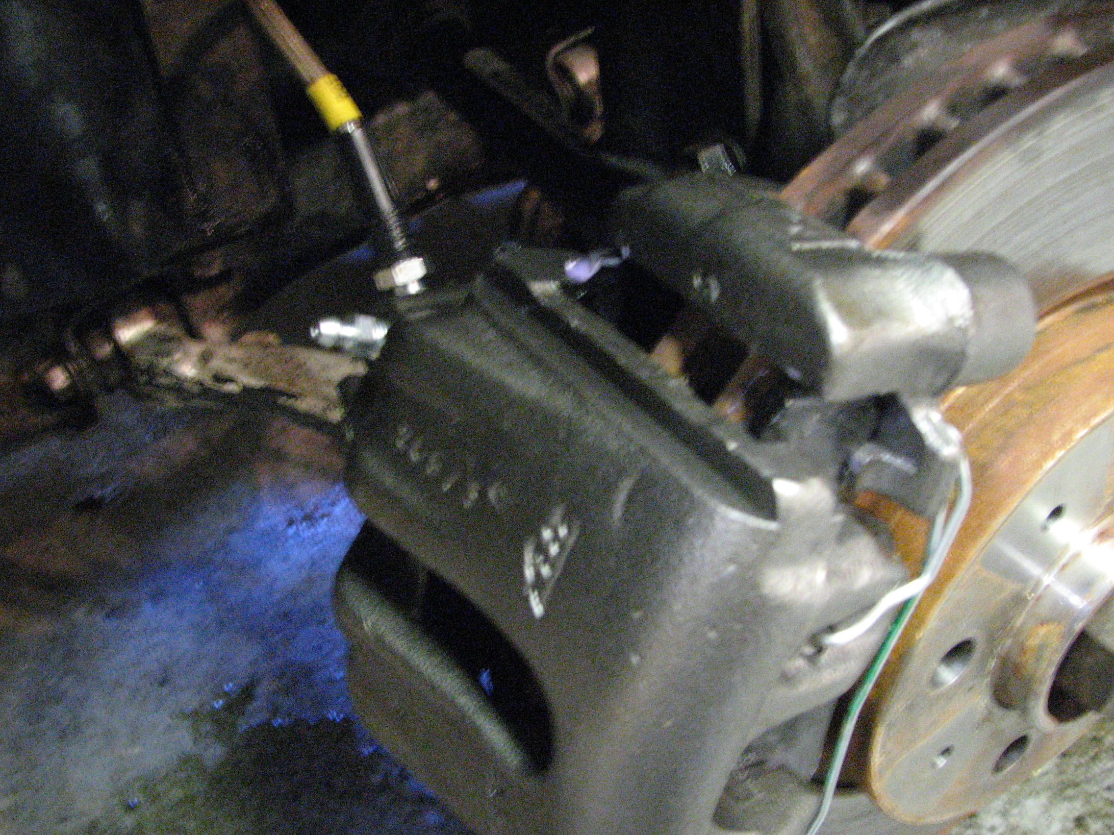

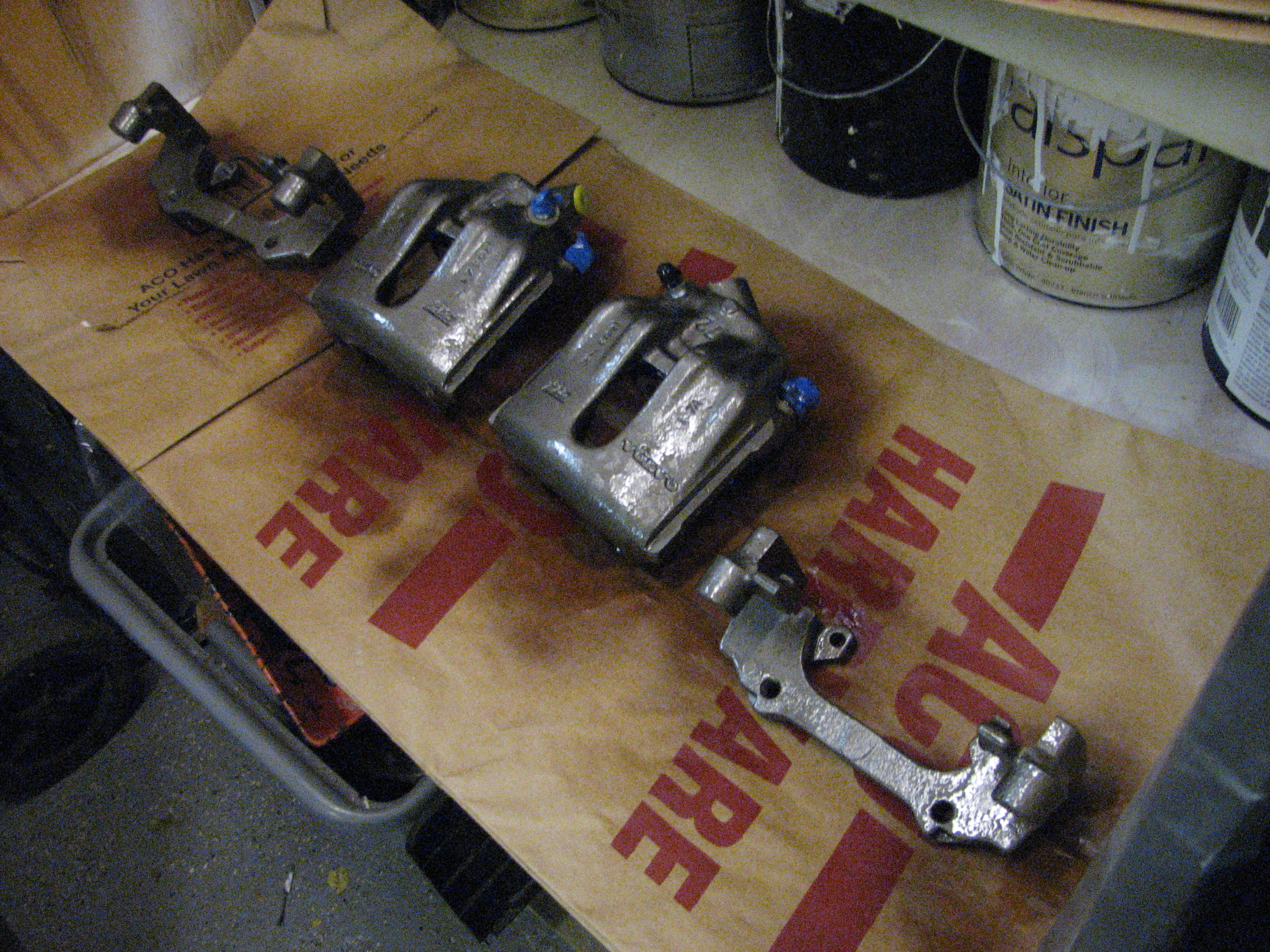

I have an installation prepared for my wagon, but it also involves replacing rear calipers. I have all parts. The previous owner had already installed IPD braided lines in front. Also leaving me with two other braided lines in a parts package.
I know there is only one other flexible line in the rear for the FWD, so it must have been an AWD kit.
The Raybestos calipers will go on the rear. Akebono ceramic all around again.
The only difference will be the Centric drilled and slotted rotors. I will have to update my opinion on those as it unfolds.
If I cannot break loose the lines from the rear calipers, I will replace those as well.
I am driving the wagon at present so I have to be careful not to have it disabled. One day ordeal if possible.
That is my situation at present. Yours will differ, I am sure.(hopefully in a good way)
