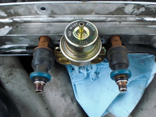

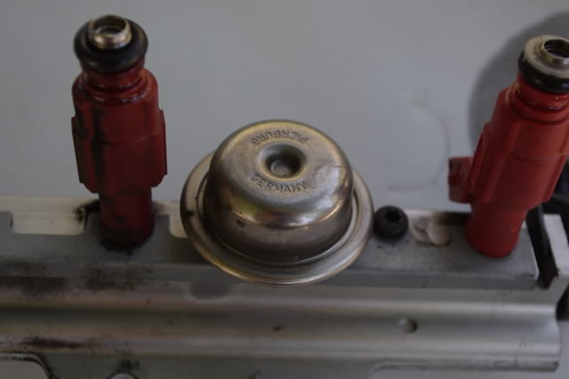

If I'm not mistaken the fuel pressure regulator is used on a system with a fuel return line and the damper regulates the pressure on the single ended system that doesn't have a fuel return line. The regulator regulates pressure on the way out of the fuel rail while the damper regulates pressure on the way into the fuel rail.

This is the way I understand it...
The fuel pressure regulator and the fuel damper are completely different in function and form.
The FPR has a larger body and a vacuum line to regulate the fuel system pressure by vacuum load, let's say the engineers design the fuel pressure to be around 42 psi +/- a bit. So you may see anywhere between 40-44 psi or so.
So let's say fuel pressure is constant at 42 psi, once the fuel injectors open, it drops down a bit, then back up when more fuel flows in. If you hook a gauge to it, you will see pressure as a sine wave.
The fuel damper is much smaller and only dampens the fuel pulses to the injectors. So basically the damper makes the amplitude of the sine waves smaller.
Anyway, this is the way I understand it, I may be wrong though.

CN90 has it right. FPR is used on both of these but it is remote on the systems using the damper. The damper went invisible in 2005-2006. The damper is a flattened seal tube inside the fuel rail as the single point damper was not effective fully over the length of the fuel rail.
FPR goes away beginning in 2003 and fully integrated on all US engines in 2007, when the fuel pressure sensor is fitted. The FPS is supplying ECM with pressure value and ECM in turn is controlling pump via the PEM/FPM to run pump at the speed that gives desired fuel pressure.
