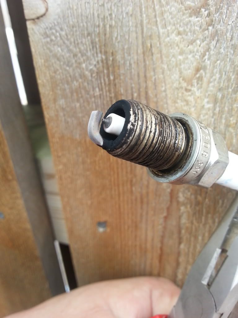

My 97 R have been running proper strong the last 6 months. Then. all of a sudden - not so much. Slight intermittent hesitation when on throttle. The other day I could smell gasolin, just after having been on throttle.
Sitrep: All ignition parts new, OEM. Fuel damper, MAF, TPS and O2 new also +++
Spent the better part of last night looking through plug threads, also looked at evap threads.
Well, today I pulled the negative for 8hrs and reset adaptation. Took it for a good long drive. Still some hesitation and elevated fuel consumption.
Checked fueldamper - ok - no leak
Checked Evap purge valve (mounted on fan shroud) - ok - held vacuum both ways
Checked check valve between purge valve and intake - NOT OK - could blow just as easy both ways.
While I wait for a new Checkvalve, could anybody elaborate on the driveability issues a faulty evap check valve might cause..??
Pulled the plugs, all looked like this
