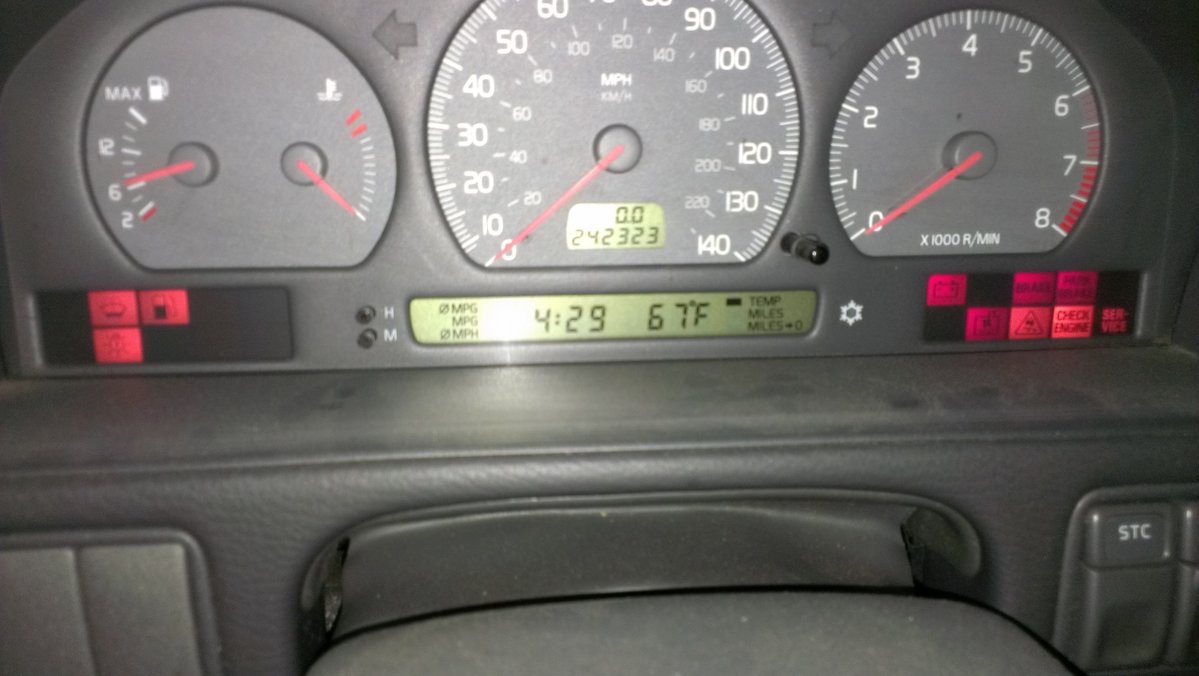

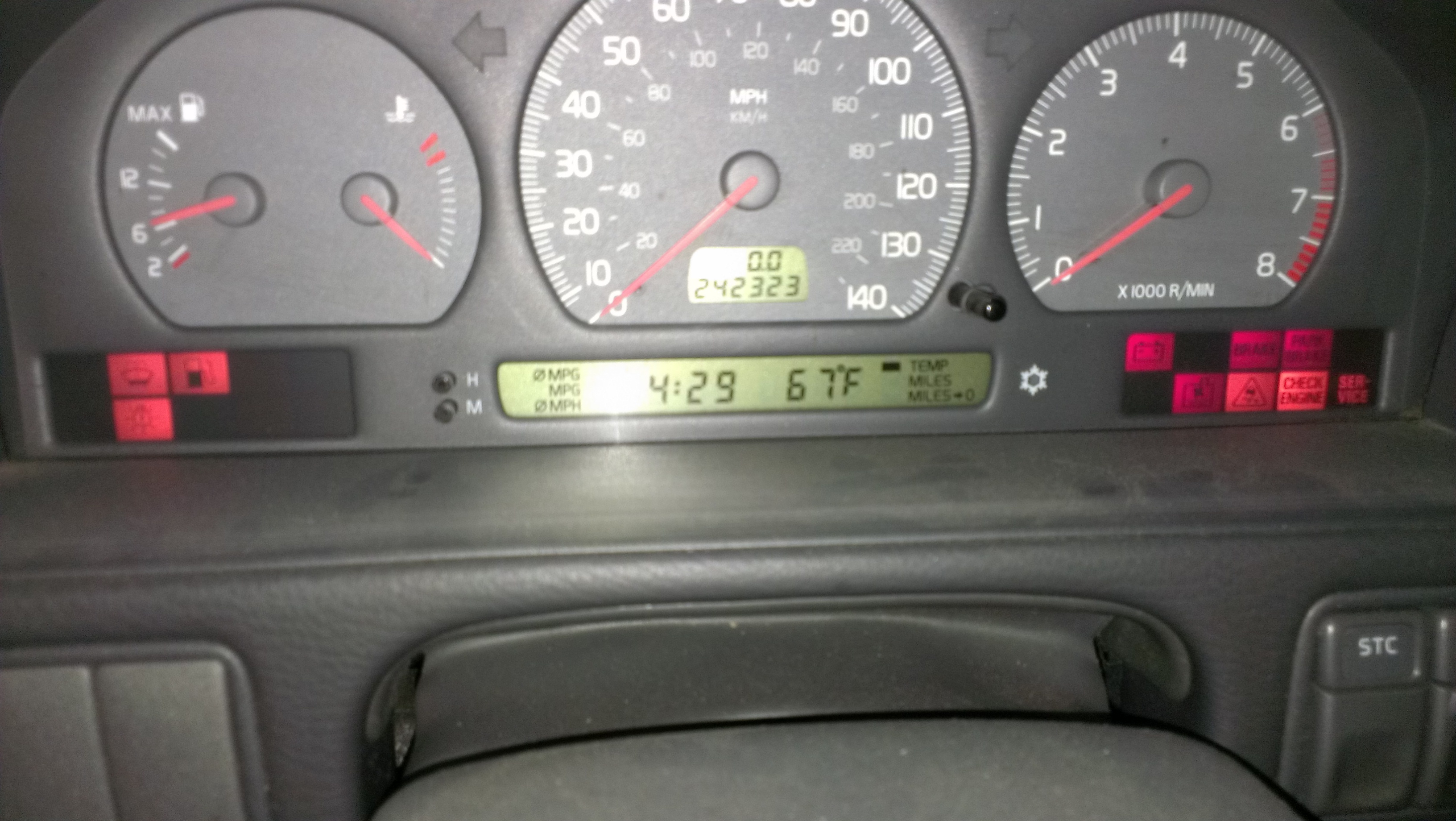

i don't have a code reader here, unfortunately. i'll try to hunt one down tomorrow. the dash is lit up (see attached). i can't remember - is this normal for key in Position II, engine not started, or should some of these lights be going away after a few seconds?No codes coming up I take it?

Yeah, key on will bring up all of the dash lights. Most of them will stay on until the engine is started.
