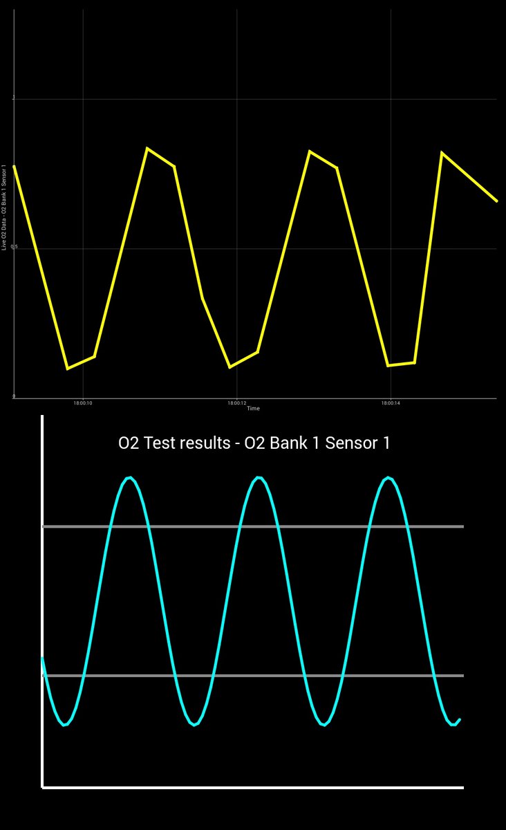

The front O2 sensor seems to be working but I am not getting any voltage or any read out on the second O2 Sensor and I got the P0172 error code. With the TORQUE App I was able to capture a couple of pictures:

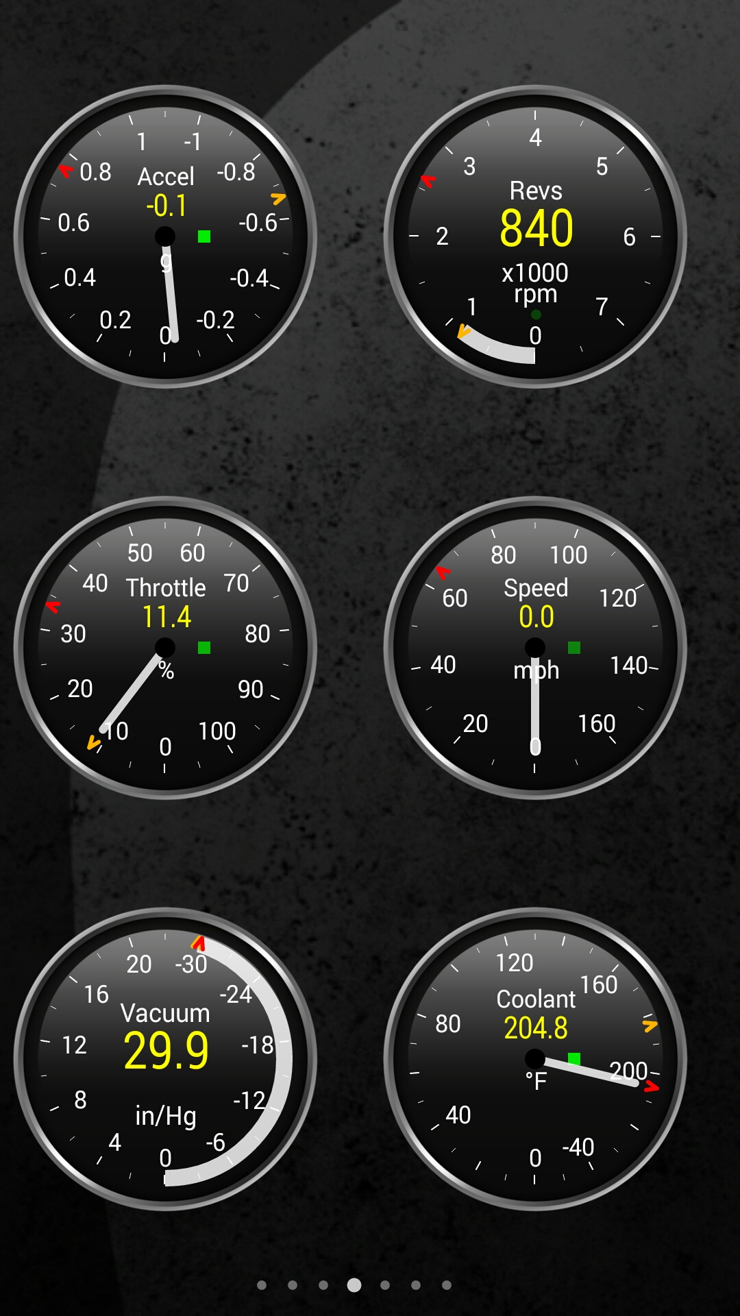

I don't think the second O2 sensor has worked for a LONG time. So Should I go ahead and replace the second one to get ride of the CEL? Or should I start looking for vacuum leaks? I know they can also trigger this but I just had my car serviced and they didn't mention any vacuum leaks - also my vacuum pressure (via the TORQUE APP) is between 26 and 29 PSI - is that what it should be?

Rear O2 does not usually throw a p0172. I think I would first look carefully for and fix all vacuum leaks, especially at the elbow mecheng mentions.

@mechang There is a free version of Torque, I bought it since I didn't want the ads. There are IPhone versions. You still need to buy a bluetooth OBD2 adapter. I got an ELM327 off of eBay.
I'll check the elbow joints this weekend.
So I shouldn't think about replacing the secondary O2 sensor? The Torque app shows no voltage going to that sensor.

Smart phone live data aplications usually don't display valid data.I wouldn't trust it.

Rear O2 is not causing the P0172, and the voltage shouldn't show any swings unless the catalytic converter isn't working.

@jblackburn: So the rear 02 only works when the catalytic converter is NOT working?
I have no idea if the catalytic converter is working or not - how would I find that out?
