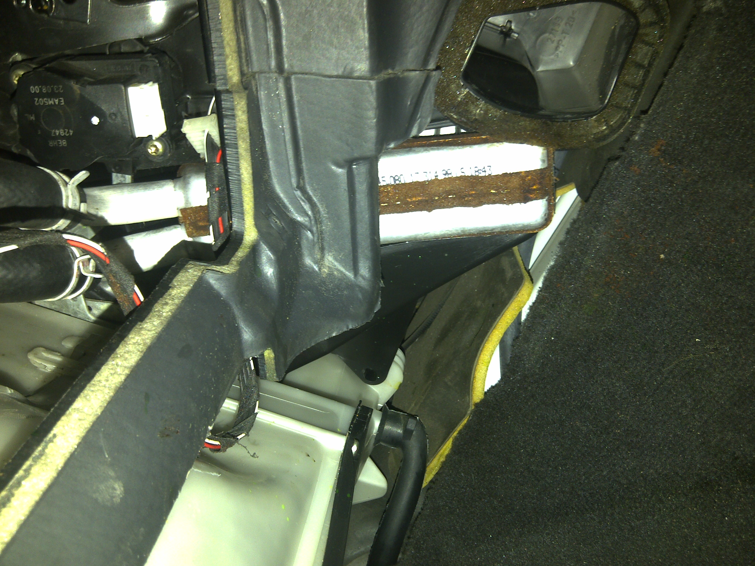

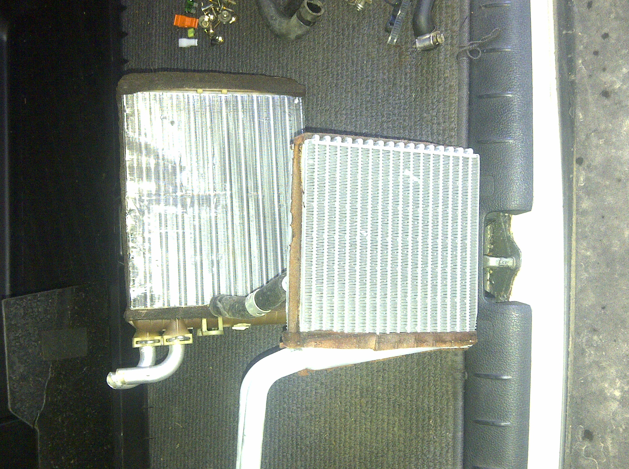

Yes I just "Love what Volvo did to the Heater Core too" "Not" !!! I have changed mine out in a P2 to a Mercedes A160 Heater Core that is all Alloy (mine is a Right hand drive car in Australia) and it is still really hard to get the core out.
The removal of the Leaking core in my car was due to the "O Rings on the Core Splitting" and the leak was bad enough to warrant the replacement core, but I did not want to pay the outrageous sums of money that Volvo wanted.
The problem is that the "Firewall Connectors had also worn and were Leaking as well", so I replaced all of the Volvo Parts out and now have a system that is back to basics and held together with Hoses and clamps and if it is good enough for Mercedes then it is good enough for both of my Volvo's (an 850 T5 Estate and a V70XC AWD Wagon).
I am now far more confident and I have no more leaks on a car that has done 220,000 km.
I hope all of this helps you.
