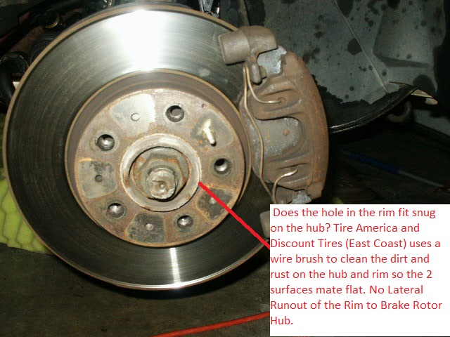

What year and model did the 17" rims come off of?
The tire(s) could be out of round?
Does the center hole of the rim fit perfectly on the hub?
Is the rim surface and brake rotor surface clean? If not this could create Lateral Runout.
The video is for Lateral Runout on Brake Rotor but the principle applies for the Rim and Brake Hub surfaces.
Brake Assembly Picture from "rspi"
http://www.atthetipwebs.com/technologyi ... nt_s70.htm
