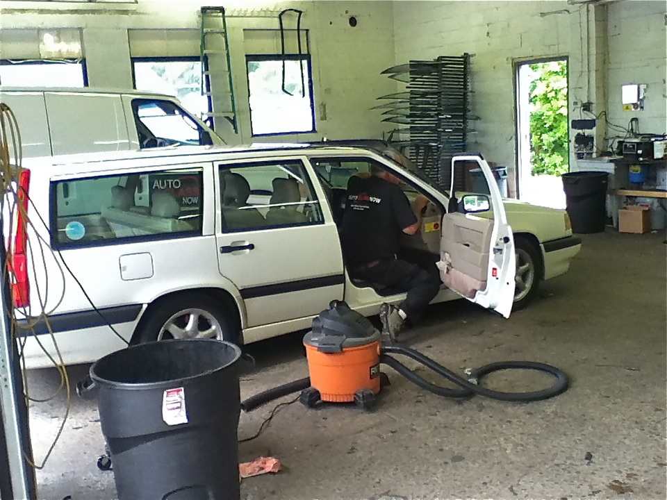

When I first got to the shop, I thought it looked a little messy, but not too bad.
1 Windshield shop floor.jpg (217.53 KiB) Viewed 1337 times

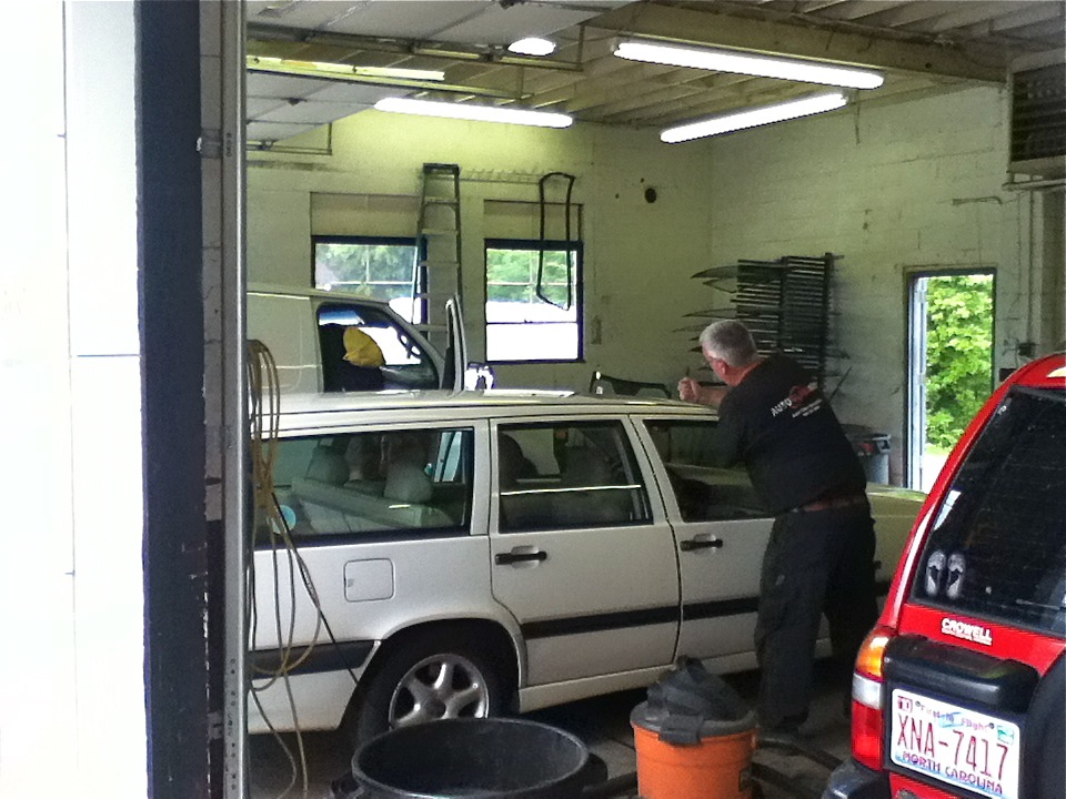

A guy who looked like an old pro cut out the old windshield using knives:
2 Windshield cut out outside and inside.jpg (231.68 KiB) Viewed 1337 times

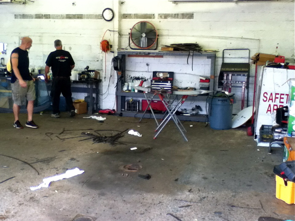

He cleaned up the surfaces and then applied some new adhesive with a cordless electric caulking gun:
3 Applying new adhesive.jpg (222.01 KiB) Viewed 1337 times

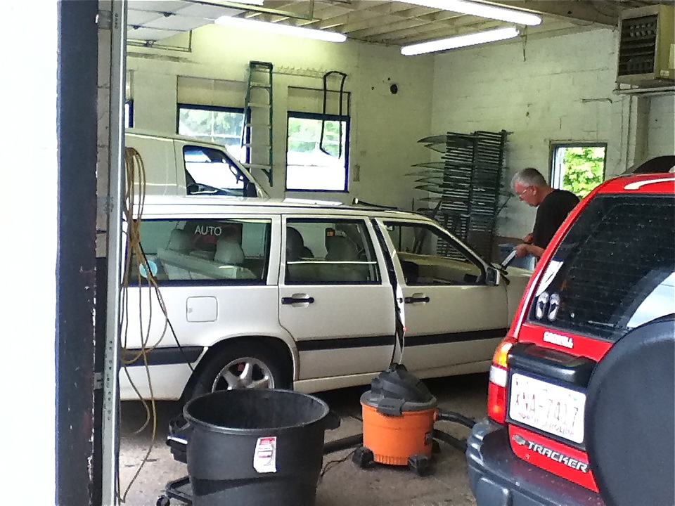

New windshield going in to position, held with a hand below and a suction cup in the middle:
With the new windshield in place, he put the roof trim back in place:
4 Popping roof trim back into place.jpg (199.84 KiB) Viewed 1337 times

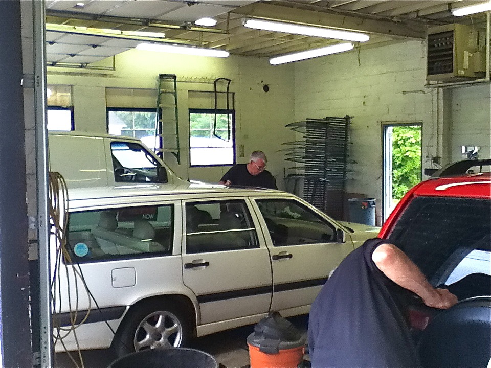

Then he cleaned up the windshield with some cleaner spray and a towel:
5 Cleaning up new windshield.jpg (252.19 KiB) Viewed 1337 times

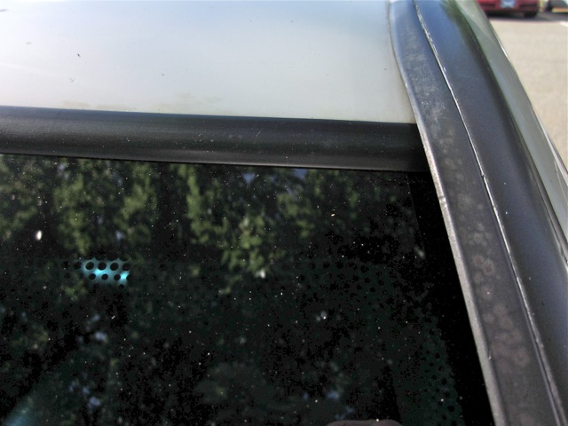

Here is a close up of the base of the windshield on the driver's side showing the lower trim:
