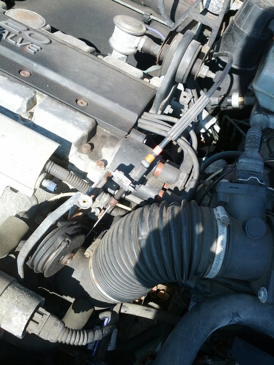

Good morning guys-
I just came in from removing the bolt from my AC charge valve, which I sheared a few weeks ago. Both today, as well as a few days ago, I noticed that with the hood open, I found smoke coming out from under the distributor cap. I don't know if this is a coincidence or not, but last week, after I put gas in the car for the first time in about 2 months (half a tank lasts a while when you don't drive it much), I got a P0455 about 10-15 miles later. My gas cap appears to be fine, and the hose between the purge valve and the manifold seems fine as well. Back to this issue: the amount of smoke was small, and barely even noticeable at times. It seemed to stop for a minute or so, but I may have just been unable to see it, as it was extremely bright outside. Attached is a picture. The smoke was coming from a rubber coupling directly under the distributor cap. This coupling appeared to have two hoses running from the passenger side of the car, which ran towards the block. The side closest to the radiator ran out and appeared to go into the tubing between the air box and the block. I touched the coupling with the car off, and it certainly felt loose between the two linked pieces. Where is this smoke coming from, and does it have anything to do with the P0455 CEL?

I dont know N/A motor set ups too well, but I would think given the area and general direction of hose travel I would say Flame Trap/PCV system, like i said i don't know the set up of a n/a but i know there are some on here who know better about them.
when the engine is warm and you pull the dipstick do you have the white puff?
On my T5 the hose that comes from the PCV box below the intake to the intake hose was cracked where it bends around the head and would puff from there right below my cap

I just took a look. There is smoke coming out of the dipstick, as well as smoke coming out of the block when I remove the oil fill cap.

If you still have the flame trap you can take it out and just throw it away and that might help things but it sounds like you are due for PCV service.
