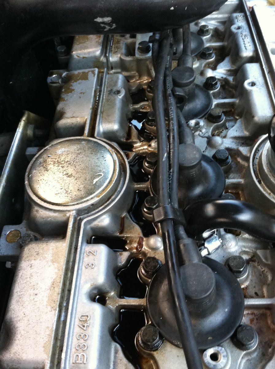

Agree on vac. line being the cause of idle dip. Check the line behind the power steering pump - if this one falls off, it will also cause the oil leaking down the turbo, as no vacuum is provided to PCV system @ idle.
Also, pull the spark plug cover off and look for oil in the little valleys - it will pool up from a bad oil cap seal or loose valve cover PCV hose (the U-bend hose that snakes up there), and then leak down on the turbocharger/exhaust.

^That's the small vacuum line - tucked behind the power steering pump when intake manifold is lowered.
There's the PCV hose to the top of the spark plug cover - give it a very light tug to make sure that the clamp is still holding it down.
If both of those check out, but there is still oil everywhere like in my picture, replace the seal on the oil cap.
