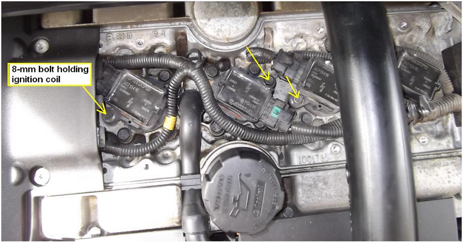

4. Label the ignition coils 1, 2, 3, 4, 5 to avoid confusion.
- No need to disconnect the wiring from the ignition coil
- Simply lift the ignition coil (with the wring still attached) upward. You may have to rotate it first to break the bond between the boot and the spark plug.
- Ignition coil is held by a single 8-mm bolt.
