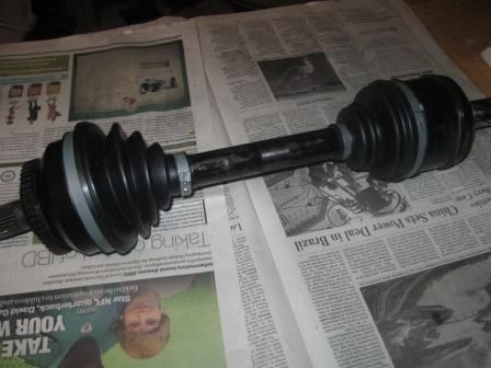

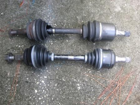

Here is an image of the axle I removed from my 1994 Turbo (which had been replaced about 7 years ago) next to a 1998 C70 axle which I reworked. I am pretty sure the C70 axle is OEM because it still had small bits of the Volvo sticker on it plus the inner boot was clearly marked Lobro. The compressed length was essentially the same, and it fit in the car with no problem.

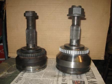

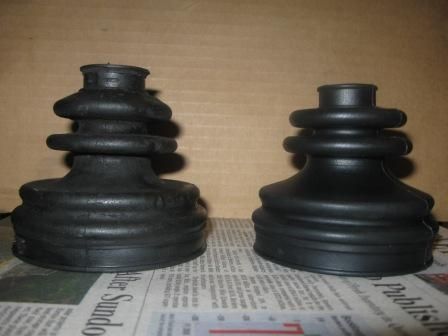

2) There are two different types of outer CV joints. I will refer to them as naturally aspirated (NA) and Turbo for simplicity. It appears that the OEM turbos were supplied with the larger ones, but because the axles are interchangeable as assemblies you might have either.

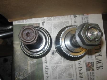

These are your two options. There is clearly a difference in size between the NA (left) and Turbo (right).
These cannot be interchanged on a given axle because the inner spline size is different. Even though they all have 26 splines at the hub, the NA CV joint has 25 splines inside while the turbo has 28 splines. This means the actual axle shafts are different from NA to turbo.
Other easy to measure differences:
  • The OD of the turbo unit is about 98mm while the NA is 90mm.
  • The CV balls in the turbo are 19 mm compared to 18 mm for the NA.
I do not know how strong either axle is, but it appears that at least you get something bigger with the OEM turbo axles.
Note that these both have a 48 tooth wheel for the ABS.

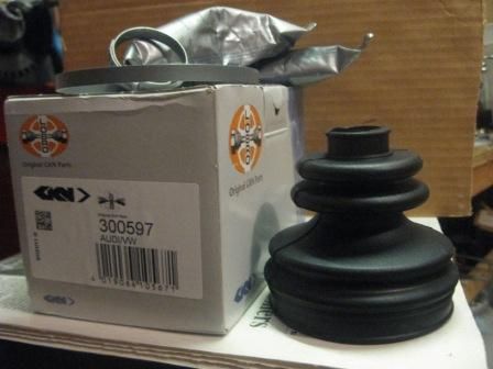

The inner boot was a different story. I couldn't find a good GKN part number anywhere, which I found strange because (as I said earlier) I had a 1998 vintage inner boot on a Volvo axle that said Lobro.
So I started looking into interchange data in the aftermarket to see if there was anything close. It turns out that there is a bunch of overlap between a number of Audi's and Volvo as far as boots from some of the aftermarket suppliers like Raybestos. So I poked around and found A GKN part that appeared to be essentially the same inner boot, or at least close enough so that it would probably work.

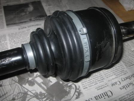

Here's my slightly stretched out 16 year old original next to the new GKN part.
This particular boot contained in this boot kit (GKN 300597) is OEM on a bunch of Audi's. I used a 1994 Audi 100 S Sedan as the point of reference. This kit comes with an extra clip plus 6 bolts that you don't need, but includes the correct size clamps and two 80g tubes (for 160g total) of grease.
Here's the axle with the Audi spec inner GKN boot and a Volvo spec outer GKN boot. It was a little tight at the inner joint , but the inside geometry looked the same as the original so I am pretty sure it will hold up fine. Both of the boots kits were made in Italy.

Nice find on the Audi boot.
I just want to confirm that Audi GKN 300597 fits Volvo Turbo INNER boot?

I made my guess on the boot based on comparing the GKN information with an aftermarket supplier.
For that part number boot (in the GKN 300597 kit) they list dimensions of 88 mm length, 21 mm small end ID, and 82 mm large end ID. This boot is specifically for a number of Audi applications, and seems to be included in a number of kits. I used the 1994 Audi 100 application because it was the least costly and included the clamps and grease.
An aftermarket supplier with a more universal equivalent (the Kotek BT-231, for some models of Audi 90, 100, A4, A6, SAAB 9-3 & 9-5, Volvo 850, S/V/C70, and a few others) listed dimensions of 89.5 mm length, 21.3 mm small end ID and 78 mm large end ID. That seemed close enough to give it a try.

Was the Audi boot a good fit for your Volvo Inner side?
northernlights
Posts: 251
Joined: 12 Oct 2012, 22:49
Year and Model: 850 Turbo 1994
Location: Florida and/or Raleigh NC, depending on the day
Been thanked: 8 times
Post by northernlights »
So far, so good....about 200 miles since installation.
Like I said in the original post, it was tight going on, but they are supposed to be tight when they are new. The last thing anyone wants is for them to slip off after install. I believe keeping grease off the rubber where it touches the joint OD and getting a good crimp on a good band is key. Some of the aftermarket bands seem flimsy compared to real Oetiker and similar.

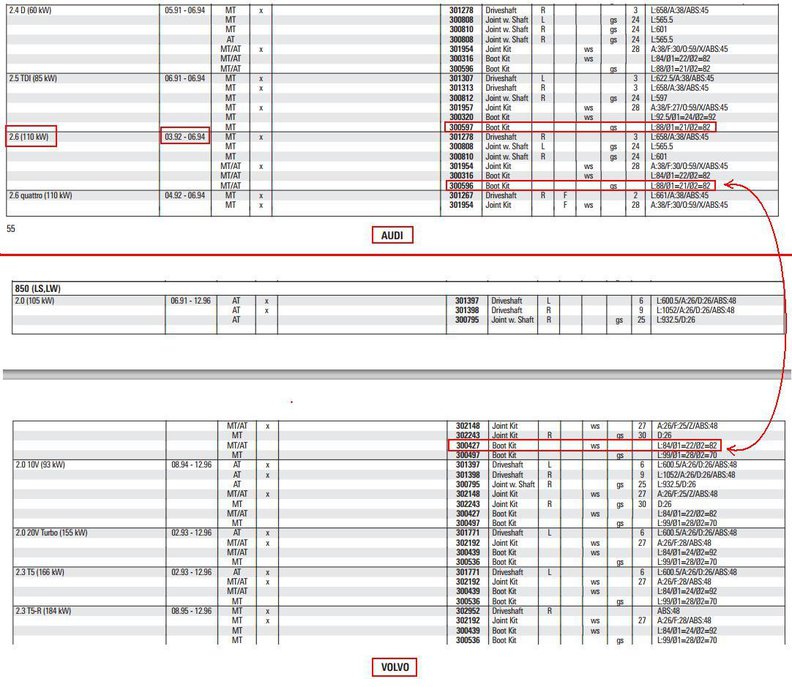

GKN catalog is below:
http://www.gknservice.com/fileadmin/use ... LOEBRO.pdf
For Audi, see Page 55.
I am re-posting the photo (ws = wheel side; gs = gear side, according to GKN pdf file):
Note:
- 1994 Audi data: L= 88, Inner = 21, Outer = 82mm.
- Volvo 850 data: L= 84, Inner 22, Outer = 82mm.
Basically the Audi boot is a very god fit!

The HPT and LPT cars use 300439 , for the outer CV boot (I assume that is WS: wheel side)
300439
L:84, I=24, O=92
I don't see anything listed for the GS (inner boot) for HPT and LPT models in AUTOMATIC, only manual.
300427 is a WS boot not GS.
The 300427 and 300597
L:84/88, I=21/22, O=82
Are you suggesting to use 300596 for the inner or 300439 for both. The outer diameter (O) is quite different, 10mm is a lot.
If I new what the factory inner was, we can match it but I'm not sure how you see that from this data.
Confused :?
