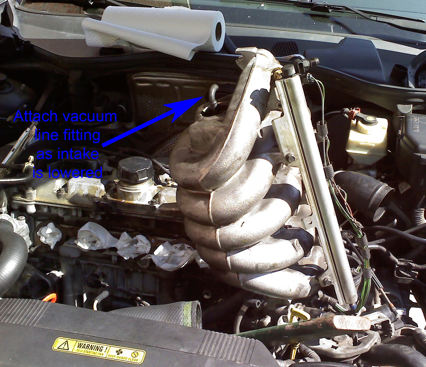

Any pictures/photos for me showing that area "vacuum elbow on the side of the intake manifold behind the thermostat housing" ?

Loads of good pics on here.
https://www.matthewsvolvosite.com/forums ... =1&t=28487
It's this elbow
https://www.matthewsvolvosite.com/forums ... &mode=view
Taken from jblackburns guide.
It's this elbow

So do I really have to completely remove the manifold to replace the PCV elbow?
Wow, I might have to get someone else to do this for me.

Removing the intake manifold sounds much harder than it really is. The secret to life is a long 1/4" extension and a swivel socket. The bottom bolts don't need to be removed all the way when removing the manifold.
The bottom bolt in the #1 cylinder end of the engine is tricky since you can't really see it but the rest of them are very easy.
...Lee
...Lee
