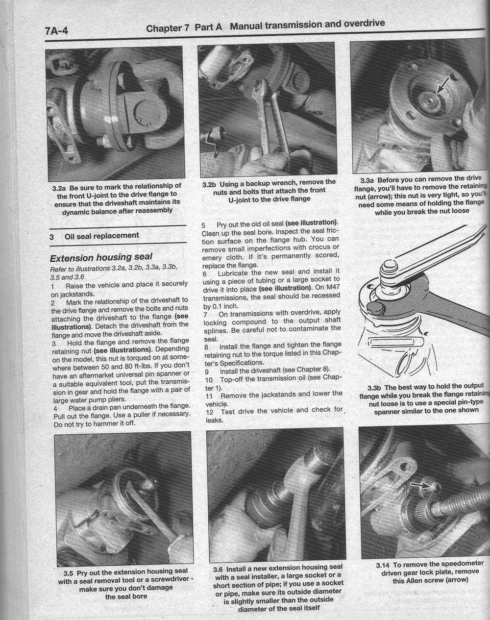

Has anyone replaced the extension housing seal for an Automatic Transmission?
Base on the instructions from my Haynes manual it seems that a complete transmission fluid drain isn't essential? #4 just mentions a drain pan seemingly to catch some overflow after removing the flange.
Can you see anything missing on these instructions?
Thanks!
From Haynes manual - Extension Housing Seal Replace for AT or manual Transmission

Dome wrote:Can you see anything missing on these instructions?
Look at that drive-line nut and determine if its a left or right hand thread.
Volvo shop manual (TP30578-1_automatic_transmissions_bw55_aw55_aw70_aw71.pdf) shows a pic where it is turned clockwise, and then it notes 45-Nm
It looks like an easy job, if you have that holding tool, and something the right size to install new seal.
