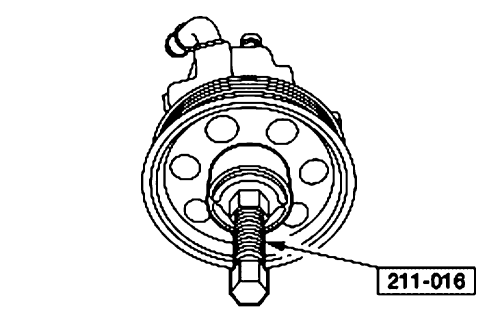

Hi, Can any one suggest from where I can get this tool to take pulley off from Steering pump.
Please watch attached pictures as reference.
Will surly appreciate.

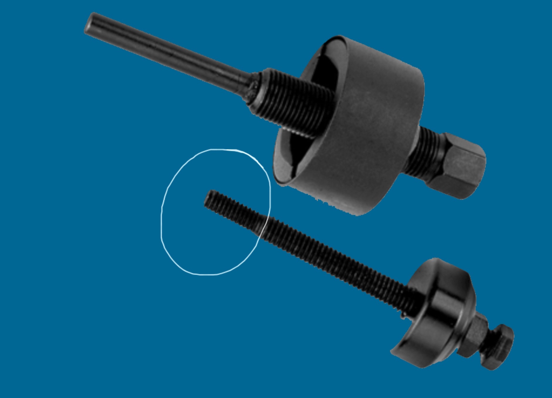

Check with this site sponsors first, if they don't have it,then check with your local auto parts or eBay,it calls"Pulley puller"look for the one that can remove and install the power steering pulley.Hope it helps...

You are right, there are bunch of such tools available on ebay but one cannot be sure which can easily use with Volvo s80.

You are welcome,you should buy at your local tools shack,because these tools are made for Metric thread size,so it will work fine for your Volvo.Most of these tools sold in US are made for Inch thread size.Some are made for both thread size.The attachment picture where the thread inside the circle is the most important part of tool,it has to match the internal thread inside the shaft of power steering pump,it will hold the jackscrew in the shaft so you can install or press in the new pulley back on the pump shaft.Hope it helps...
