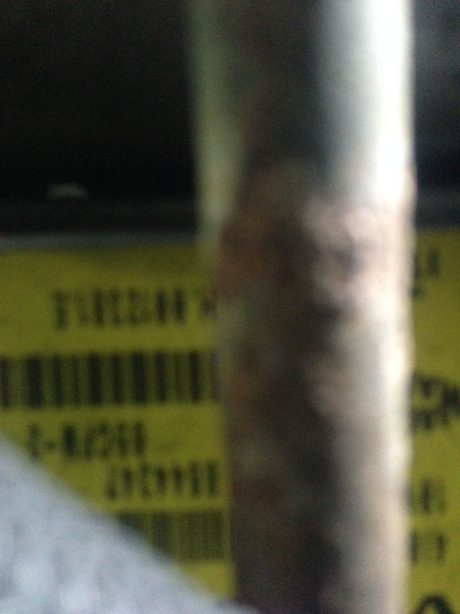

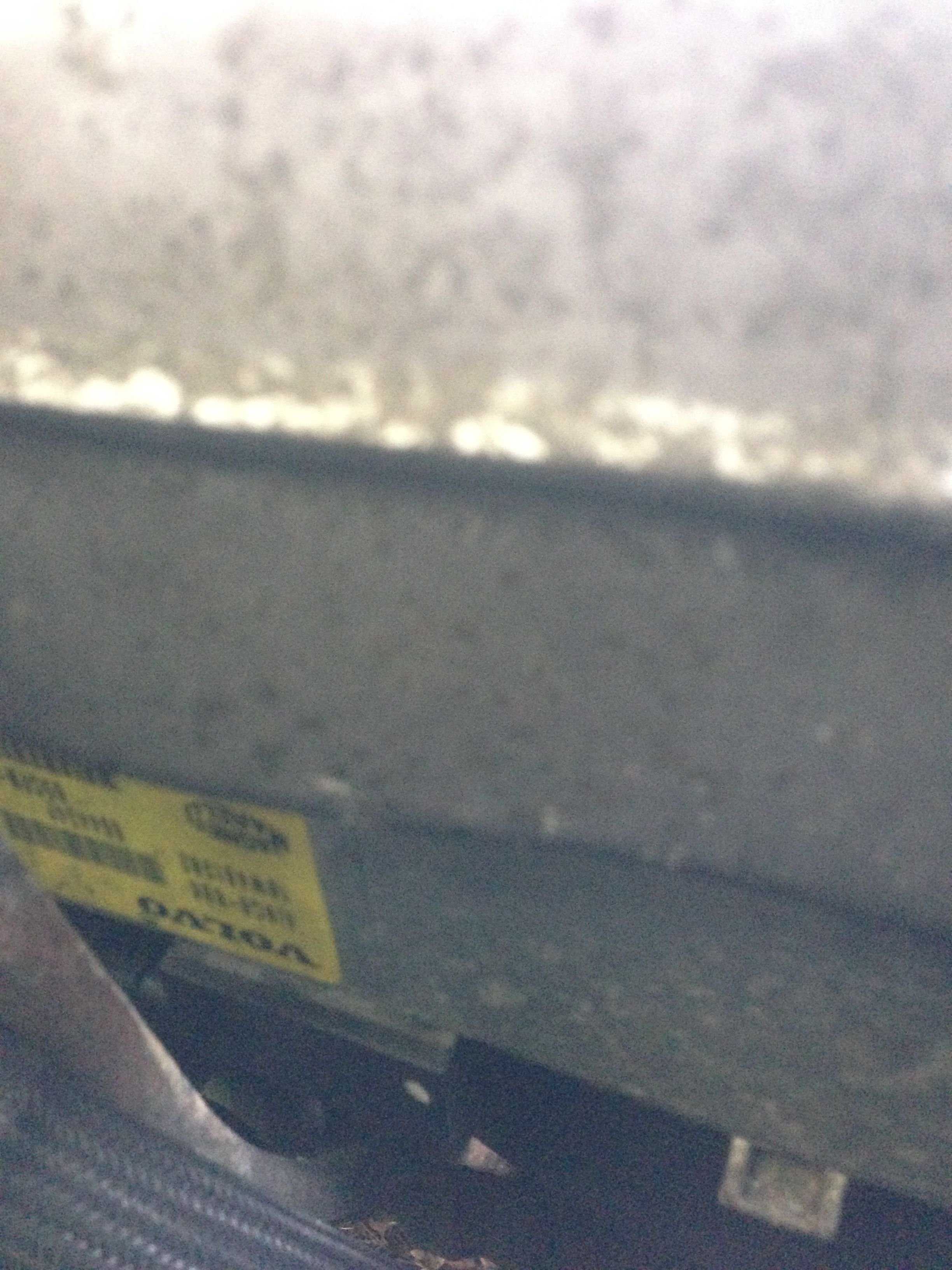

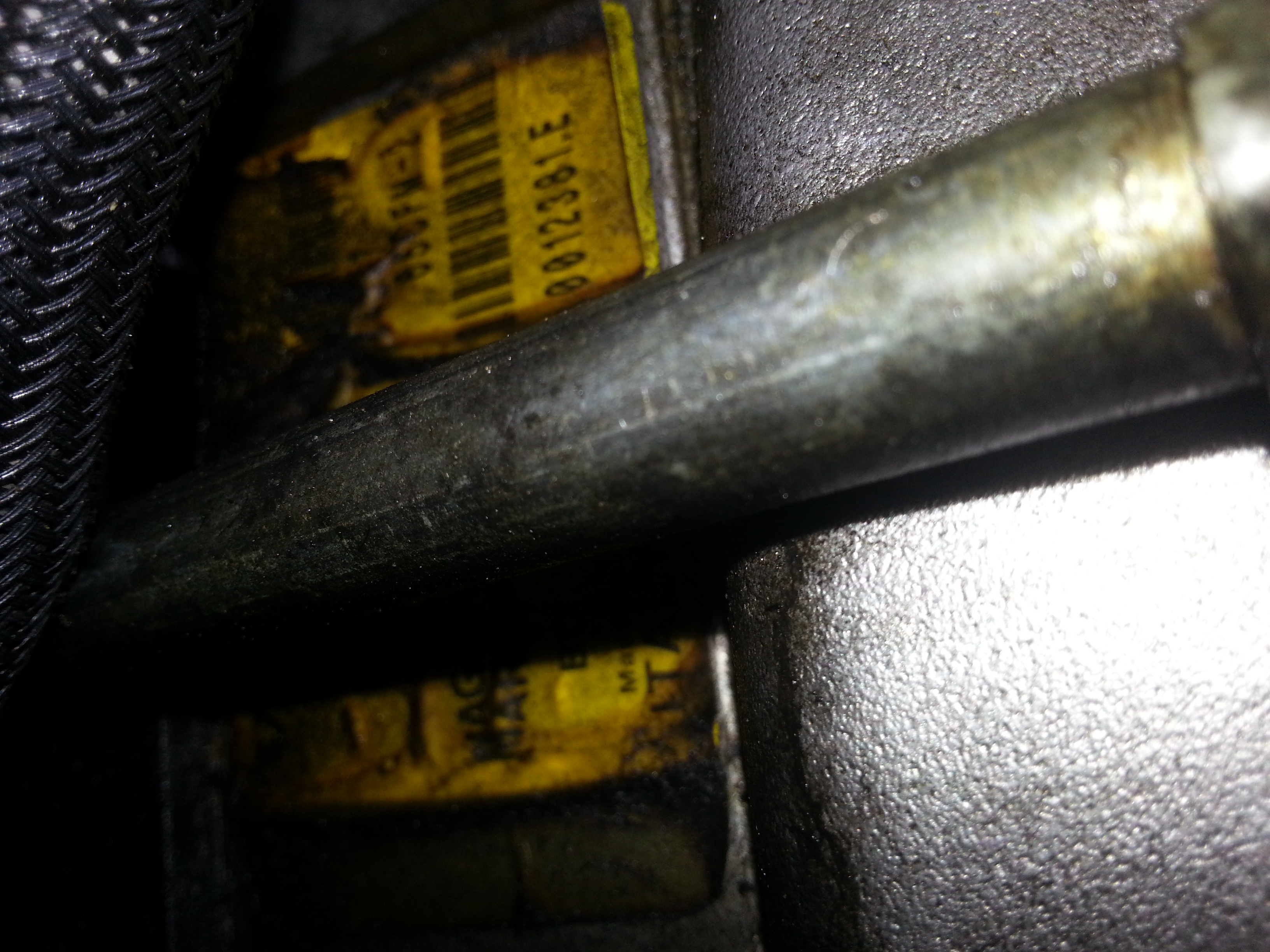

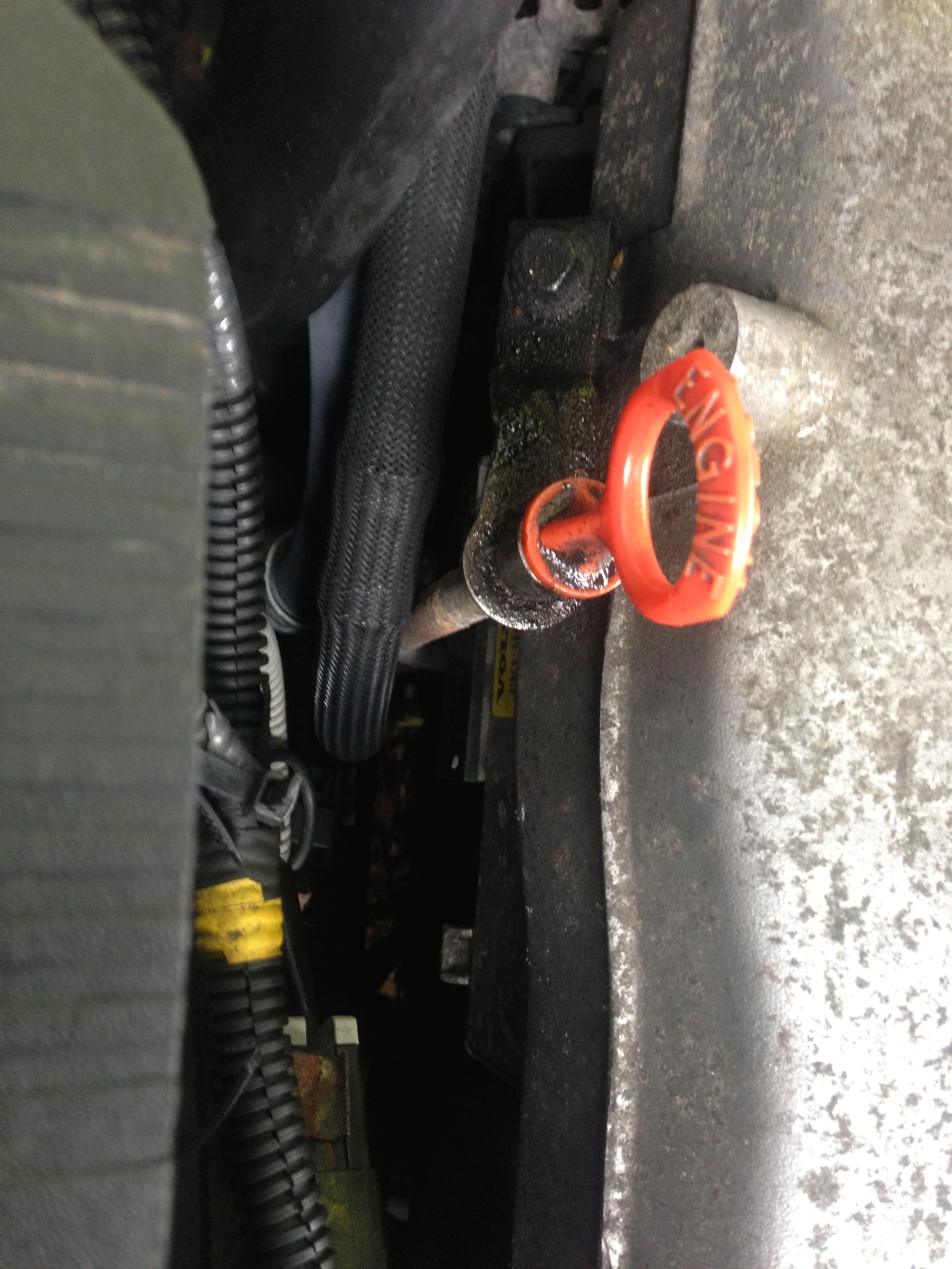

When I cite stock ETM, I am not actually sure. I doubt I have a non-yellow sticker as I'm near 170,000 miles. Is there a way I can easily view this without removing the fan, maybe with a camera or a mirror? I know where the ETM is located, but I don't know what this sticker is that I should be looking for... I found a 99 Non-Turbo in the junkyard with an ETM still in it, and it had a GREEN marking on it. Like a paint or marker on it. Is that compatible and does it sounds like something important to note as being green? I can live with the STOCK BOSCH MAF for now, I was just in a hunt for having no CEL. The car ran relatively well as it was... but the hunt for the no CEL, I'm sure you all can agree is a noble hunt! =)

Thank you abscate. I have the turbo setup and cannot get to the ETM until the weekend. If I see what the sticker looks like then that might give me an idea where to look.

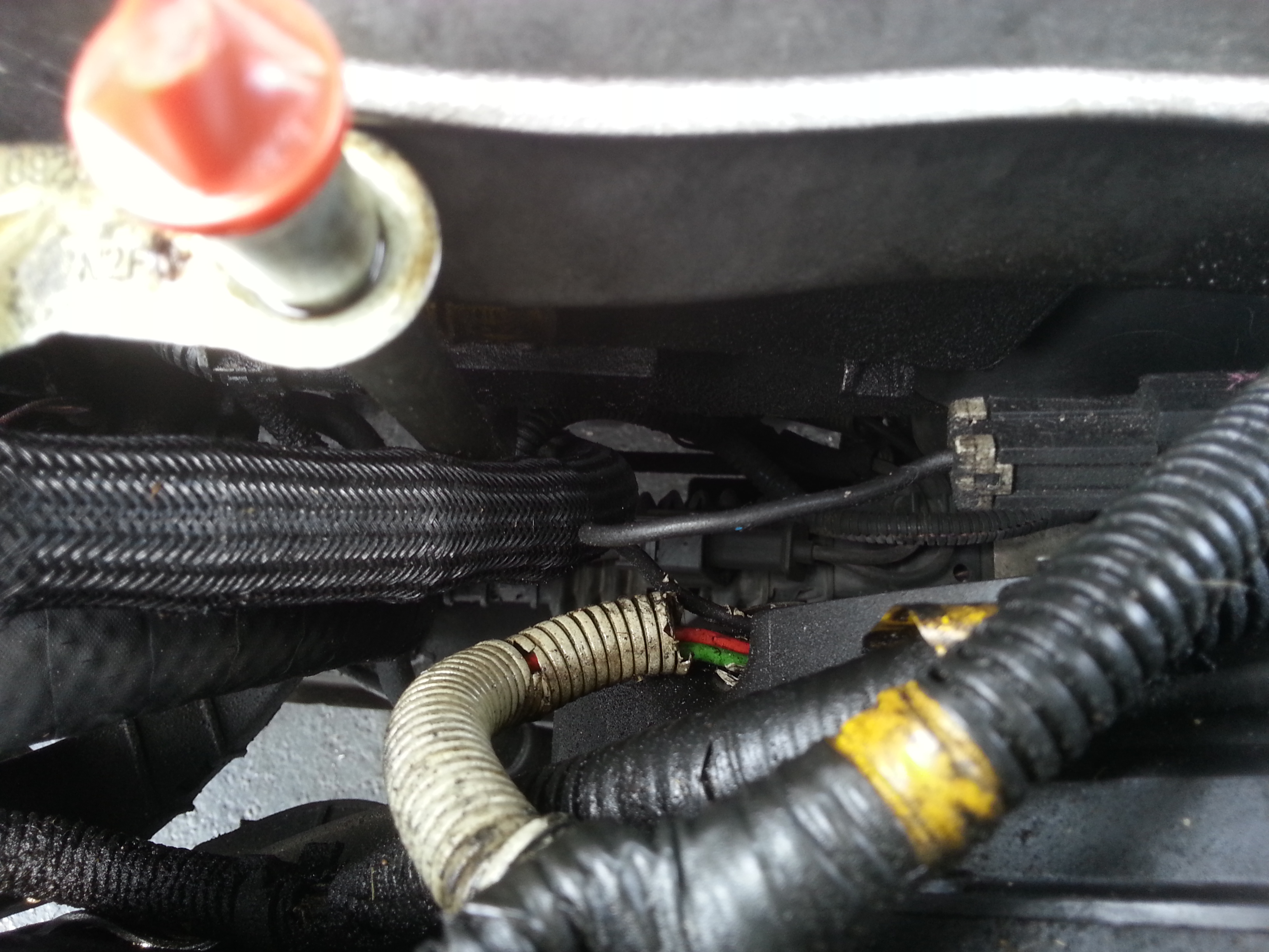

abscate, thank you so very much for the pictures. That is a very clear idea of what to expect. I wonder if that yellow tape or paint on the wiring is relevant as well? I shall go take a look under my hood right now.
