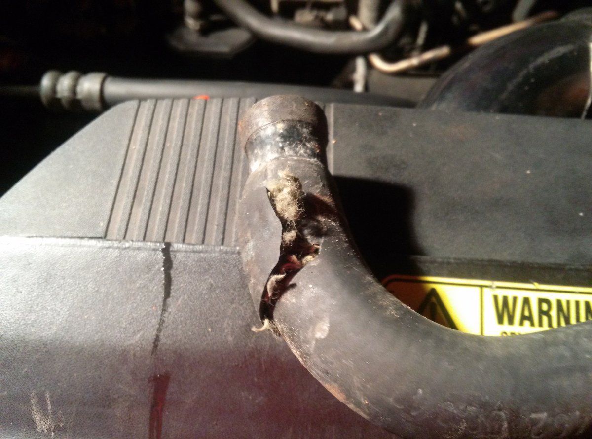

Cool, thanks Lee.I ran into this beauty on the double check before installing the head, so I'm fixing it first.

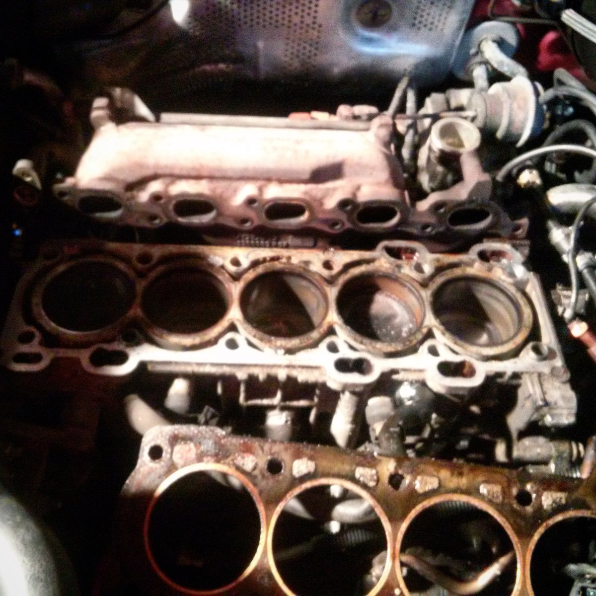

Since I was several Coors original deep last night, I neglected to mention that I did not remove the exhaust from the car. By some miracle the studs ALL came or of the head. I will try to insert the studs partially into the manifold and hang the gaskets on them.
Pic is from earlier in the process
