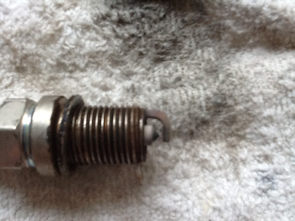

I just got done replacing the spark plugs on my new to me 2000 V70 X C. On start up extremely rough running. Smooth after warming up and at highway speeds. The gaps on the old plugs have worn considerably. I would put in new Volvo plugs. I got my set off the bay for $55.00 with free shipping. I would hold off on coil packs.
This was the best of the 5
kahl
Posts: 943
Joined: 27 October 2012
Year and Model: 2000V70XC
Location: columbus ohio
Been thanked: 10 times
Post by kahl »
Just for giggles the gap on the pictured plug is .032. I was able to fish another plug from the trash and it was at .036. The correct gap should be .028.
