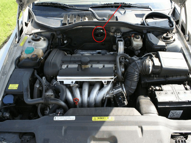

Hi Lee thanks for the reply but everything works fine in the car just the alarm goes off when you start the car and drive ,after about 5min its disarms its self and all is well. the alarm is the alarm 11 which i think is the up dated version of alarm 1 .I removed the relay 210/211 and crossed the 2 pins to start yesyerday so driving around with out alarm and no central locking. Tell me where is the alarm hooter/siren situated in the engine compartment looking for it and cant see it anywhere

The alarm horn is located on the firewall, near the center of the car.
It is circled in this picture.
...Lee
