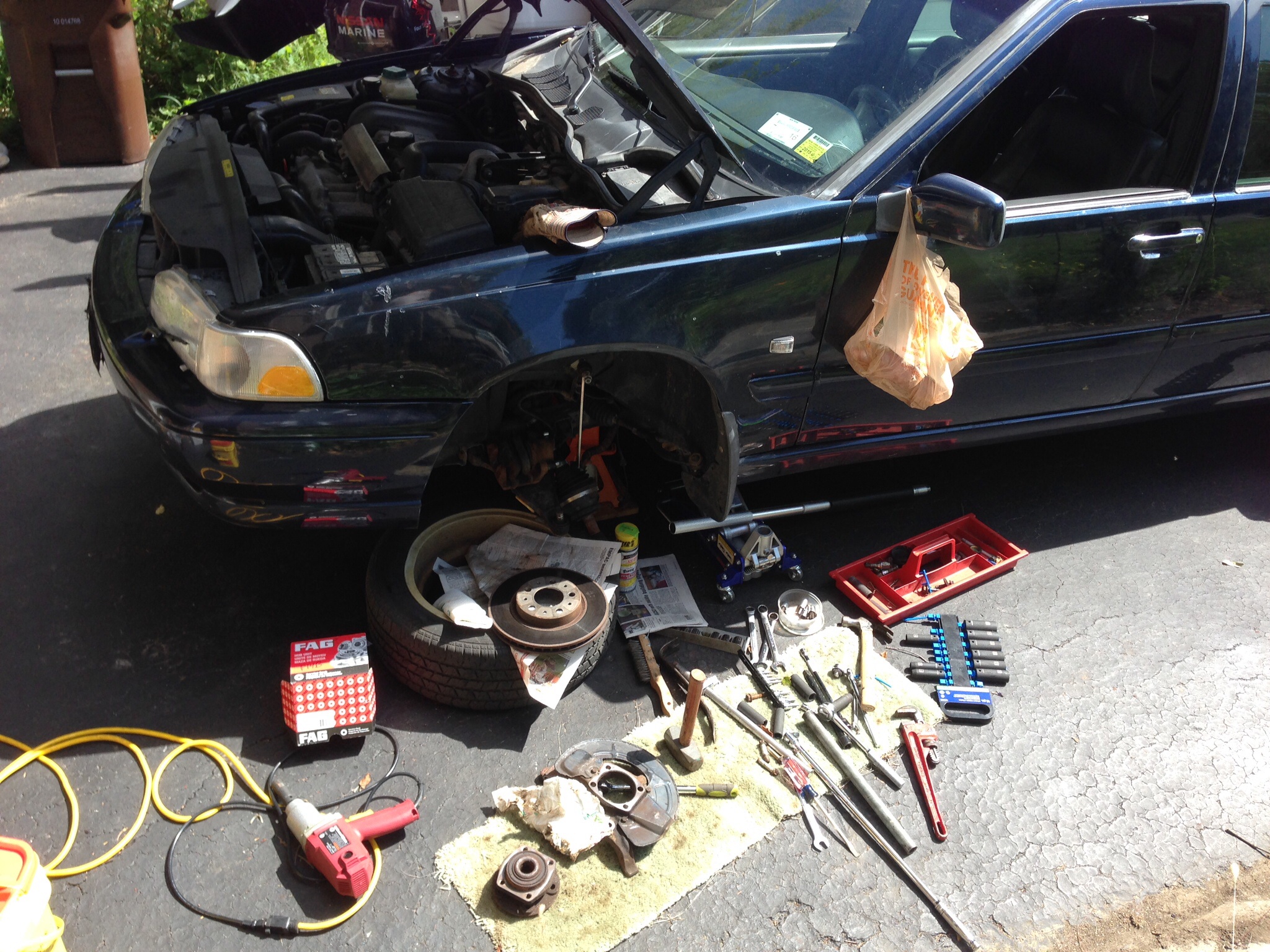

I think I have the bigger rotors on the 1999 T5, so I might need 16s
Any issue putting these on the 2005??

Much less of a pain to check when you happen to have the entire T5 front end in pieces for struts, springs, and wheel bearing...

1999T5 rotors measure at 275mm (11 inches)
Does this mean the 15 inch steel wheels will fit??

Those are standard rotors, 15's will fit no problem.

They are actually meant to be 280mm, but this does mean 15's will fit.
