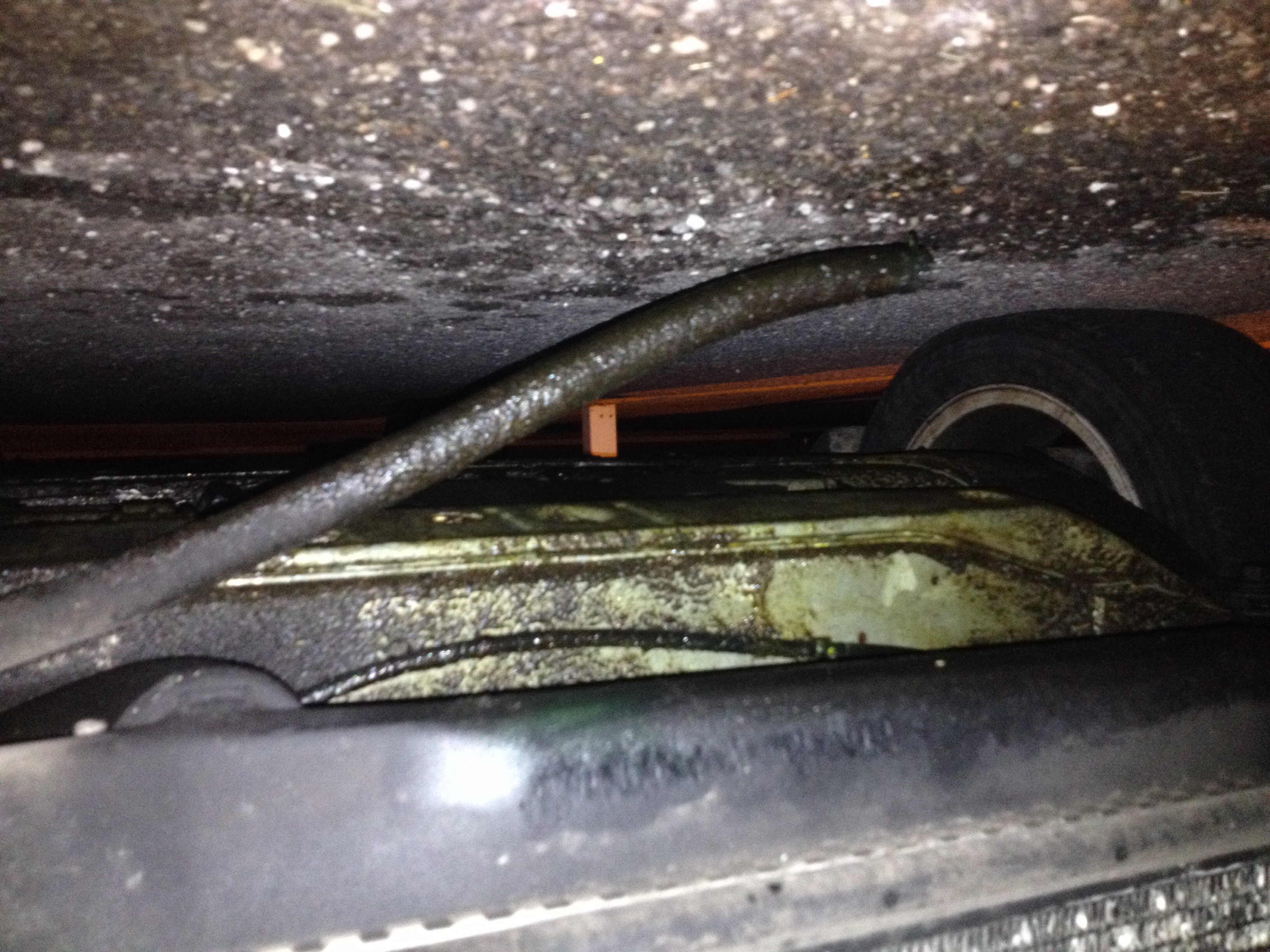

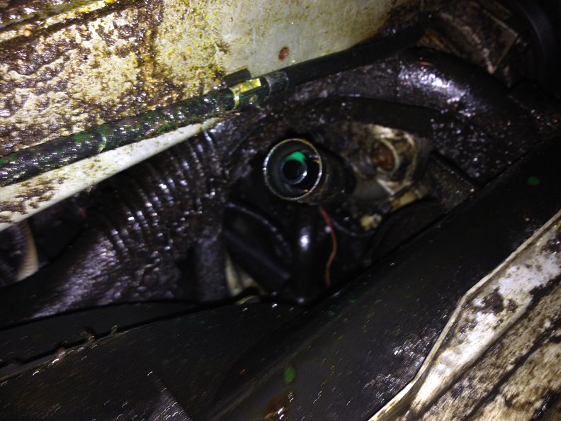

Hey guys, I'm in need of a little bit of help. I blew a hose the other day on the way to the gas station. Suddenly a loud sound that I can only describe as sounding like a sneeze or a pshshsh! Almost immediately afterwards I noticed the AC begin to quit working. So I pulled in and filled up with gas and looked under the hood and noticed a disconnected hose in the front under the radiator. The hose is not as big around as a radiator hose but I don't know what it is. I did see a small puddle of green coolant on the pavement underneath it when I found it. I snapped a couple pictures. Just wanted to know what hose it is and what is involved to fix it. Thanks!

Looks like an a/c hose.

I thought ac hose as well. After a more thorough look it's the ac hose that goes from compressor to condenser. If I put a new hose on, do I need to refill refrigerant?

That's uv dye check coming dripping. Worry more about how much oil came out with it.

As the hose is replaced you should also replace the accumulator. Once those parts are installed you need to pull a vacuum on the system and check that the vacuum holds for at least 30 minutes. I use a micron gauge and run the vacuum pump for typically about 15 minutes or until I get to at least 500 microns. With a vacuum gauge you should get it very close to -30 PSI
After you verify the vacuum start by adding 200 cc of PAG 100 oil (in most cases with most Zexel compressors) and then follow with R-134A. You can add oil to the accumulator in liquid form but it is easier to use the pressurized cans that hook up like the small R-134A cans.
To get things right your really need to have a gauge manifold and a vacuum pump so it might be better for you to farm out recharging the system. Just make sure that they add the oil.
