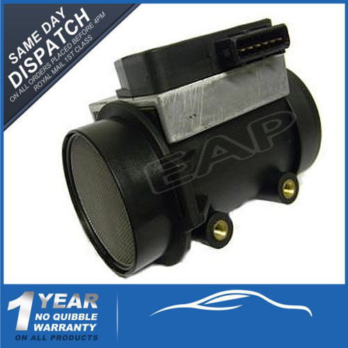

Thanks so much...will send pic tonight. I believe its a Regina...Here is a picture of the same item as on my car - Mass Air Flow Sensor

Pacerdonfl wrote:I believe its a Regina...
Nupe, it would be a Bosch system, as in LH 2.4
Well now, your temp sensor, do you have a part number on the invoice? Make sure its plugged in.
