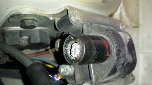

Being that I rarely get to work on my own car (normally I am under a clients - and as they say never by a car from a mechanic), last night the Volvo got a little love.
Besides a fresh change of mobile one,
She got euro side markers (complete with factory harnesses off a~2000 s70)
Remote start with window & sunroof automation, progressive unlocking and I kept the factory alarm in tact.
As far as stage 0 -
I had not inspected the ignition system, and was just going to replace everything (so it is done myself, my way)

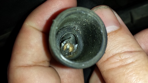

upon connecting the tach sense of the remote start to the coil I pulled the main coil to distributor wire. At which point i realized coil wires are for sissies.
I will now +1 the fact that these cars will run on damaged parts...there is nothing in the way it runs that made me suspect this, even after putting it back together.
98 V70 T5 The fun begins and a stage 0 comment

What is amazing is that your car ran, but if you put on anything but Bougicord wires the car falls flat on its face. The OEM coil is kinda amazing though, I changed out an air filter and forgot to plug the coil wire back in. The car started and ran, albeit terribly, with the coil wire dangling about 3/4" out of the socket.

right now its running Bosch premium cables...when i pulled it apart i thought for sure it was going to be garaged until the new parts came. Could not believe it restarted and runs like nothing is wrong. It is making me seriously question my choice to go with Bougicord and MSD...My head says its the right move and I was going that way for the peace of mind, but what I am witnessing just does not make sense. Now I am considering ordering another set of Bosch wires to go back in (although with my luck I will learn that Bosch wires only work in these cars when they are missing the conductor)

It looks like it broke when you were pulling the wire out, maybe because it was sticking but the conductor must have been intake or a small enough gap to arc across. No majic really.

Mecheng- didn't come apart when i was pulling on it....slipped right off like a properly installed one; like I said, the part that really amazes me is I did the "oh $h8&, let just pretend like we didn't see that" and shoved it back together (while inside thinking no way its gonna start, much less run)....started it up and drove around the block like nothing was wrong. I still don't get it, and I don't really trust it, and the proper parts are on order.
