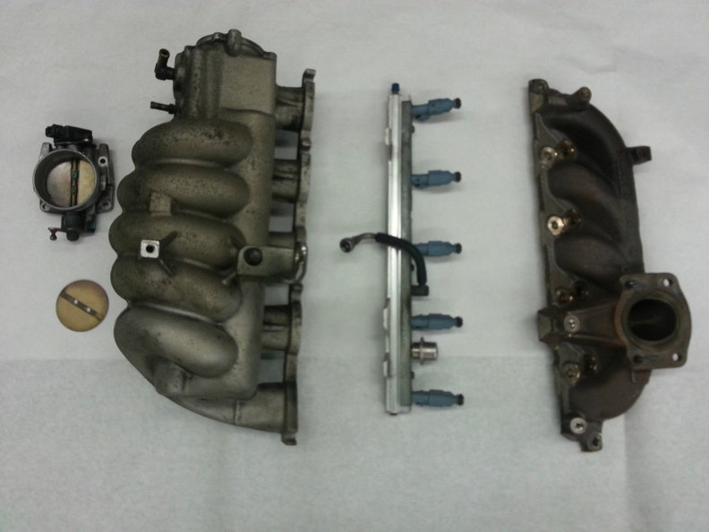

Here are the ingredients for the bolt on swaps.
