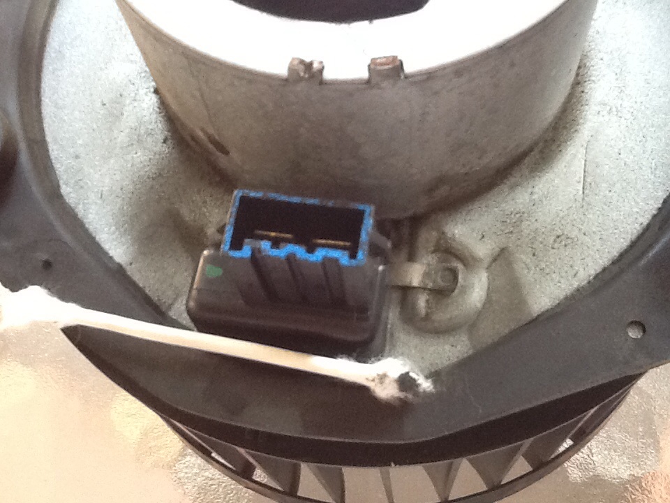

I had this issue creep up recently. I pulled the blower unit out and cleaned it up. Cleaned the crud out of the electric connector. There was a post in the last 3 weeks that showed the tear down procedure. The blower motor in my 2000 V70 is different than the 850s.
