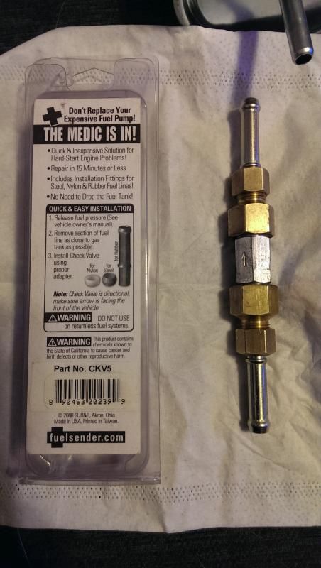

Here is what I recived from an Amazon store. I have a feeling that this was a returned part because the nipples for rubber hose already had the compression fittings attached, and there were no white nylon fittings for hose. I'm trying to see if I can at least get a little credit back, but I'm not worried about it. I purchased a couple of compression fitting assortment kits, seeing that I was thinking about modifying what I had.

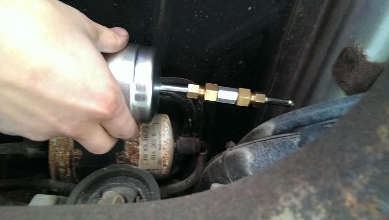

Here is where I was running into a space issue. I wanted to put the valve before the filter because I've seen and read of others doing it that way, and it working.

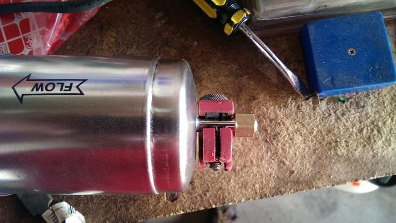

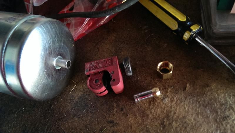

So, to remeidy this, I decided to cut down the inlet nipple on the filter to help with the length.
This is how much I had to work with, which was just enough. I kind of eyeballed it, but it worked for what I was planning.

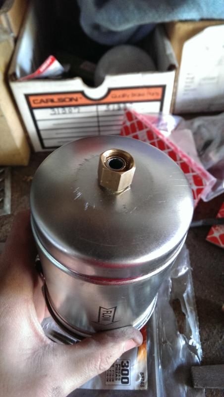

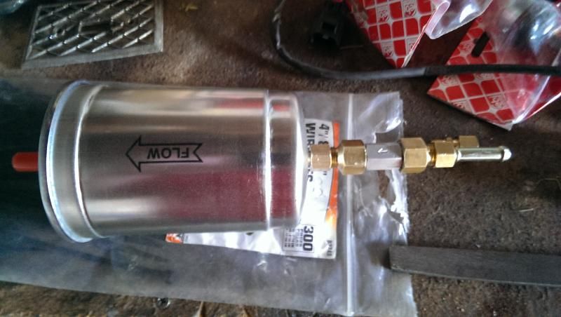

Here is the result with the fitting on the filter. I had to use the end of a union as a drift to hammer the compression piece on the filter without damaging it. ** Before doing this, remember to put the fitting nut on before tapping the compression piece on the filter!** I made the mistake at first and had to pull it off the filter with a pliers. I had extra compression fittings from the assortment packs, so I didn't care that I ruined one piece.

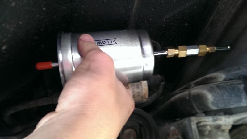

Filter with check valve installed.

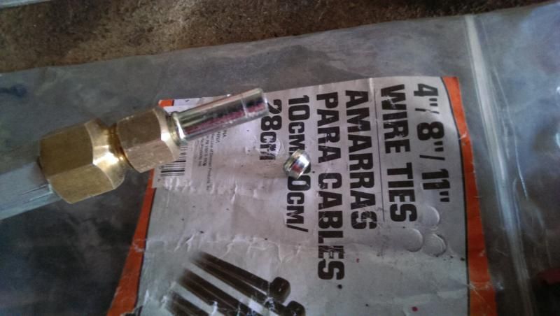

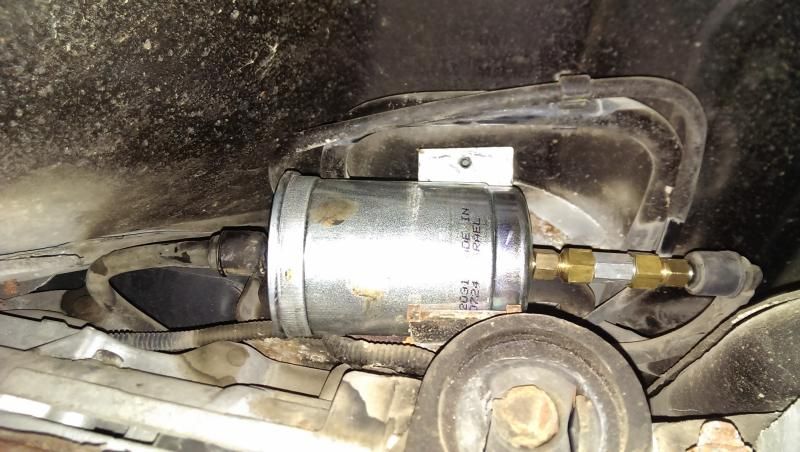

Because the metal nipple for rubber hoses had a flare on it, it would not fit into the stock fuel hose fitting. So, I decided to trim that part off as well.
Here is the finished product. The filter bracket wasn't bolted in yet, but it is now. I didn't have to cut into the lines at all. It fit, a bit snug, but it fit. Hope this helps everyone, and I'm a beliver so far. I'll update next week and let you all know. Thanks!!!
JRL

Installed correctly
