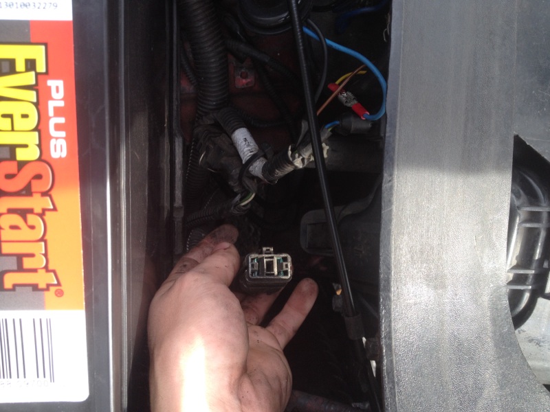

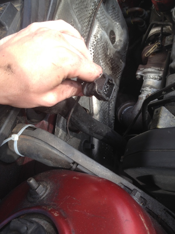

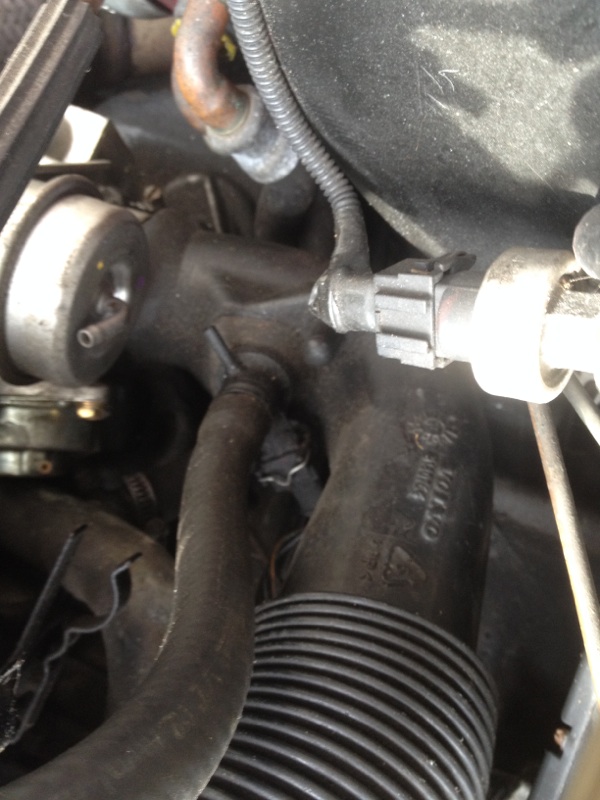

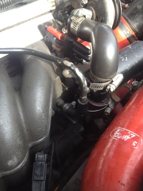

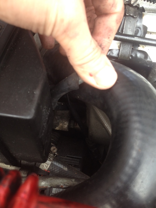

Hi i am new to this sight, i need some help with my volvo s70 t5 that i recently purchased. There are a few wires that are disconnected (i will show in pictures) also ran diagnostics test and the car has a few codes. im assuming the things that are disconnected have to do with it. the codes are P0412, P0443, P0446. Im slowly learning my way around the car and wish to fix myself with some guidance. i understand the purge valve is a big part in evap, and it is completely disconnected. and other things im not to sure of. thank you for the help!
line from manifold
line from manifold
wire near battery and headlight
behind engine
behind engine
manifold tree
manifold tree

Search in the P80 forum (first one in the choices above) for the 1998 vacuum diagram. It looks like you have a bunch of disconnected stuff from the PO you need to sort out.
Obviously, those codes are coming from missing parts/hoses.
