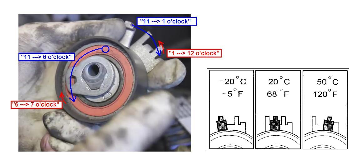

In the video above by the Volvo Tech from FCP:
Watch what tech says between 15:00-16:30 timing markings. It is a bit confusing when the "clock" is mentioned.
Note that there are 2 components to look at:
- The vertical tab that needs to be within the window when all done.
- The 6-mm Allen adjusting wheel, which moves in the opposite direction, i.e., when this moves CCW, the vertical tab moves CW.
In other words:
1. See BLUE arrows:
- First turn the 6-mm Allen adjusting wheel from 11 ---> 6 o'clock position.
- During this process, the vertical tab moves from 11 ---> 1 o'clock position.
- This basically over-tighten the TB a bit to remove any slack.
2. See RED arrows.
- Now turn the 6-mm Allen adjusting wheel from 6 ---> 7 o'clock position.
- During this process, the vertical tab moves from 1 ---> 12 o'clock position, now it is within the window.
- This basically release the TB tension a bit to get correct tension.
Side note: once you are done and have been driving for a while, the engine is HOT. When that happens, the metal expands, the belt also stretches etc. Since the tensioner is temp-dependent, it is designed to move the vertical tab in such a manner that the TB tension is adjusted to the current temp ---> correct tension no matter what temp is is.

Thanks for the reply cn90. I got the job finished (went ccw, 11 to 6, back to 7. Post went right, past goalpost then left back to center). we're driving about 80 mi r/t to see the new XC-90 this evening. I expect the drive to be completely uneventful.
