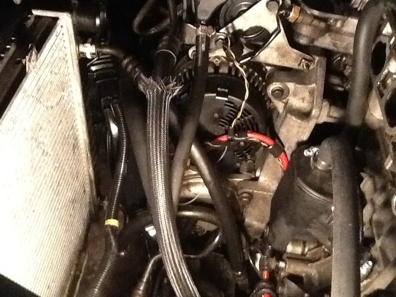

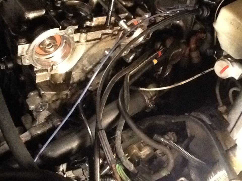

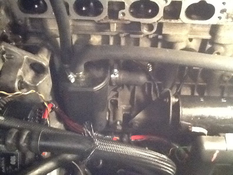

Thanks for the replies! replaced both rear seals with SKF. Just for giggles I installed one Felpro seal and Speedy Pete was correct that the brand does not measure right. I was able to press in the Felpro seal with my fingers. Pulled the cam sprockets on the front and both of those cam seals are perfect.
This $310.00 dollar car was/is very rough. Shot suspension and brakes, massive vacuum leaks, clogged PCV, exhaust pipe cracked behind cat, A/C compressor seized, alternator inop, power steering pump groans with full fluid, motor mounts worn or gone.....just the kind of car I wanted! really enjoy working on these Vols.
Body in great shape, interior excellent, tranny and AWD work great and new tires. Just a little Volvo maintenance. Thanks to this site and the members I would not be able to do this work. Thank you!!
