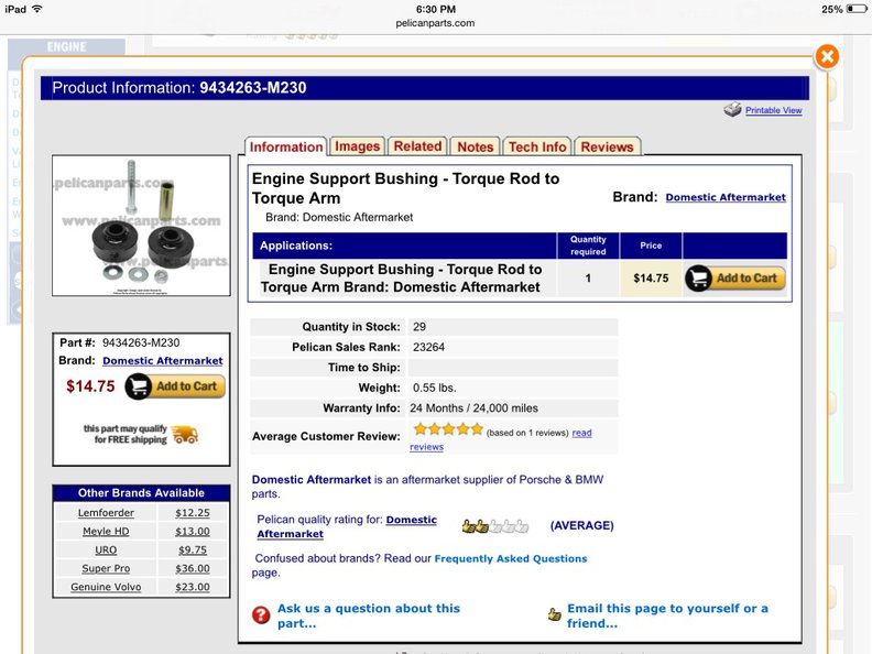

I used this part from Pelican Parts. Installed like a charm and looks to be high quality
Slightly more vibration at idle but my wife didn't notice any difference.
https://www.matthewsvolvosite.com/forums ... e&start=42
- Pelican parts
- image.jpg (175.02 KiB) Viewed 790 times

Inspect each one, if there are no tears then all is well. Lemforder / or Corteco is OEM and cheaper than the dealer part. Pelican Parts list who is the OEM supplier
