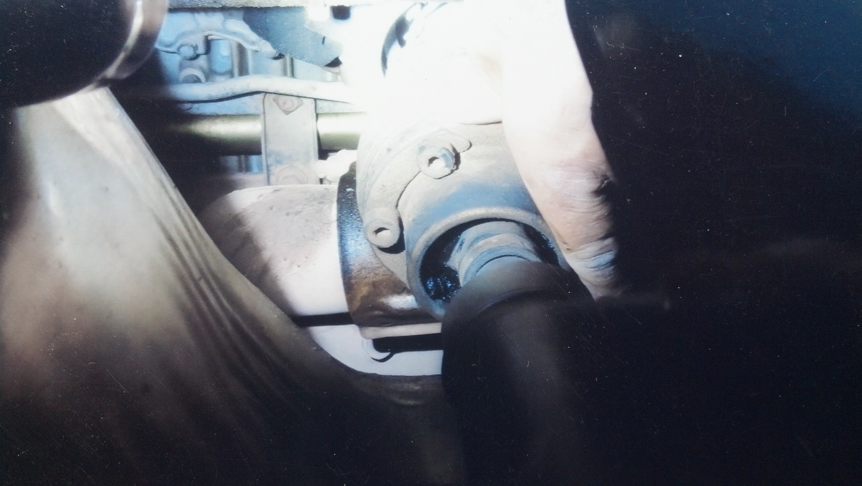

Below is a picture of what a mechanic told the PO what was wrong/bad. To me it looks like the front of the shaft is bad. Am I correct? Would getting a replacement shaft cure this and put this car in good standing for 50,000 miles or so? I live to far away from my aging mother to deal with this stuff once I drop the car off.
1999 Volvo V70 AWD with awd issues

It is tough to tell from the picture. Even a good CV on the prop shaft tends to look bad and you can't really check it for slop while it is installed. Pulling the prop shaft will likely cure any bad vibrations but it doesn't necessarily mean that just the prop shaft is bad since the VC and the transfer case gets unloaded when the shaft is removed. In most cases though, so long as the car wasn't improperly towed, the prop shaft is the "usual suspect".

This has been covered several times before, but this is my view of it:
1) Get underneath and check for oil leaking from the rear of the angle gear (bevel). If it is dry it is a bonus. Doesn't mean it is good as they can have 2 other issues. The drive from the trans to the angle gear unit can fail, and if you grab the rear shaft of the angle gear, try to move it side-to-side. If it moves, then the rear bearing has gone.
2) Prop-shaft - generally 2 issues. If the front bearing has movement when you try to turn by hand, then it needs to be remove ASAP before it causes the angle gear rear bearing/seal to fail. Also check the center bearing and the bearing carrier rubber donut as the perish and fail allowing it to clunk about. Rear bearing tends to be less of an issue. If it needs re-building - Colorado Drive-shafts!
3) VC unit - Front (nose) bearing can fail and as it does it causes a whoosh-whoosh noise. There is also a rubber mount at the front of the VC housing and they fail with age and cause a clunk when gears change or you go from forward to reverse.
4) VC itself. Check for leaks. If car has been sitting for some time, try to drive it gently. When they sit, the silicon fluid inside can settle and allow the clutch plated to dry out and fail. Do a few slow donuts once the car has been driven for a while, turn both directions. If there is a problem you might get some locking up or snatching of the VC unit. Sometimes with gentle regular use it may settle down
5) Rear diff seals - prone to leaking from rear axle shaft seals - bugger to do. I'm going to have to tackle this soon on mine.
6) Rear axles and bearings. Not had muck issue with these, but should still check.
Finally, also check the e-brake cables are good as they are also a swine to do. When I get time and finish putting my car back together I will post a how-to replace and adjust.
When these cars are good they are great. Loved to hate both of mine as they have cost me a lot of money to maintain and improve. Hope you have nothing but blue skies with your mum's new car!

Pull the shaft, measure the diameter of the front CV
with the burnt out boot, call Dave at Colorado Driveshaft.
They can mail one out and you can swap it yourself.
I spent about 100 bucks when the cat cooked mine and
it was no big deal to replace in the driveway. Just like new!
Granted, there may be other issues with the AWD, but for
about a C note, you can find out without too much trouble.

The car has 205,000 on the clock and from what I was told, it was taken on a lot of trips from ABQ to Denver. So I'm guessing a lot of highway miles. Maybe 60%. Not sure if that means anything, but looking at a lot of service records, I seen no documentation on drive train work.
Sounds like I should drive it a little before pulling the shaft? Try to feel and hear what is going on?

Oh, I posted the picture for help identifying the part.
