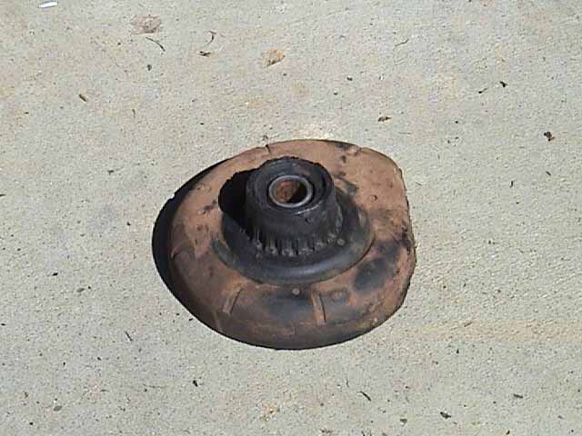

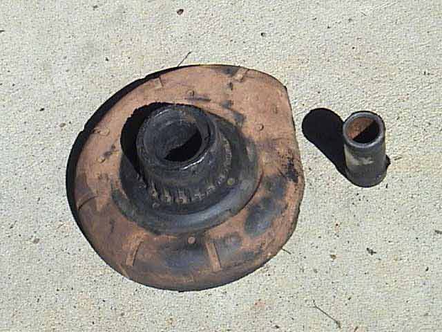

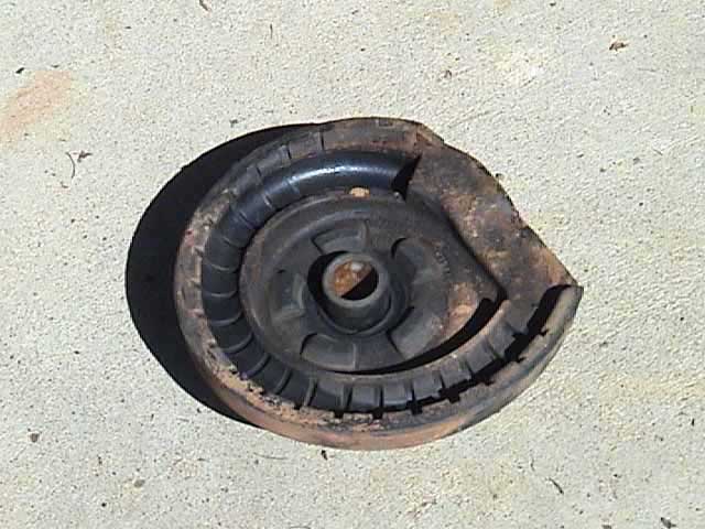

Ive recently investigated into a front end noise that occurs while going over a patch of road that causes all sorts of creeks and groans in the front suspension. I found it to be the spring seats, the rubber bushing around the metal spacer sleave breaks away and gives the strut assembly some 5cm of travel before the shock absorber will do anything. to check the seat, bounce the front end and look at the strut towers to see if there is any dramatic movement.

Pete's sent in some photos of these very spring seats, and they'll be up on this site within a day or two. I'll let everyone know via this thread when they're up.
These are items that should be replaced with every strut replacement, since their lifetimes are about that of struts anyway.

Here they are:
Thanks Pete!

New pics courtesy of Craig. Thanks Craig!
