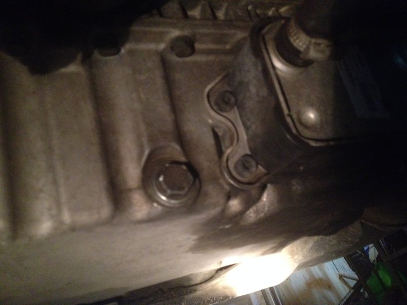

Well, whoever was changing the oil before seems to have not used the plug bolt- It is stuck on! I pulled as hard as I could, and the thing wouldn't budge- started to deform slightly, so I stopped. The plug bolt also just looks too clean to have been used (see photo) so I would guess they must have been doing it by fluid extraction. So it seems like I need to get into a shop where they can get this bolt loose with an impact wrench. Unless anyone has any other ideas, I will be headed there in the morning...
Thank you for all your responses, by the way. Really appreciate it.
