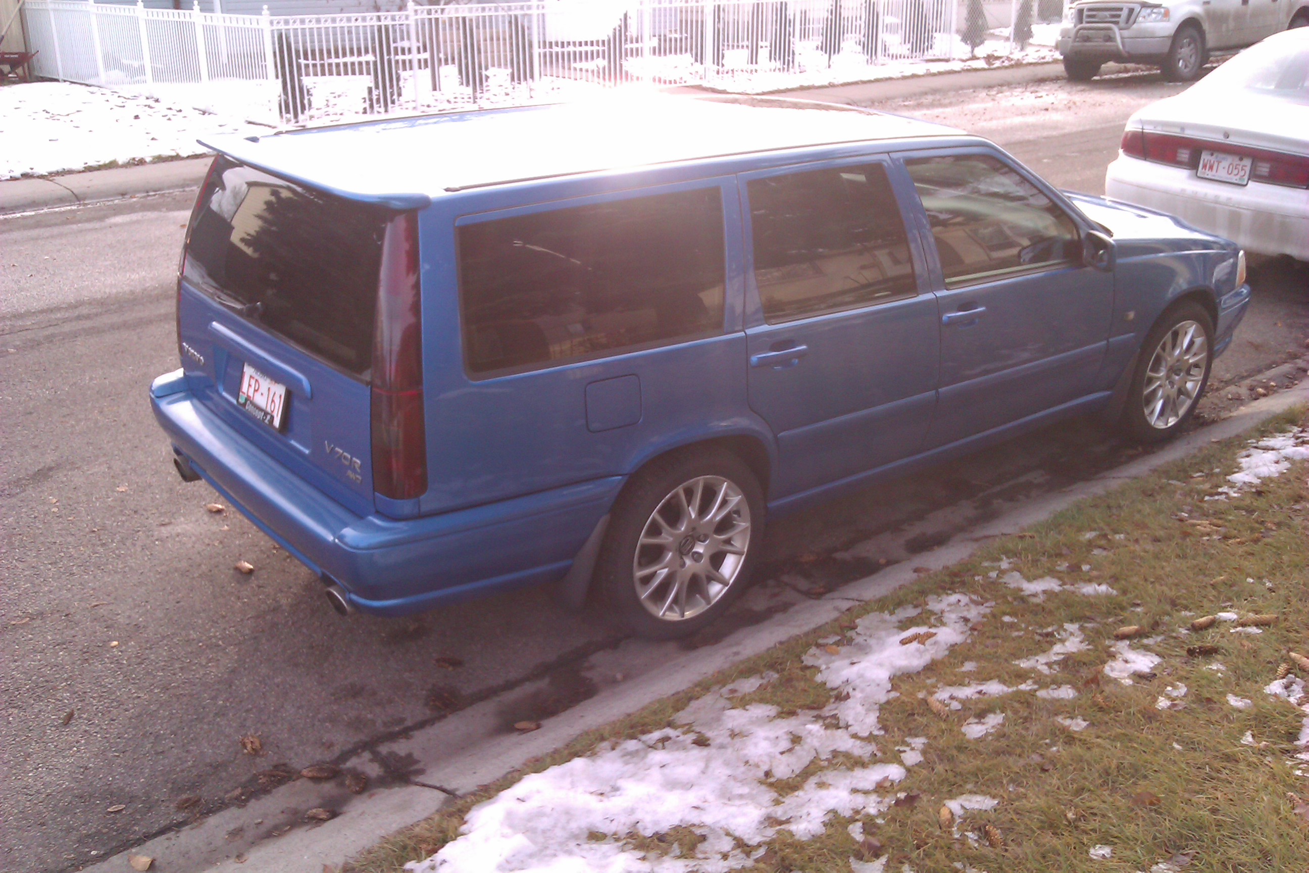

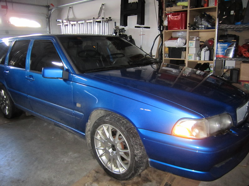

Not sure if this is of help, but I am running 225/45/17 on my 2000 V70R (awd) and not had any issues. I am using Volvo rims from an S60. Although I've owned a 98 V70 XC, I only ran 15's on that, so not sure if it is the same as an R. I know the rear calipers are different, but don't know about the hubs.
But I must make point that I have never run the car with a full load on it, but with Nivomats that should be less of an issue. Are you going to use the same rims? If so, maybe talk to a smaller tire shop and see if they can fit a tire and try it on front and rear and see if you get any rub issues? Cheaper to offer to pay them a few $$'s than buy wheels and tires or just tires and find they don't work.

I think you will be fine with that size. I'm running 225/45/17 with Canisto rims (17 x 7.5) on my 850 and there is only minor rubbing in the front at full steering lock. The rears clear fine. I just bought this car and the wheels were on it.
Your rims are narrower so it should be even less of a problem.

Neil -- Nice looking ride. Pretty badass with the tint, too.
