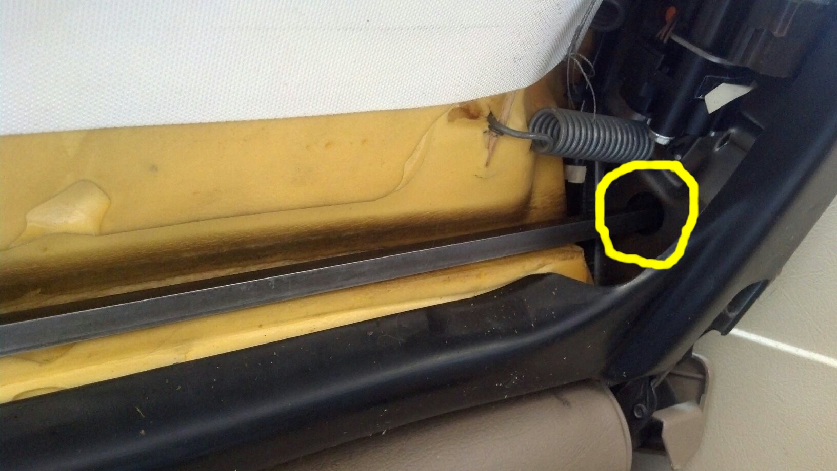

When I sit in the driver's side front seat, and go to put the back of the seat up, the left side goes up and is mobile but the right side doesn't move at all. It makes the seat kind of twisted. Can't figure out what is stuck or if its possibly a cable to the motor? Any ideas?

There is a rod that goes across the seat to make both sides move together. It must have come loose.

Hey Neil:
I just did that repair today. That effects both sides of the seat from reclining. He is saying that one side reclines and the other doesn't move. In that case the transmission or the rod that connects the two sides has come loose.

The rod connects here:
Took me 40 minutes to do this while recording and looking for tools, etc.
