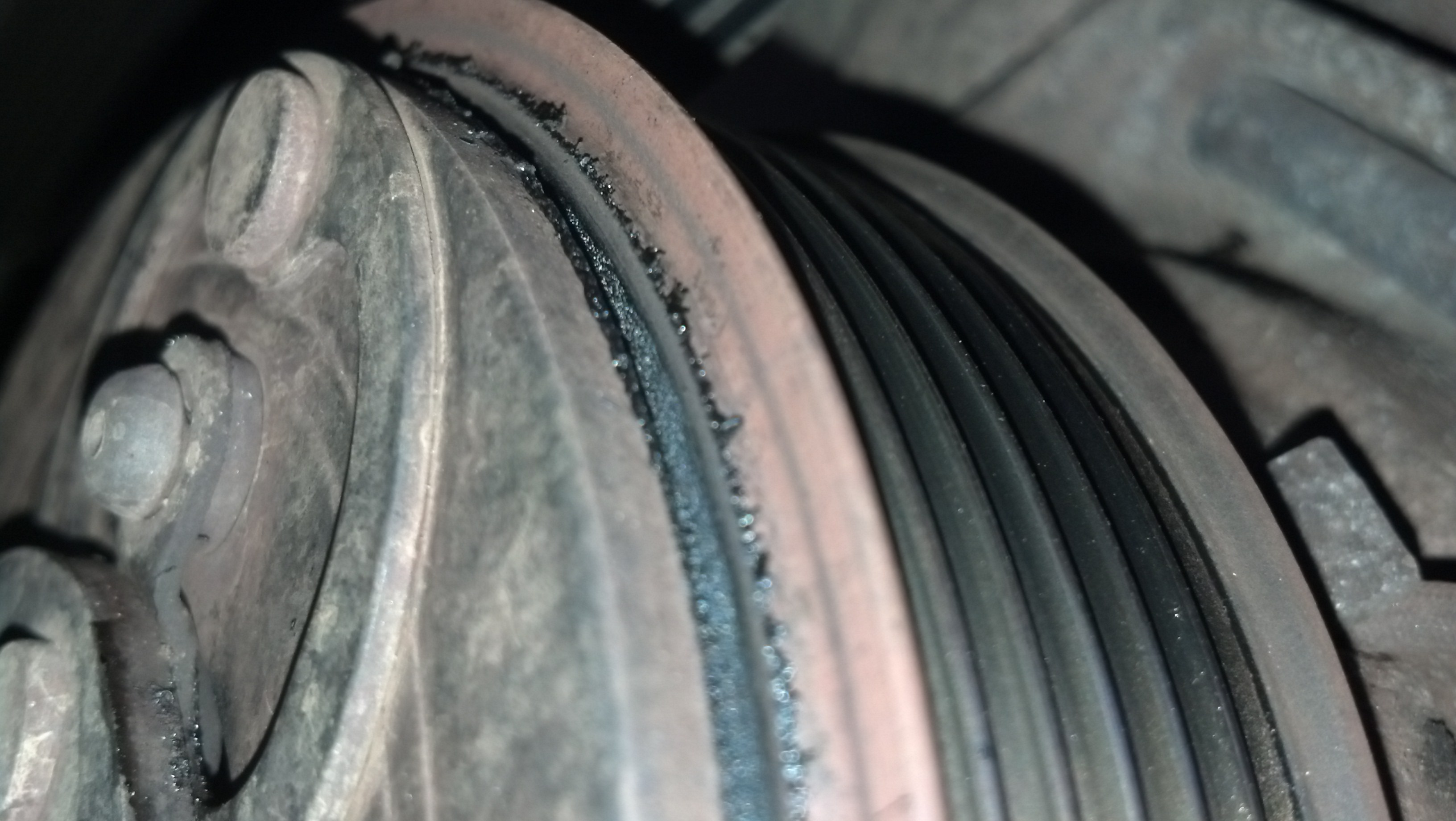

Hello everybody. I'm new here. I have a '03 V70 that stalled out and started pouring smoke out of the hood a few days ago. After towing back to my house, I found the pulley attached to the AC compressor had a lot of black, burned gunk underneath (see posted pic). There was a foul electrical burn smell. When I start the car back up, the pulley does spin.
A few days before this happened, I heard a metallic jingling noise coming directly from there. I thought it was the alternator seizing up, so I whacked it a few times to no avail. The next day when I drove to work, there was no noise, so I figured I'd keep an eye on the alternator and see what happens. Then the above story unfolded.
I have no experience with the ACC. From what I understand, the ACC Clutch most likely jammed up and seized up the pulley. Perhaps the metallic jingling was the clutch plate coming loose and waobbling around?
The big question here is whether I can just fix the clutch and bypass the ACC altogether. On many cars, you can just take out the clutch plate and let the pulley spin freely. On the v70, it seems that you can't even get the top of the clutch off without a special tool. In fact, I can't even get my hands in there.
I want to avoid paying $1000 to 2000 on the repair for this. I don't use the ac, but I know it kicks on for the defogger. I can live without it. I don't have the money to pay a mechanic to replace the whole unit, which he will insist on. Can I get around this? Could someone give me some advice on getting my car operational again?
Someone told me that maybe all I need to do is unplug the acc and the pulley will spin fine. I doubt it, and haven't found any info to back that one up.

If just the clutch is burned out you can disable the AC any number of ways, pull the wire on the compressor, pull the plug on the low pressure switch, or pull the AC fuse.
If the bearing is gone on the AC compressor, you need to source the shorter, non AC serpentine belt and just install it, skipping the AC compressor. Folks with The Volvo software can help here.

Thanks so much for your reply! This has been a bit confusing for me. I did unplug the compressor, and the pulley spins. When I shut the engine off though, the pulley is pretty hot. I can hold my finger to it for about a second. No burns, but it does seem to get very hot. I'm afraid to take it too far. So far, it's just been to the edge of my driveway and back. I rev it a few times, and it sputters a bit, but doesn't stall.
The pulley shouldn't get so hot, right? I suspect the bearing is shot. I don't think I'm going to get off that easy!

Pay an A/C repair shop to replace the bearing in the ac pulley for you.
Or do it yourself with a rental tool for the clutch from Orielly a 10 mm, 13 mm and a set of snap ring pliers.

If the AC compressor seizes, just pull the plug and that will give a code on the ECC control unit, but no harm done.
If the AC compressor clutch seizes or self-immolates, you can't drive the car until you get a belt that turns the other accessories and bypasses the AC.
On 1999- on cars, unfortunately the alternator has to be turned only one way, and all the bypass belts we have located here reverse this, so this is an emergency, 30 mile, get home solution only.
