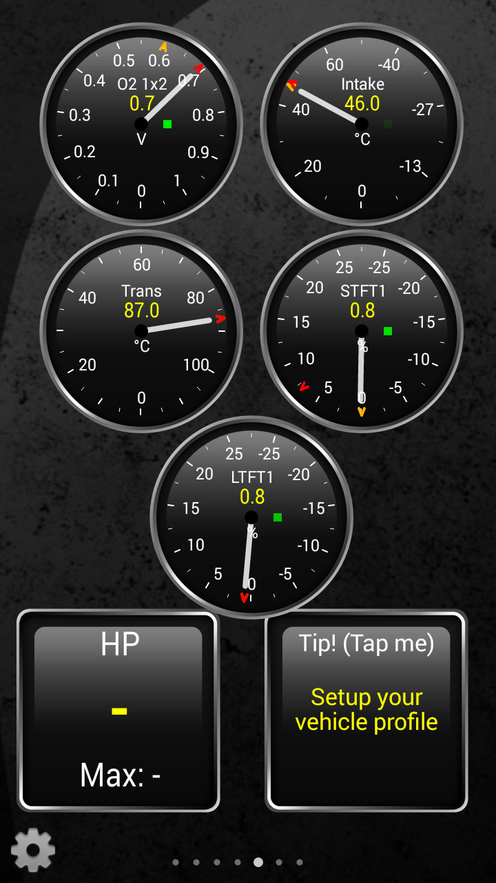

It all started with a mild lean condition, reduced mpg to about 20 (city driving), no other symptoms as far as driveability. Long trim is mildly up, see picture:
Turns out the hose coming out of valve cover into PCV is severed at the "accordion". So after checking out this site's suppliers I went with Europarts. After taking stuff apart, turns out PCV and block ports are pretty clean, along with throttle body. Engine had 74K on it, thank you previous owner for changing oil, etc. Removed parts, like the long hose going back to turbo intake, chubby hose going to the block, were in like new condition so no replacement. Just washing with Palmolive and petroleum jelly treatment. PCV box was clean so it was reused. Intake valves looked brand new, very clean, however several cylinders the stems were brownish, so there is some overheating going on there.

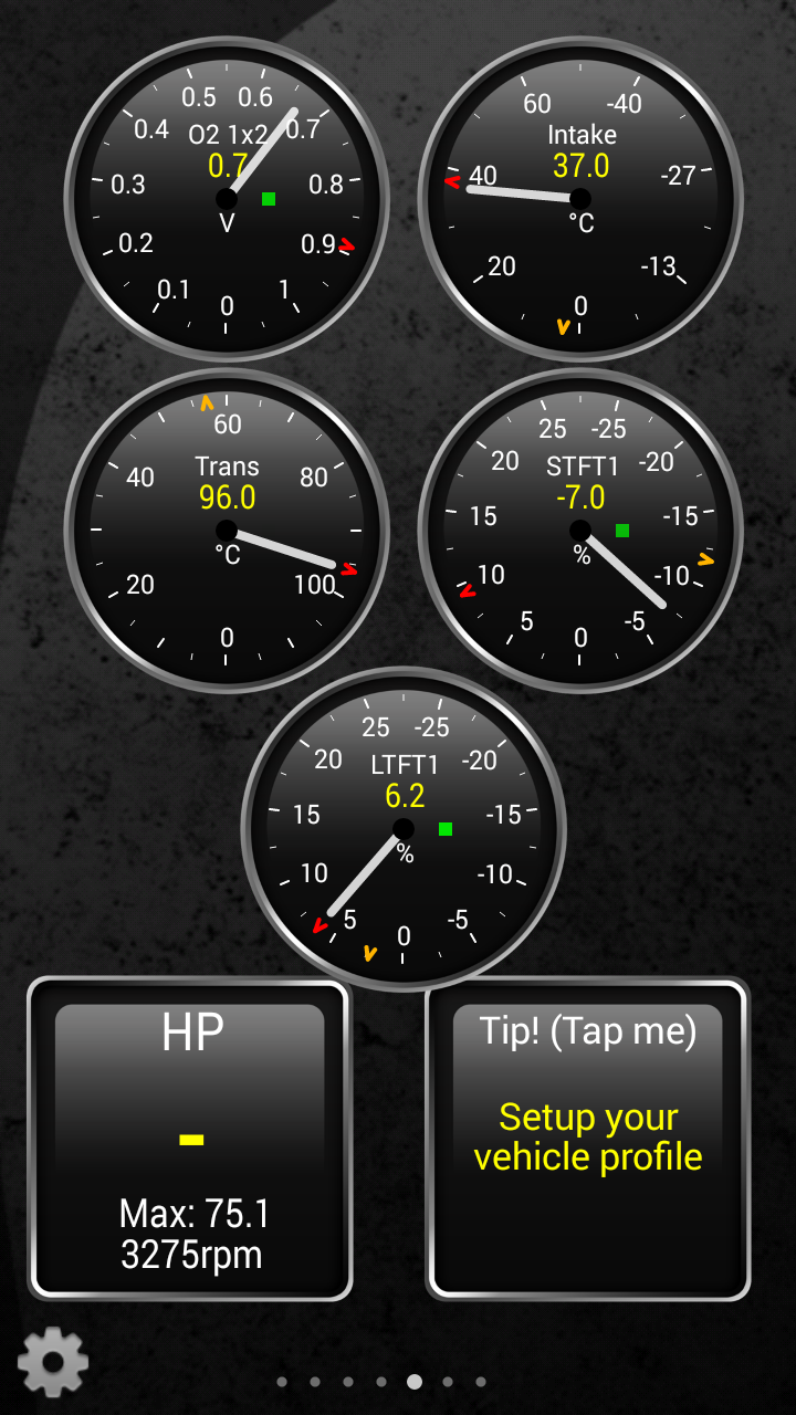

Assembly is reversed to removal, like they say, and here's the long trim now back to normal:
Have done about 200 miles after repair, no leaks at critical points.
