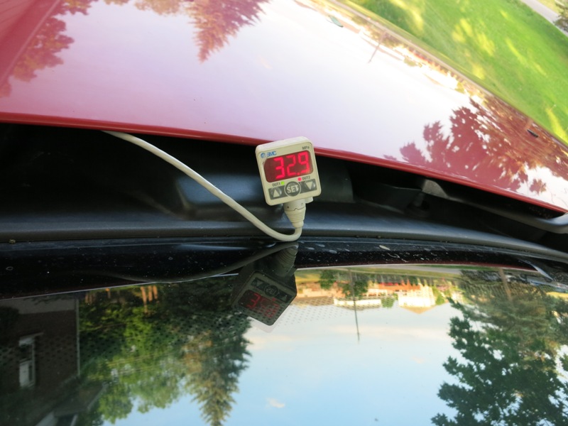

EDIT: Below are details related to my '98 V70. These numbers may not be applicable to '99 and newer due to the change to return-less fuel system.
The fuel rail pressure should be 3 bar (43.5 psi) above manifold pressure. With the engine off, after priming, pressure should show about 43.5 psi, as manifold pressure is equal to atmospheric pressure. After startup, the engine will idle creating a vacuum in the intake around 18-20 inches Hg, or 9-10 psi vacuum. Therefore when you measure fuel pressure at idle, it should be in the low-mid 30's psi (43 psi minus the vacuum value of 9-10 psi). Actual pressure will vary slightly depending on engine load (alternator, a/c), idle speed, engine condition, etc. If you punch the throttle from idle, you should see the fuel pressure spike back up to near 43psi momentary while accelerating the engine, and then drop back down to 30 or so as it decelerates back to idle.
As you see fuel pressure dropping far below that, to the 15-20 psi range, then you have a fuel delivery problem. Fuel pump relay, as already stated, fuel pump, or possibly a blockage either at the inlet to the pump, or in the fuel filter are typical causes. Follow Lee's advice, and start with the relay as it's an easy test and common failure item.
EDIT: Below is a picture of my fuel pressure gauge with engine at idle, a/c off.
