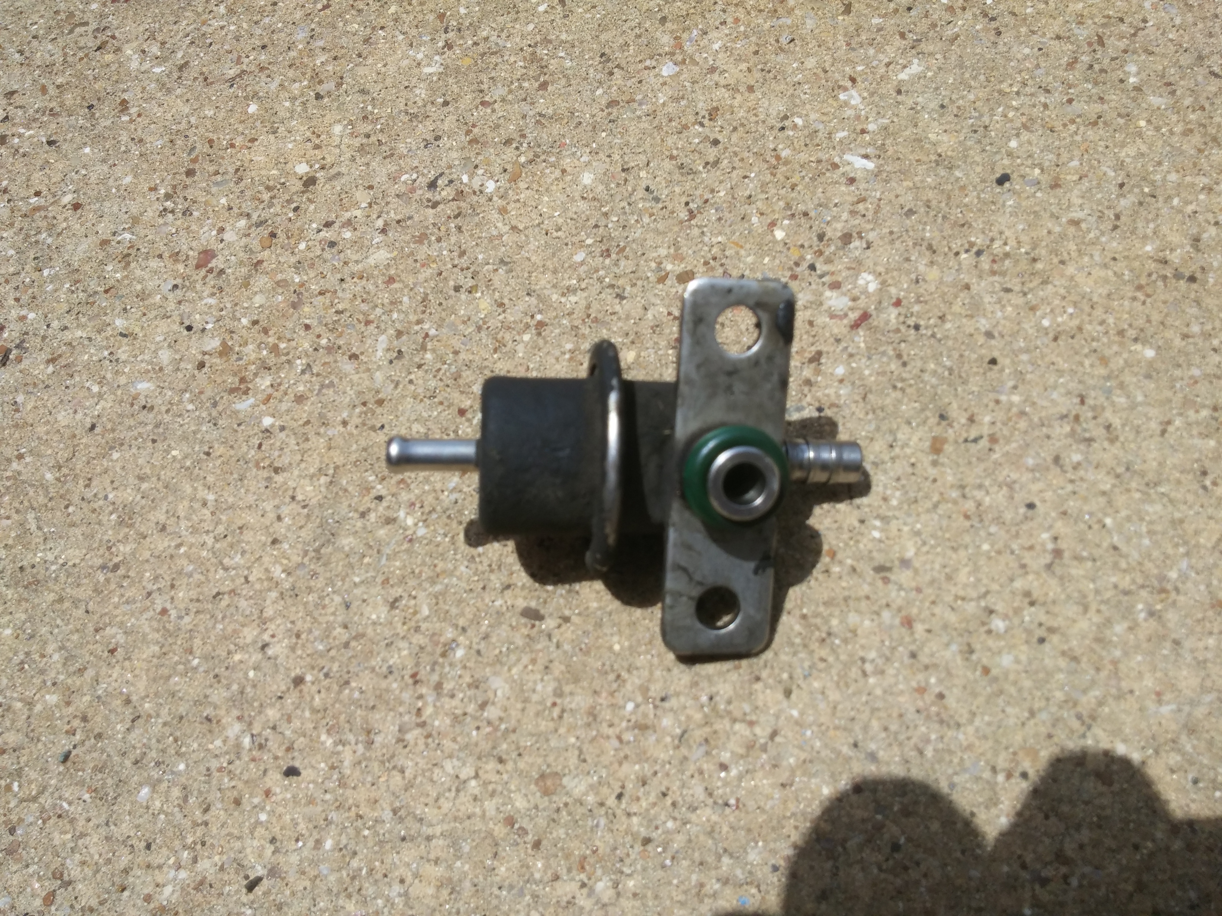

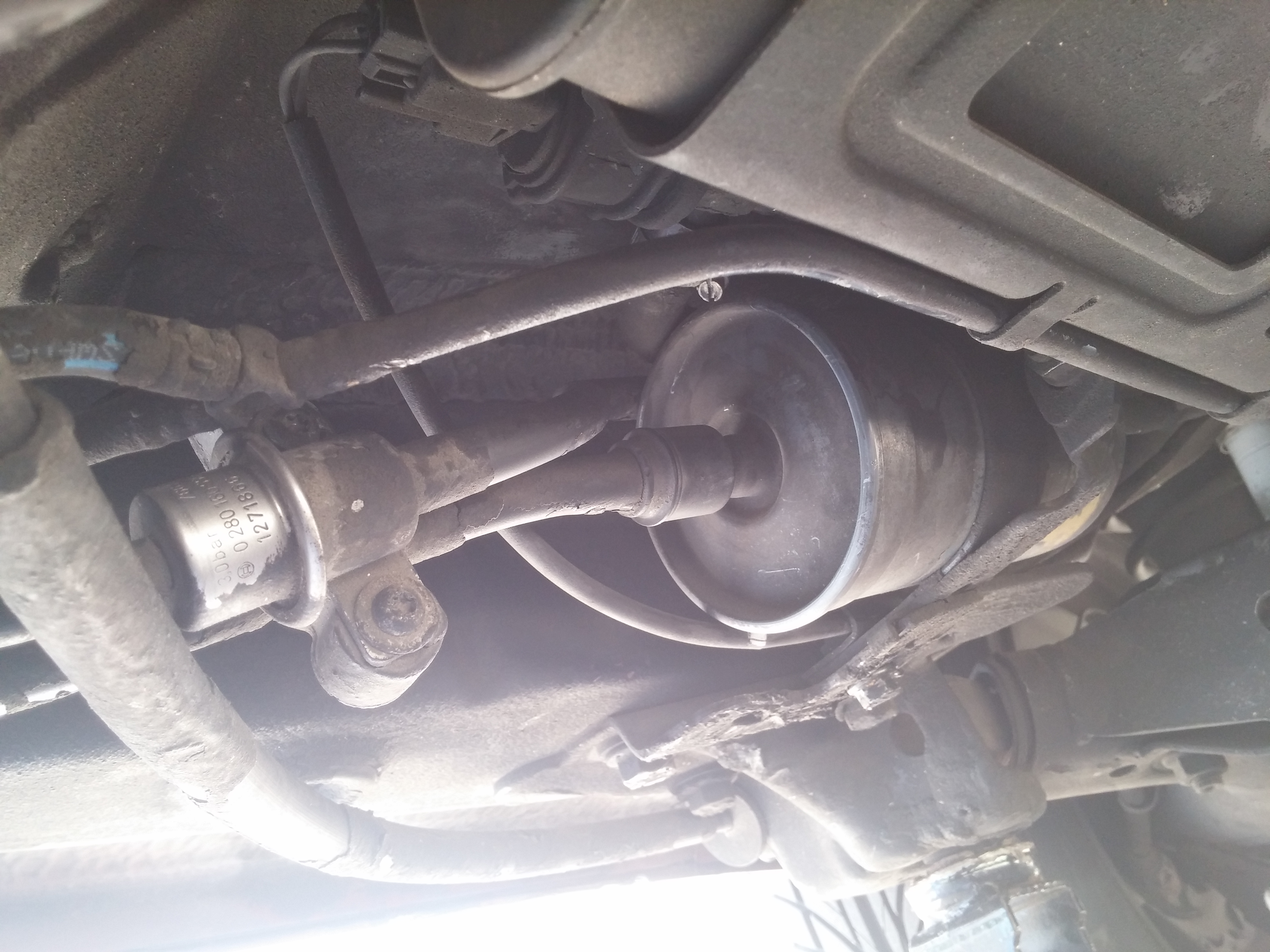

Figured out that the fpr on this car IS NOT in the fuel tank, as suggested for a returnless system. It is in line with the fuel filter on the engine side; both are located by the right rear wheel. The fpr gets its vacuum from the purge valve line to the evap canister via a y-connector; this vacuum line had been previously cut near the engine and had been repaired. The front side (toward engine) of the fpr has a vacuum line and the back side (toward fuel tank) has a double walled fuel line (hard plastic covered by rubber). I'm going to replace the fpr and hope that fixes the problem.

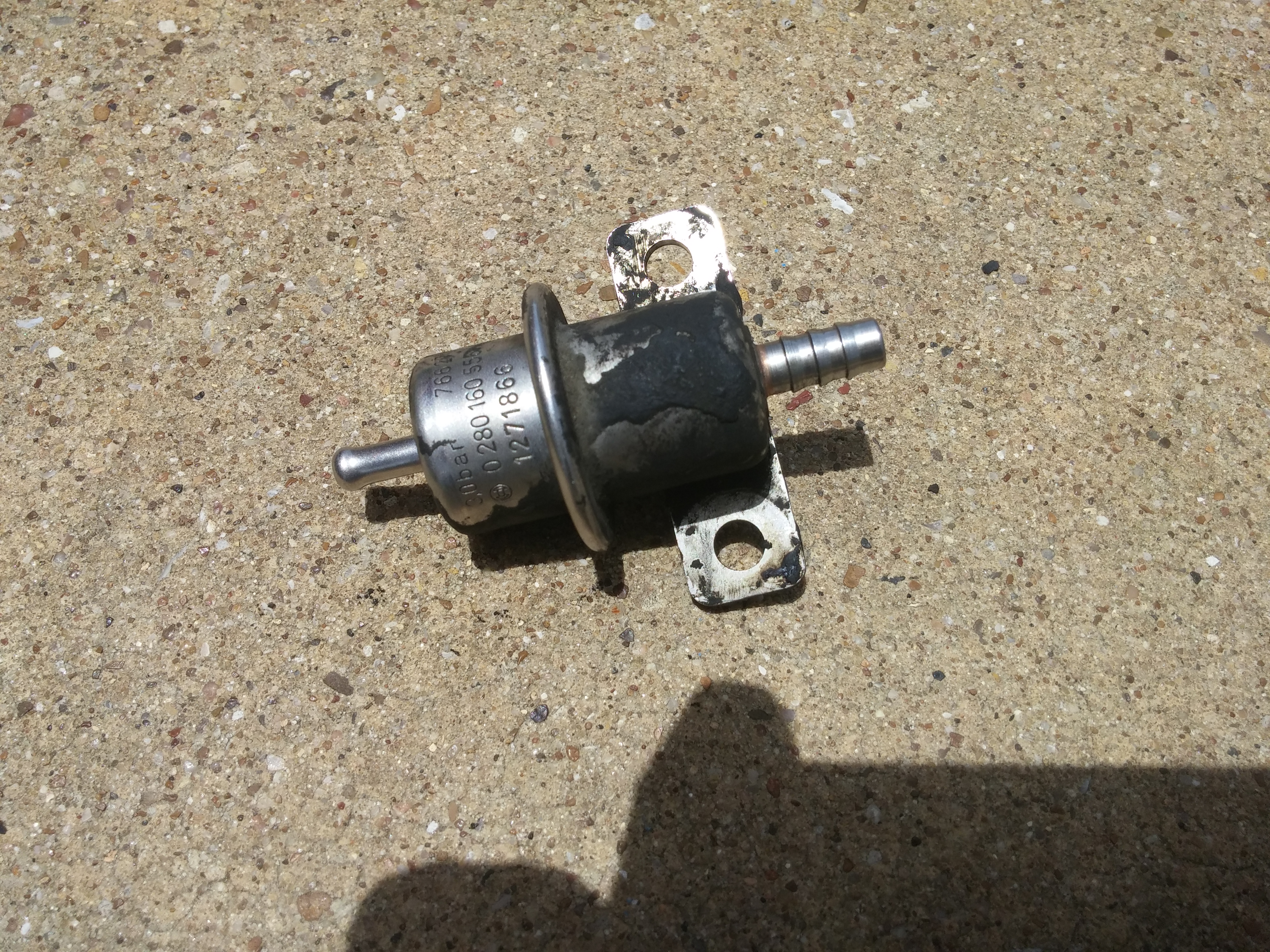

For my car (98 S70 n/a base) replacing this FPR (also called a "CPL" or Capillary Pump Loop in Volvo literature) located just forward of the fuel filter fixed the exact same symptoms that the OP describes (long cranking, weak starts, etc).
I tried asking around for 9445592 at a few Volvo/Euro parts outlets, nobody had one. I tried sourcing just the FPR itself (Bosch p/n 0280160556) but couldn't find a new unit in the US. I ended up googling 9445592 and finding it on CarID, of all places, and it came with the Bosch FPR (0280160556) on it.
