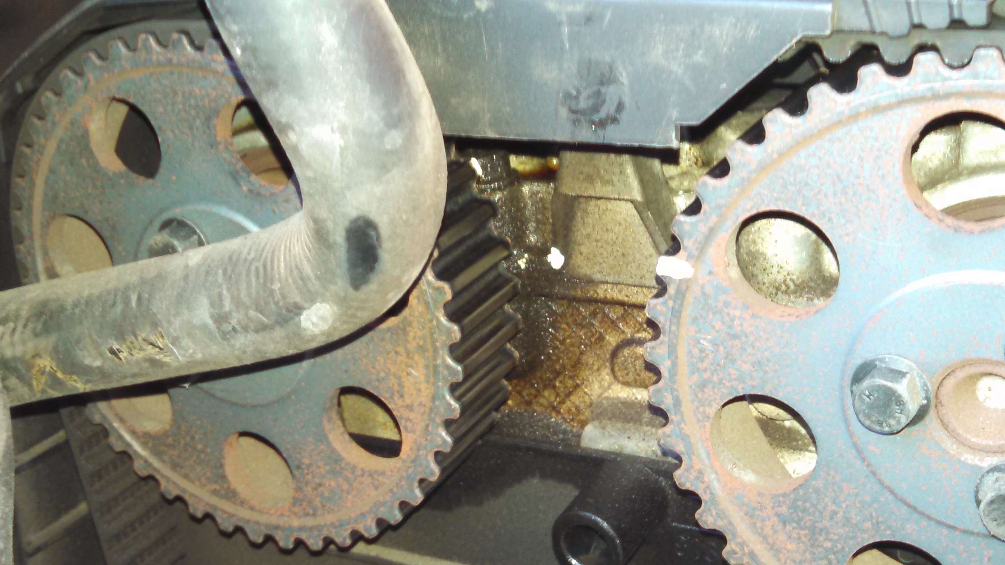

You have a couple of things. I think you correctly identified the leak at the filer which is where you were losing the bulk of your oil. The pictures do, however, also show a small exhaust cam seal leak. It won't get better but it doesn't look like it is leaking a lot, certainly not as much as you had to add.
You might want to try some of the high mileage oil formulations. The "High Mileage" oils have additives that soften the seals and, in some cases, the can stop a small leak like yours. Changing the cam seals is a pain due to the limited space between the front of the engine and the chassis, particularly the strut tower on the exhaust cam.
The high mileage blends don't cost significantly more that the standard oils so even if it doesn't work you haven't really lost anything. It can wait for the next oil change, just keep an eye on your dipstick.

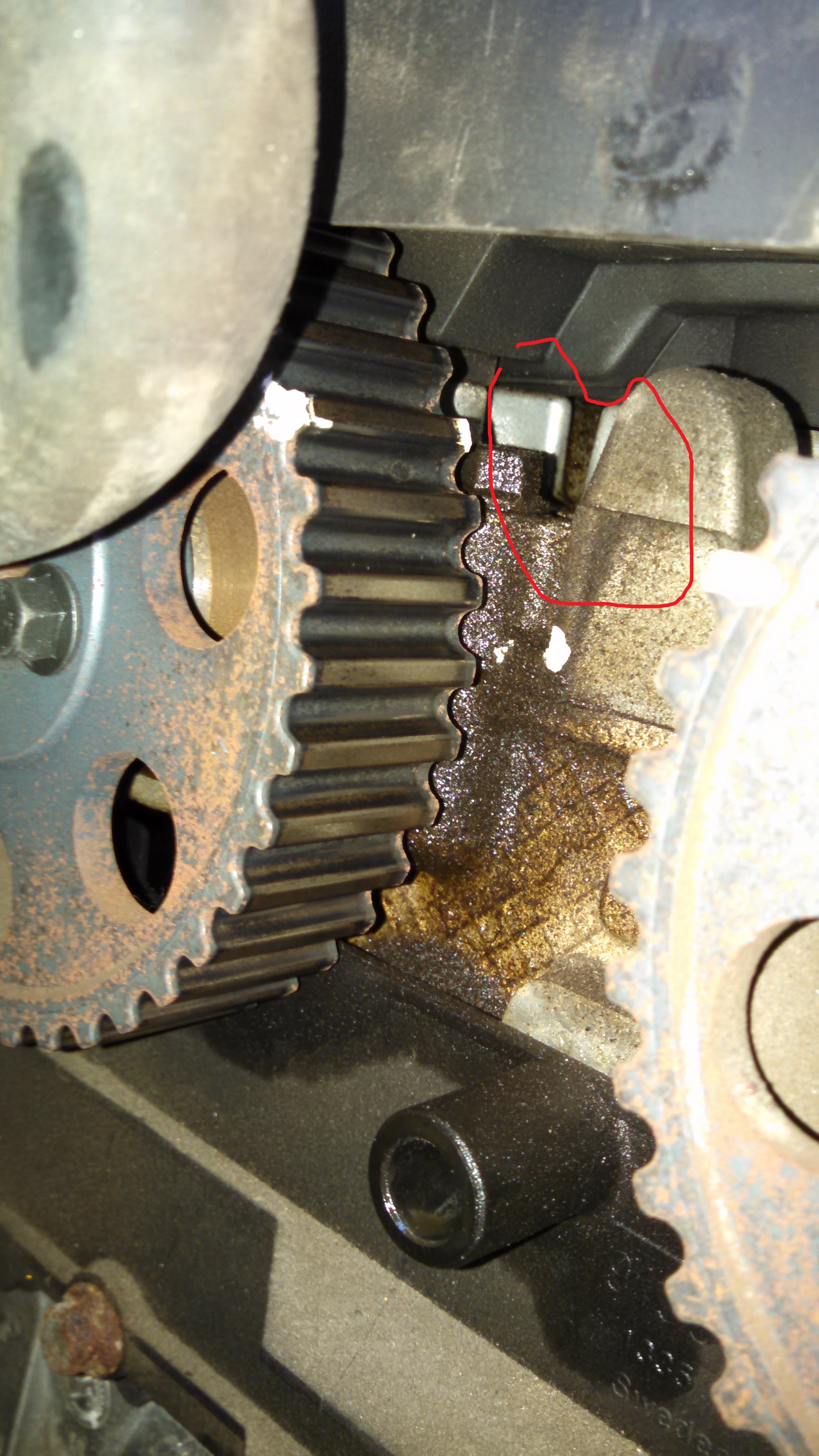

I just did the change, so I'll wait until the next to do so. Given that I don't have the tools to pull the spark plug cover (and I shouldn't really be working on the car at my apartment), does the area under the spark plug cover have a hole that leads to the cam area? I circled this area in the picture attached. I had some oil under the cover, so I'm thinking it might be the case that some dripped into the cam area.Ozark Lee wrote:You have a couple of things. I think you correctly identified the leak at the filer which is where you were losing the bulk of your oil. The pictures do, however, also show a small exhaust cam seal leak. It won't get better but it doesn't look like it is leaking a lot, certainly not as much as you had to add.

I've never really payed any attention to the area you have highlighted, it may go back to the top of the camshaft cover but there would need to be a ton of oil under the spark plug cover for it to get there. The oil under the cover always pools the worst around the filter cap and by there time you get to cylinders 1 or 5 there typically isn't much at all even if the valleys around the center of the engine are full. The picture looks like a classic cam seal leak.

eriscentro: its good that you are doing your own work, atleast from now on you will know the correct ways to tighten the filter and the drain bolt. don't want a different tech guessing each time. as already mentioned, the oil cap can leak, and I usually pick up a half dozen or so of the seals and put one on whenever I see oil ontop. Also, the drain plug needs to be snug, but not too tight. A box end wrench works better than a small ratchet if that is all you have (like a 3/8). You will get a feel for it as time goes by. The picture you posted above, if there is a lot of oil underneath the spark plug cover, it might be able to weap down into the timing area. Find a torx 25 and lift the spark plug cover off (it is decorative, maybe a minute or two to remove), and you will see a flood of oil probably. Clean it up and drive on.
