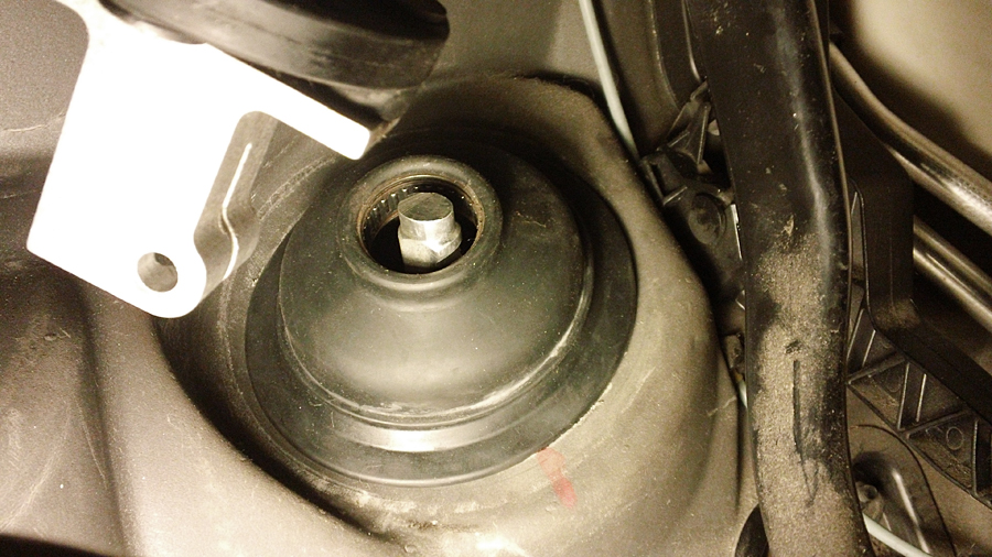

It is much simple to service u-joint from inside the car.
You can twist the rubber boot CCW to pull off and then access the u-joint.
For reference
More here https://www.matthewsvolvosite.com/forums/viewtopic.php?f=1&t=54721
For reference

thanks...skimmed the link.
How does one know the u-joint is bad vs. steering rack worm gears? Is it pretty obvious when you pull the boot out or do you have to wiggle something to figure it out?

To check the u-joint, you will need to remove a 14mm bolt from the steering column, under the dash (easy to do). Then you can remove the rubber boot (it has a large retaining clip at the base), and the u-joint will be free to rotate by hand, it should be easy to rotate in all ways. While there, also check the small bearing inside the rubber boot for smooth operation

Thanks. Should the front end be up or wheels off to facilitate turning things by hand?oragex wrote:To check the u-joint, you will need to remove a 14mm bolt from the steering column, under the dash (easy to do). Then you can remove the rubber boot (it has a large retaining clip at the base), and the u-joint will be free to rotate by hand, it should be easy to rotate in all ways. While there, also check the small bearing inside the rubber boot for smooth operation
