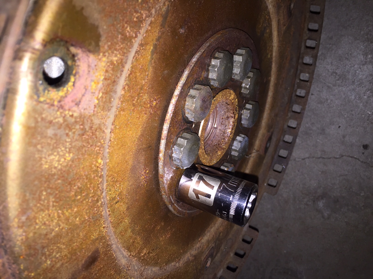

Do you happen to recall what size 12 point socket those flex plate bolts require? I've heard conflicting info on the net. Thanks.

Ditto. I have only done two RMS jobs (do the front/input seal on the transmission too, while you are in there!) but reused all fasteners. Cleaned 'em up and used loctite red.
use a 12-point, 17 mm socket
