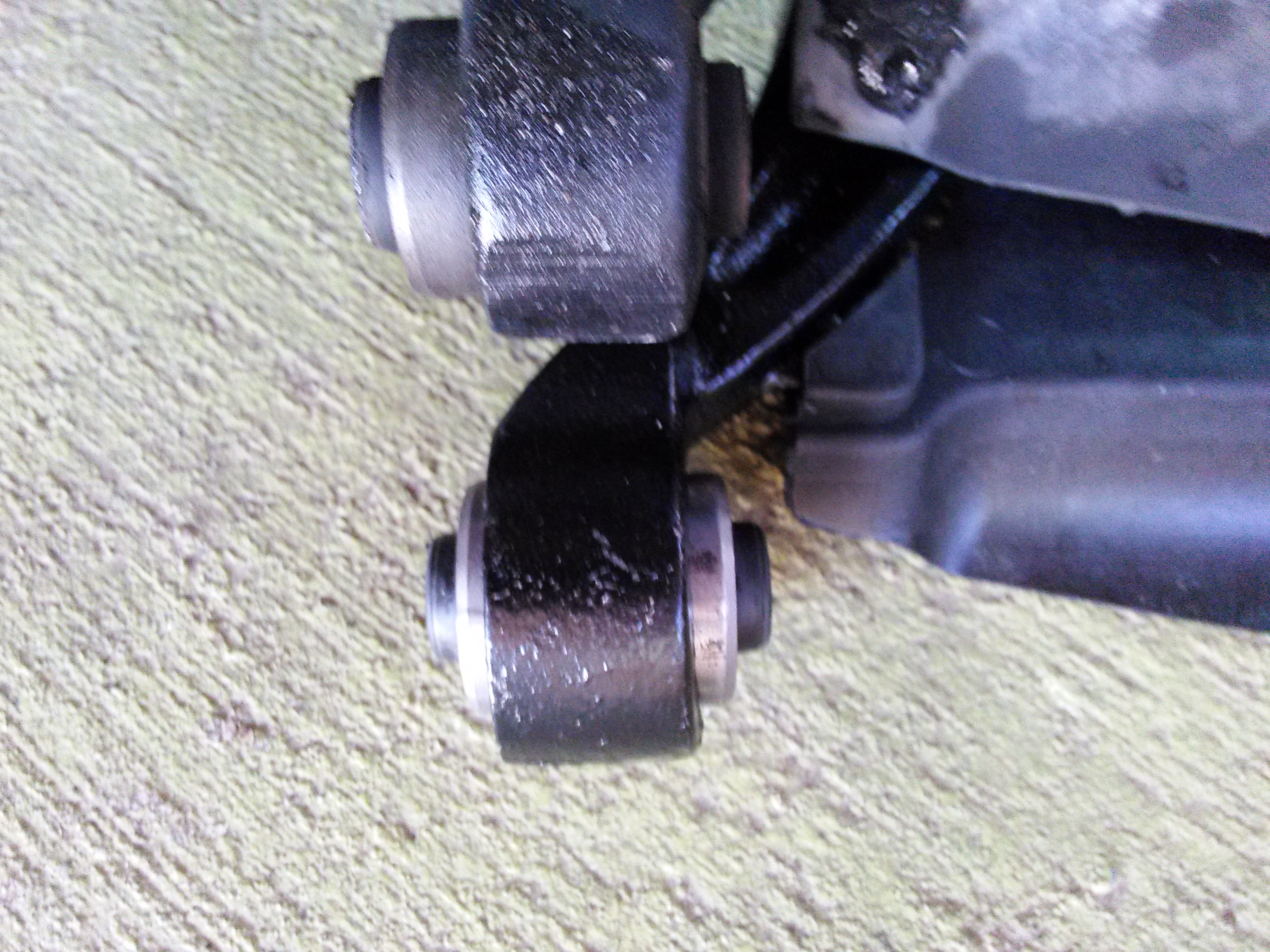

Here you go guys, thanks for the replies. The new control arm is on the bottom.

So on turns, the above picture, the sway bar touches the control arm? And the new control arm did not solve the issue?
In the times I have hit curbs, my alignment was off and I felt wobbles in my steering wheel too. It is hard to tell in the pictures what else is going on. Anything else look off kilter? Are you sure the new control arm is installed correctly and everything is reconnected? back up and re check things you might have overlooked

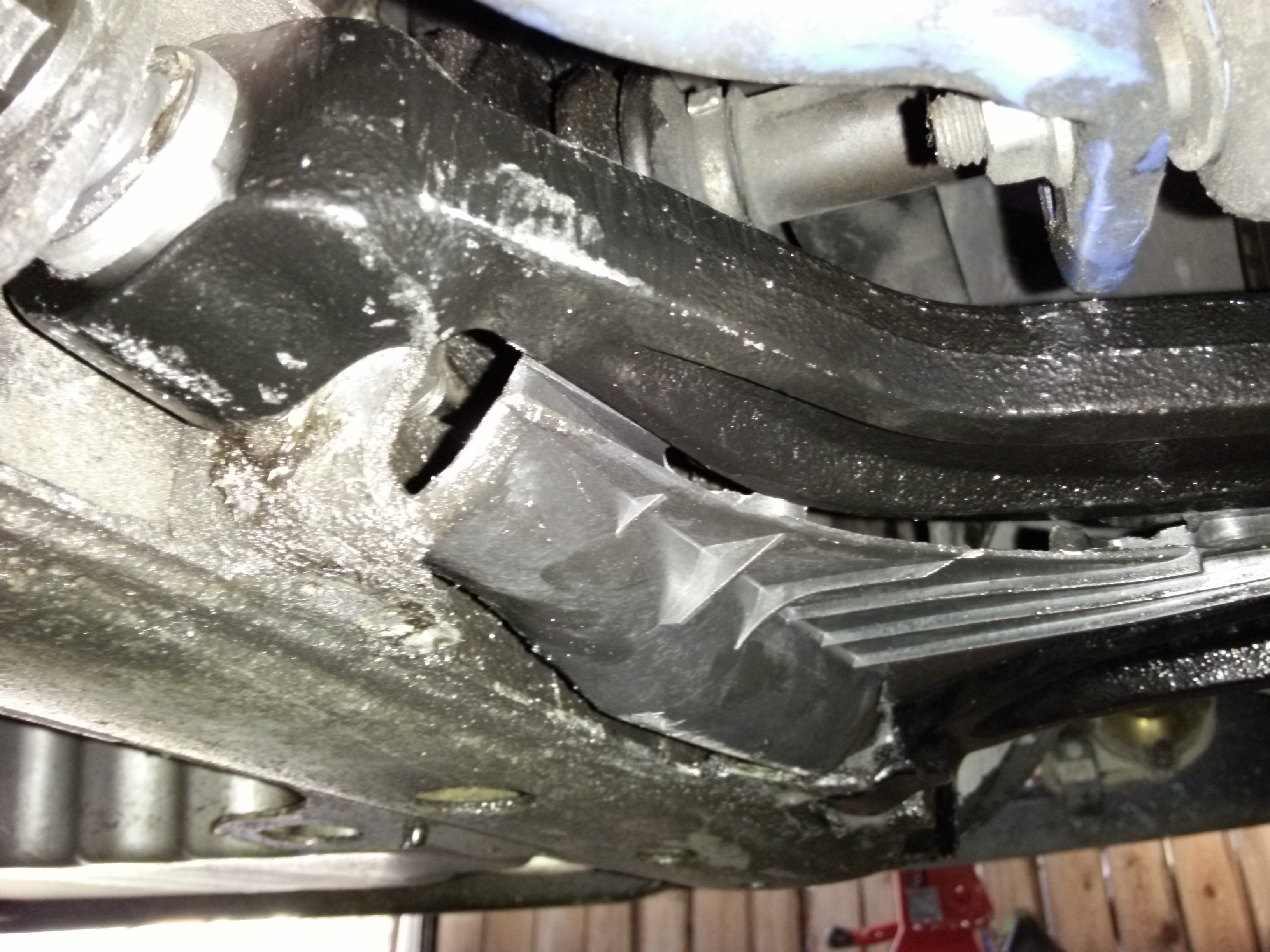

Can you show a pic of the sway bar touching the control arm? I doubt this will solve it but I am curious.
Did you check back in toward the sway bar bushing, is the sway bar properly attached to the subframe? And the sway bar end link, those are not very beefy.
