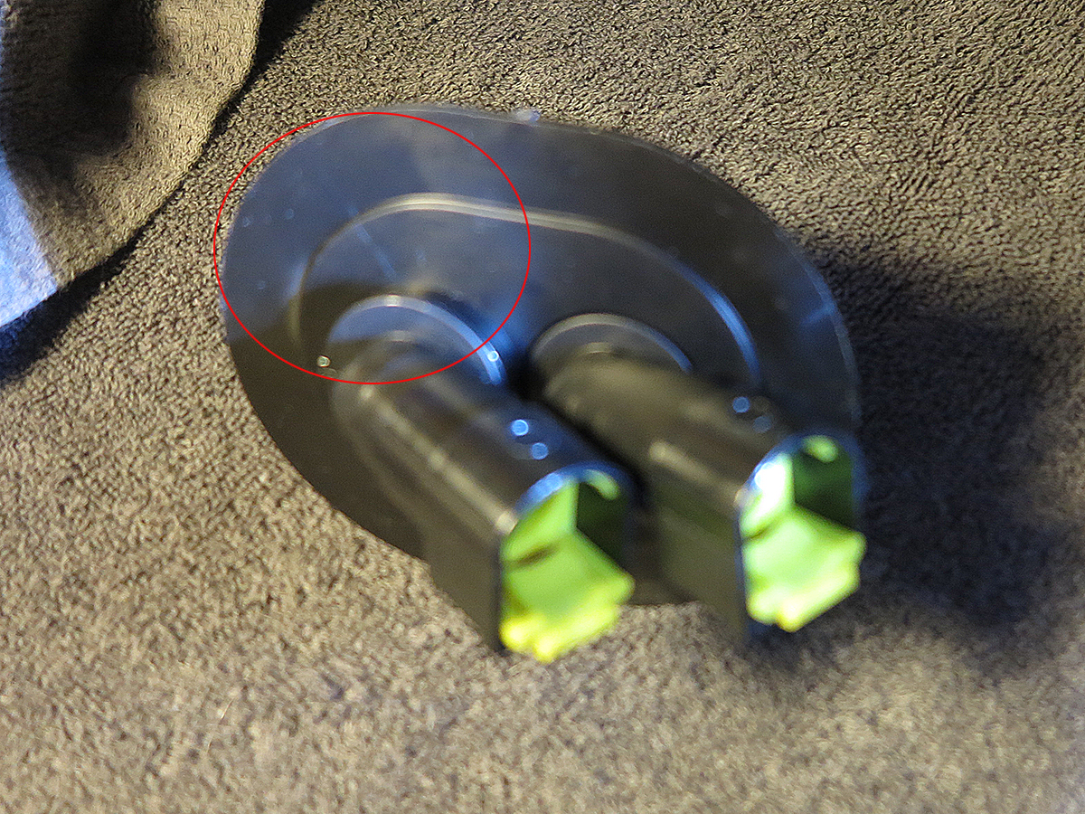

Few photos...
New coupler had a hairline, so asked Volvo for replacement.
The replacement has hairline too, but different location. No nail catch. Volvo parts says, it is safe to use.
Any feedback.
New coupler with hairline - not a crack

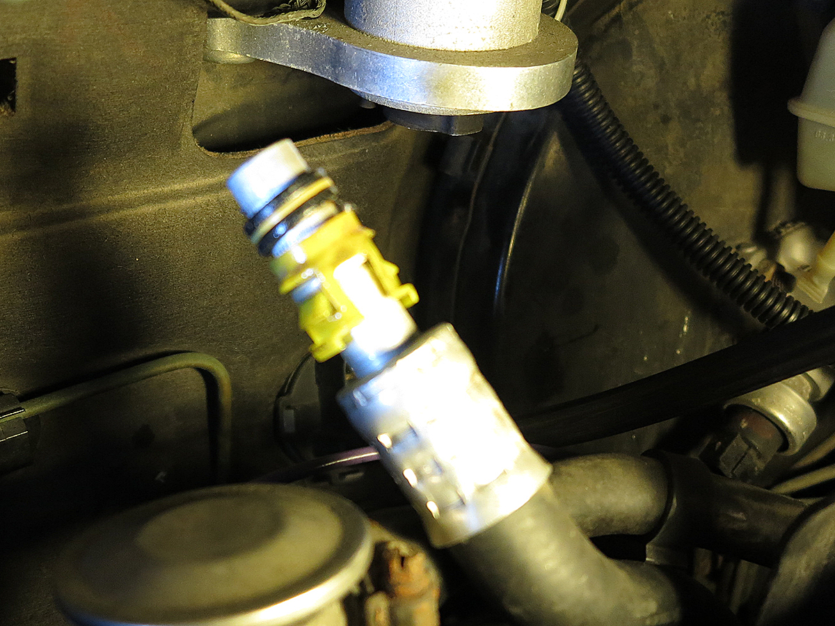

Pulled out the two hoses at the firewall junction, lower hose came out with broken coupler piece. The upper had a visible leak. These hoses are more than 3 years old, but look fit. Which one is inlet?
upper connection
upper connection
lower connection
lower connection
