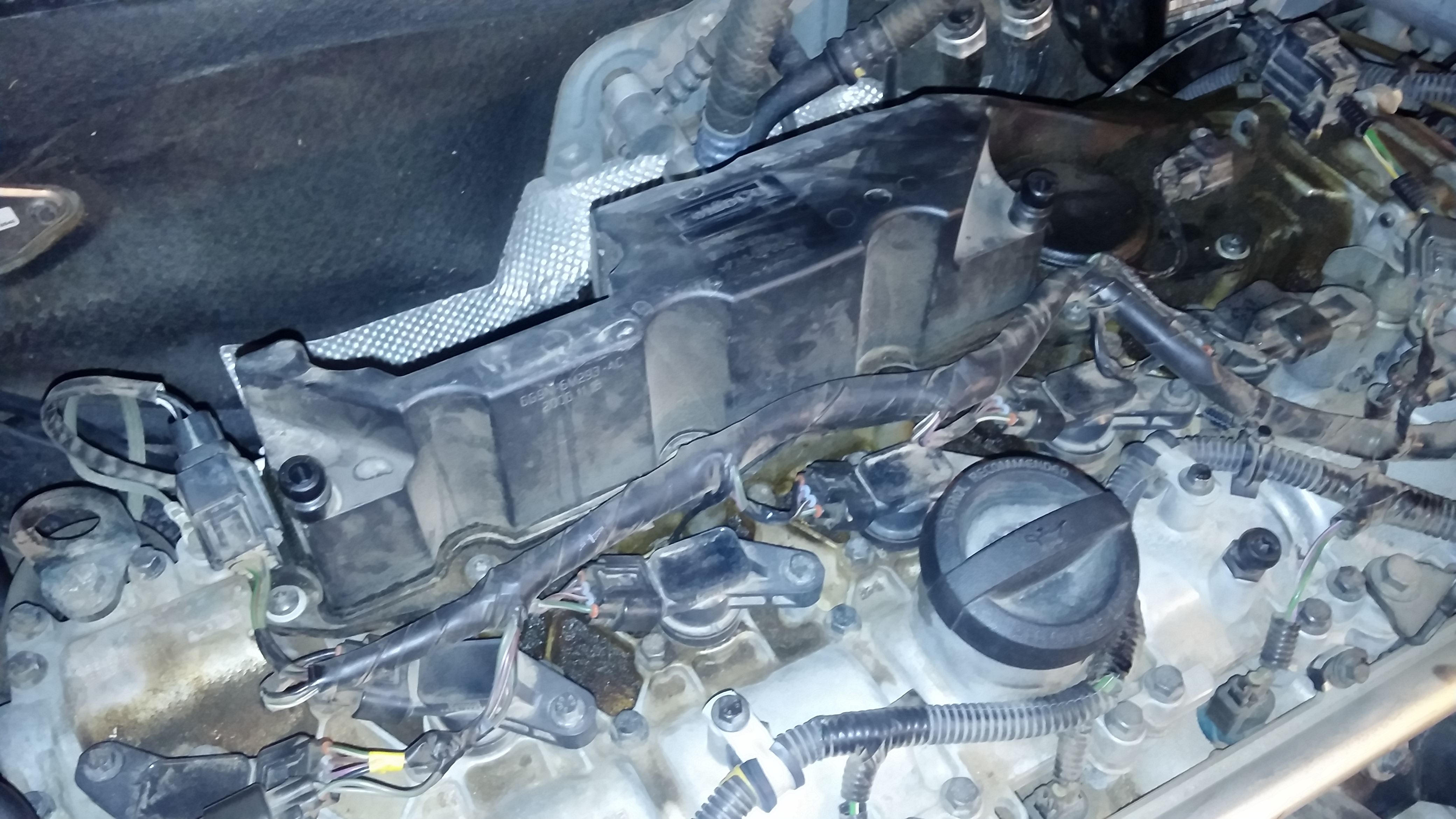

Did you guys ever find the part to replace just the pressure valve? I have oil leaking as well but it is all around the vavle cover. I've bought the valve cover gasket that fits it and will install in next few wks. Originally I thought it was just brake vacuum pump and I rebuilt it with the kit, but I still noticed oil leaking last night, it's noticable behind the motor in front of firewall. The fresh oil is getting on the plastic ribbed electrical wiring cover which is why I figured it was the vacuum pump leaking and getting blown behind there. But there is also loads of old oil all over the top of the motor (SEE PIC) . and it seems to be coming out around this intake. This and one other thread is all I could find on the subject. I know its old but I just thought I'd add to it. Thx in advance!!
oil around cam/valve cover/PCV
Turbo_Boss
Posts: 55
Joined: 21 June 2015
Year and Model: 2008 XC90 3.2AWD
Location: Panama Rep. of Panama - Central America
Has thanked: 12 times
Been thanked: 2 times
Post by Turbo_Boss »
Hey Saabfisticated.
I tried to just get the pressure valve diaphragm but nobody sell it alone.
Assuming your diaphragm is damage, I am pretty sure you have the malfuntion indicator light on your instrument cluster letting you know ther is a problemo.
Also, if this part is damage you will have more fuel consumption
Is this is your case, you will need to get the complete PCV OIL TRAP – VALVE COVER Part No. 31319642 http://www.tascaparts.com/oe-volvo/31319642
This part already come with the gasket so I recomend you to send back the gasket you bought and ask for a refund and then order the TASCA part.
I bought it on http://www.tascaparts.com/ and the part was around $150.00 not including shipping & Handling. They have the best price.
