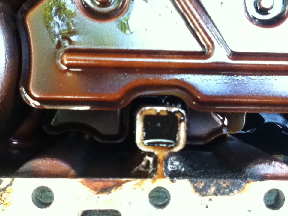

I have a 2002 S80 T6 w/165K. The square drain for the oil trap drain was 100% blocked when I bought the car. I pulled the oil sump and cleaned it (write up will be listed below as well). I had no indications to any oil pressure issues before I pulled the sump. I now have below allowable oil pressure at idle once the car is warm. Current oil is a 20w50 (not my usual 10w30 synthetic). The dipstick appeared to have a few very small bubbles in the oil on it. The following oil pressures were taken with the engine at 165 degrees to start and was 190 when done.

I have pulled the sump off and I would like some advice on the "valve" part # 463963 #19 in the Lubricating System Part Schematic. This screws into the sump and goes between the oil filter chamber and the sump itself. I can blow air through it without using any force at all. 1) Is this normal? Neither of the two local dealers carry this in normal stock and do not remember ever selling one. Also, 2) can anyone explain what the purpose of this part is? It looks too small to be an oil pressure relief valve. I will special order it tomorrow and see how the new one acts.

It does not appear that I mis-installed any of the O-rings, or any other signs of an issue on my part. I currently have the sump removed. I used Loctite 518 to seal the sump to the block. 5) Does anyone have any input good or bad to this?

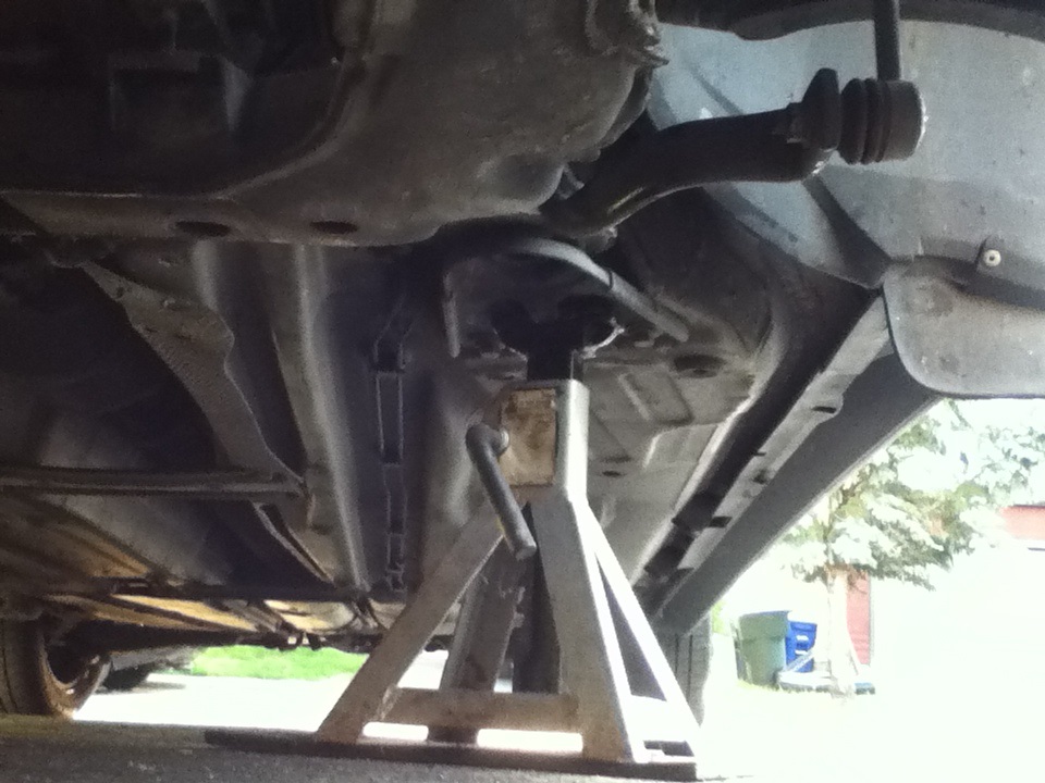

Raise the car and place a jack stand under each of the rear sub frame mounting plates (picture below).

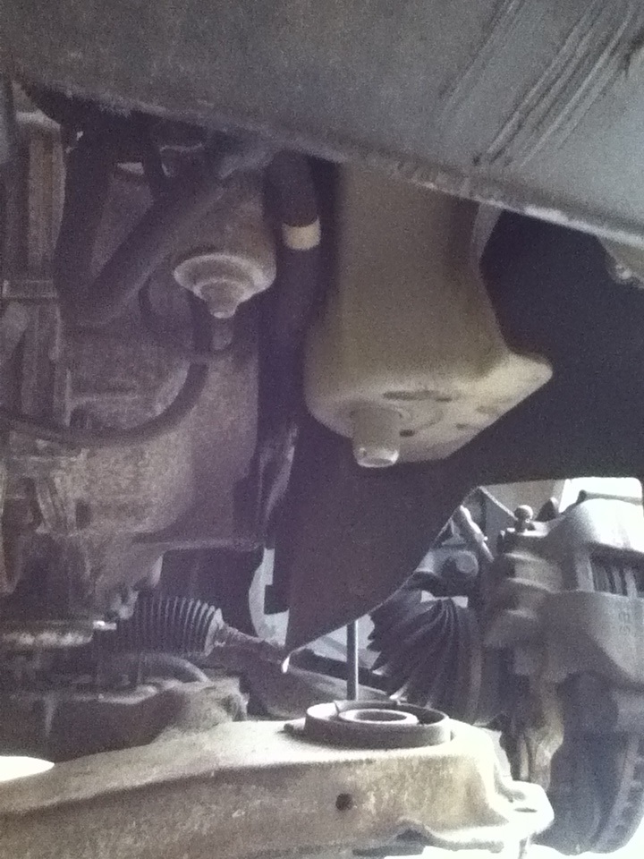

You should now be able to put a jack under the front of the subframe and start to lower it. Be careful as you may not have disconnected everything. Lower slowly and double check.
The rear mounts never come out and act like a pivot for the subframe. You want the front of the subframe to drop about 10-12 inches. This allows plenty of space to remove and replace the oil sump.

Rear subframe mounts jack stand: Subframe drop: Original reason for this: Hope this is useful,
