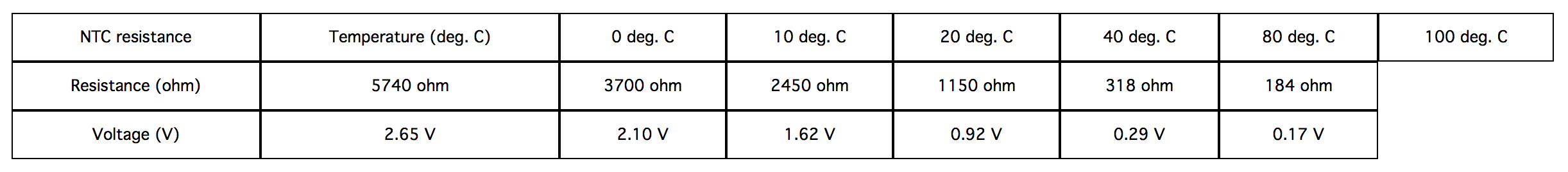

The location is the same but the connector is different between the 850s and a '99. Since the ECU is a totally different version (ME7 vs Motronic 4.X) the sensor may have different resistance characteristics as well.

1999 ECT specs from Alldata

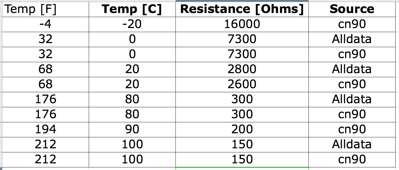

Little different from what cn90 measured on the 1998 new sensor ...data below
Most Engine Coolant Sensor works by NTC principle: as temp increases, the resistance (measure in Ohm) decreased:
For example, I measured the brand-new Volvo ECT and got these values
* -20C: 16,000 Ohms (16 kOhms)
* 0C: 7,300 Ohms
* 20C: 2,600 Ohms
* 80C: 300 Ohms
* 90C (Operating Temp): 200 Ohms
* 100C: 150 Ohms

A while back I measured FAE and SWF ECT's for a '97 855 and plotted up the values. The aftermarket FAE had failed and was reading higher across the entire temperature range:
https://www.matthewsvolvosite.com/forums ... =1&t=61920
As cn90 and abscate posted, for the 850's the specified nominal value at about 90C (194F) is about 200 Ohms. I summarized the values for the 850 in the table below.
Table of resistance values versus temperature for the ECT in the Volvo 850:
ECT resistance at various temperatures (-20C to +100C) for Volvo 850
For the '99, the resistance values are significantly lower (for example, at 20C it is supposed to read 1150 Ohms compared to 2600 Ohms for the 850's). If these values are correct, then putting an 850 ECT in a '99 S70 will cause the engine computer to think that the engine temperature is significantly colder than it really is... this will make the engine inject excessive fuel to compensate for the supposed lower temperatures.
