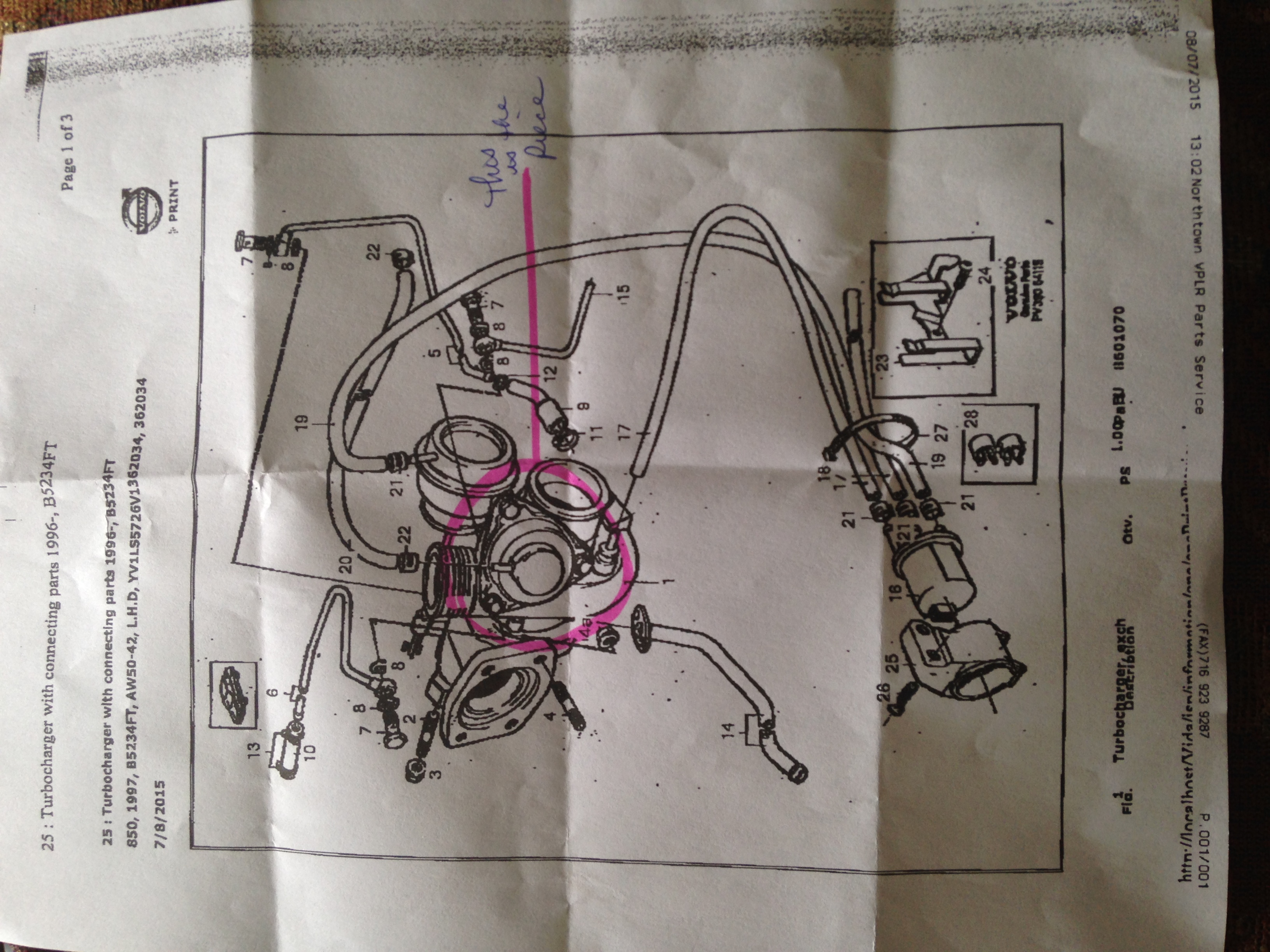

The shop I took it to over the weekend identified the source of the problem with a smoke test. The leak is coming from the following location (posted as an attachment below)
Specifically, the leak is at the triangular plate. I have heard before that it might be possible to replace the plate with a cover, because my car is an automatic rather than a manual, and that this would stop the leak. I'm not very car savvy, however, and would appreciate advice now that I've isolated which part actually has a problem.

You need a new Compressor Boost Valve ( CBV) diaphragm under that plate. You can't just remove the part that is leaking - the valve is needed to suppress boost when you close the throttle . Im not sure what would happen if you took it off, but I suspect a boosted engine not under load will not be a pretty sight nor will it run very long.

That is the compressor bypass valve, or CPV, yes there is the option for a blocking plate, but you will need to install an external valve.

I replaced mine, bought the Mitsubishi part from ebay

Actually that is a vacuum (really boost leak) at the turbo. Why would you need a turbo replacement to fix a leaking diaphragm?

If memory serves, I told you what that part was. Also, still wondering why you think your transmission (automtic/manual) would play a part in this - I think I told you to forget about that.
RussB's thread tells you everything you need to know about changing the diaphragm - why would you switch out a good turbo when this little part of it is leaking? It would be like doing an engine swap because your radiator's bad.

100 bucks, couple hours for the CBV from IPD.DigiHound wrote:Well, is installing an external valve cheaper than installing a new turbo? Because I guess that's what I'm looking at here.
Turbo 1000 bucks, 8 hours or more if/when exhaust bolts snap off.
Not a difficult one to choose...

There's no need to pay someone to fix the CBV. Get a new Mitsubishi part, like the one in RussB's thread, and then you dive into it yourself. With these cars, you can do almost everything yourself, as long as you're proficient enough to change tires, oils and fluids yourself. They're delightfully straight forward for the most part. The CBV is in a tight spot, but since you know how to change your fluids, take off the coolant hose, and it should be possible to get in there.
See this thread for some pictures of the job: https://www.matthewsvolvosite.com/forums ... =1&t=38338
