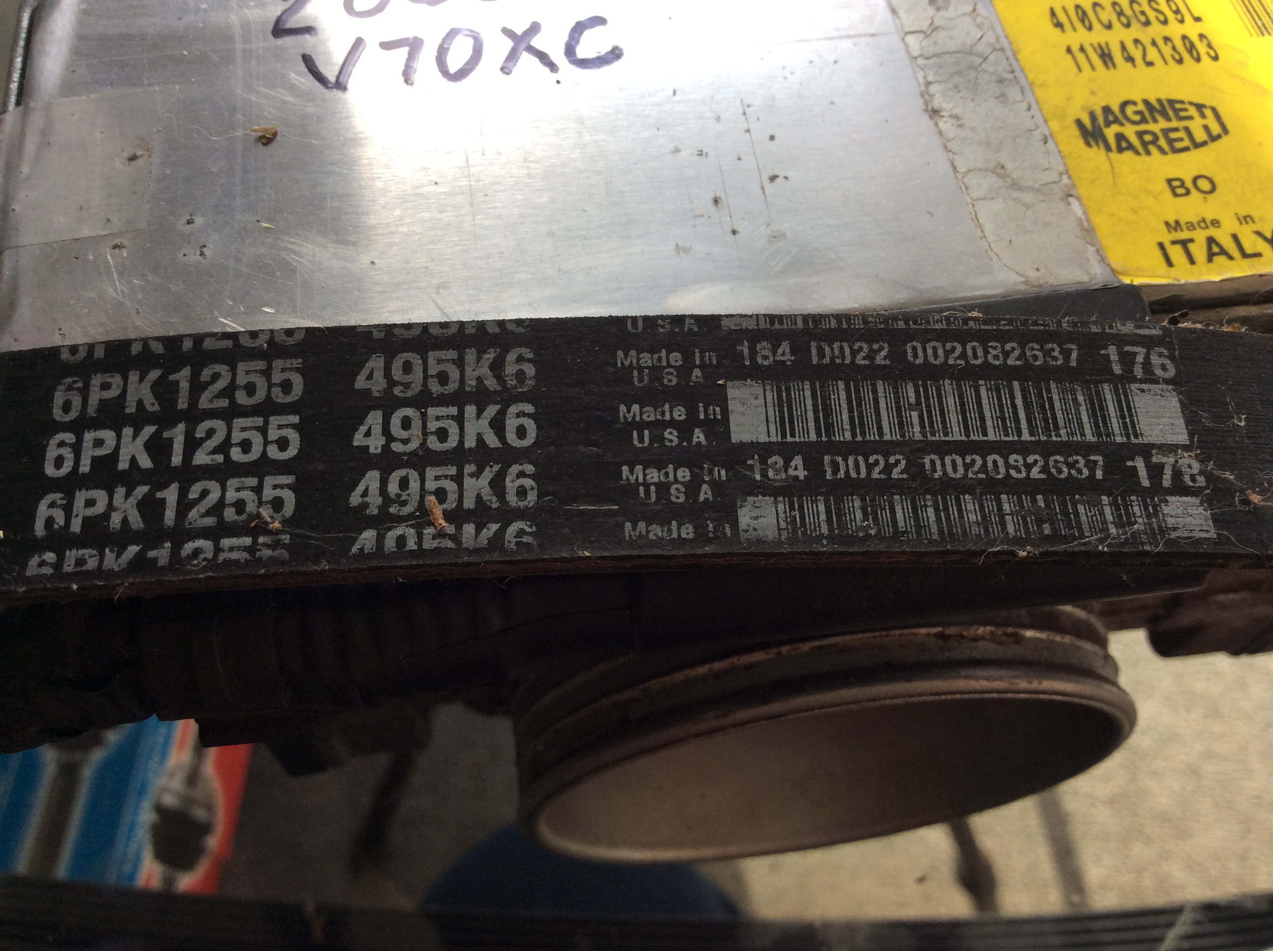

Kahl - found you!!!kahl wrote: 30 Aug 2015, 16:30 I think your A/C compressor bearings have or are failing. If you are close to Coumbus I have a belt that could be installed on your car by passing the compressor pulley.
I need some help with the bypass belt for my 1999 to put off an AC repair to spring..Ill pm you
Keywords - serpentine bypass belt
- Posts: 36149
- Been thanked: 4068 times
Merci buckets - researching this Ive found there is a chassis break on the serpentine belt
-1999
2000-on
so this is still under review.
-1999
2000-on
